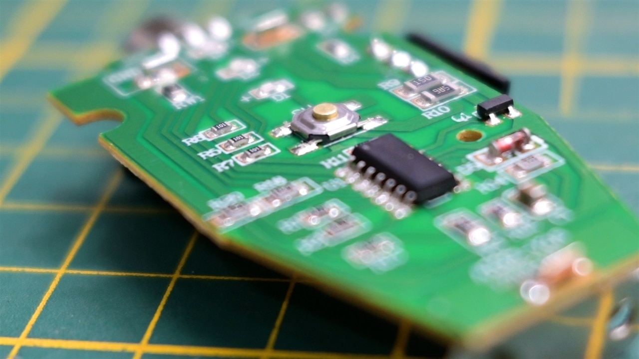

Clem starts by powering the breathalyser keyfob and observing its basic function. The device has a startup sequence, LEDs, and a clear indication of “ready” status. At first glance, it appears to contain a micro-controller under epoxy. However, after opening it, Clem finds it runs entirely on an LM339 quad comparator IC, a standard analog component often used for comparing voltages.

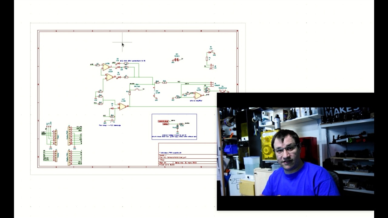

Understanding the Circuit
Tracing the single-sided PCB makes reverse engineering simpler since there are no hidden layers. By mapping connections with a multi-meter, Clem identifies a clever RC delay circuit that allows the onboard gas sensor to preheat before measurements begin. Instead of using software timers, the designers relied on analogue components like resistors, capacitors, and comparators to achieve sequencing. This makes the breathalyser both cheap and surprisingly robust.

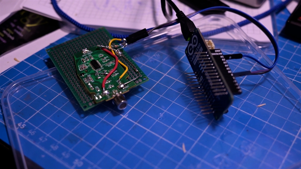

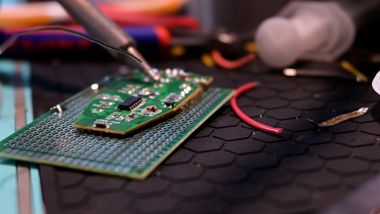

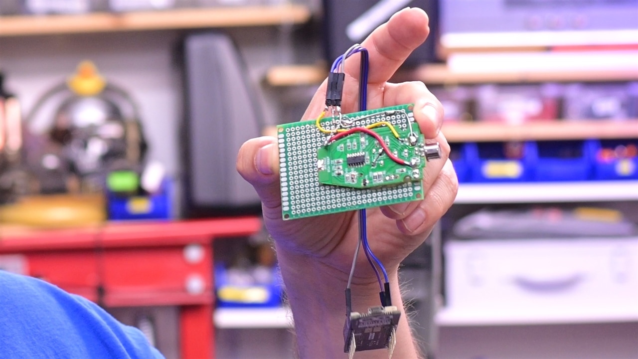

Modifying the Circuit for Arduino Use
To adapt the device for Arduino, Clem reduces unnecessary current draw. The LEDs consume most of the power, so removing them drops the current consumption to below 10mA. This makes it possible to power the circuit directly from an Arduino pin. He then adds a voltage divider to match the device’s 3V requirement, ensuring safe interfacing whether using a 3.3V micro-controller like the Arduino MKR WiFi 1010 or a 5V board like the Arduino Uno.
Interfacing and Coding
With hardware sorted, Clem connects the sensor output to an Arduino analog pin and uses another pin to enable the circuit. A short Arduino sketch logs sensor readings and averages them over one second to smooth out noise. The module can now detect alcohol vapours, whether ethanol, methanol, or isopropanol, making it useful for experiments such as controlling fans during 3D printer cleaning.
