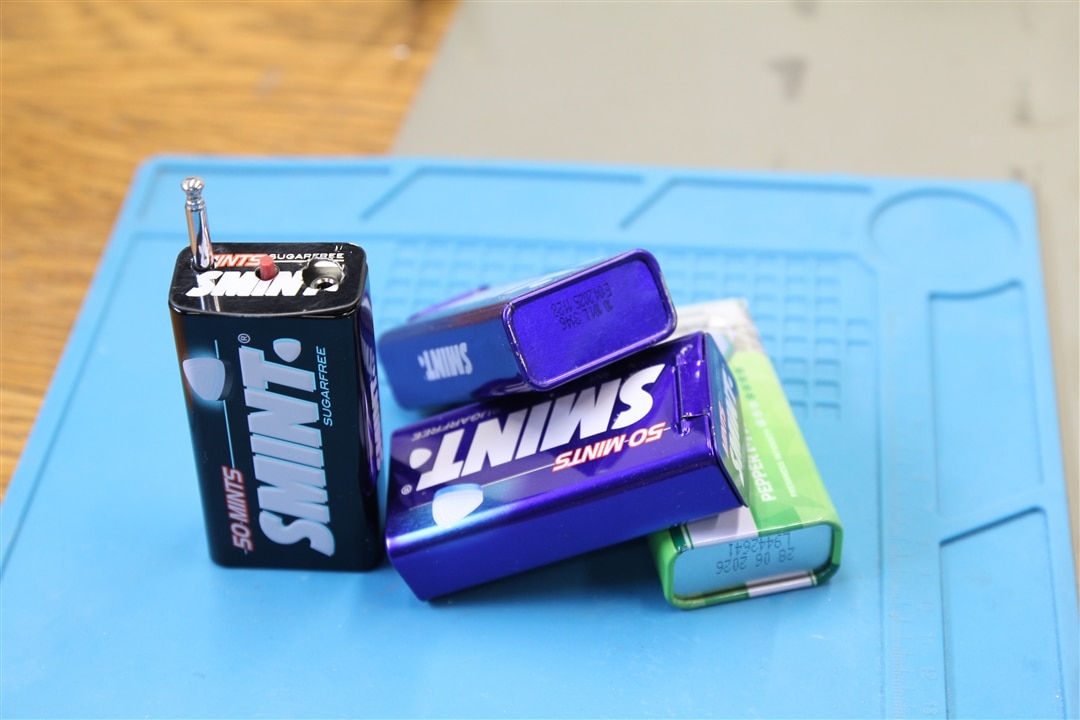

Mark set out to build a compact FM radio that fits inside a mint tin, designed specifically for emergencies. Instead of tuning across stations in a crisis, this radio is programmed to receive just one predefined frequency. With that focus, Mark wanted a reliable, portable device that can be switched on quickly when it’s needed most.
In his own words:
"Imagine you are in crisis. Maybe your town got flooded or there is a forest fire coming your way. Maybe even worse… But I hope not! Anyway, during crisis people are under a lot of stress. Wait! I’ll have to switch on the radio to listen if there are any emergency broadcasts to give us more information about the current crisis. What station was it? I don’t remember…. Help us.
Wouldn’t it save a lot of stress if you had a ready to go radio that is already tuned into the local emergency station whenever it’s switch on?" - Mark
"So in this project I’m building a small Arduino based radio that automatically tunes to a local station that you pre-defined in the Arduino code. I will be using a radio module that has all the components I need to build an FM receiver. All I need to add are some connectors and a small Arduino. Yeah,, batteries are also a necessity. An antennae can be useful but you can do without by using a tin can housing ( a mint box) that serves as antenna." - Mark

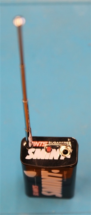

Mark created a template to drill precise holes in the mint tin for the audio jack, button, and antenna connector. The antenna can be a direct connection to the case or an external wire. Once everything was installed, the project looked neat and compact, resembling a discreet little radio gadget.
Mark’s mint tin radio shows how a practical emergency receiver can be built with an Arduino Nano, TEA5767 module, custom PCB, and coin cell batteries. The main challenges included avoiding shorts in a metal enclosure, designing a reliable power latch system, and making the housing itself serve as an antenna. The end result is a portable, single-station FM radio that’s simple to use in emergencies: switch it on and listen right away, no tuning required.
