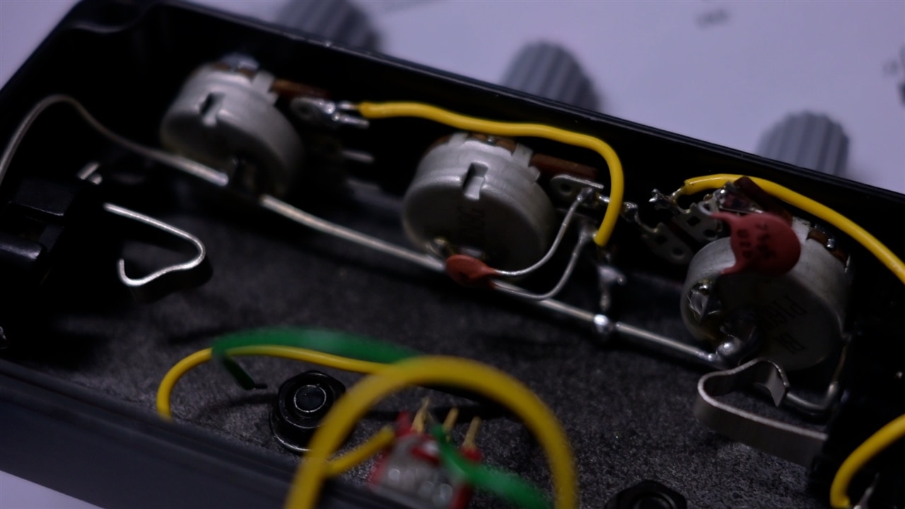

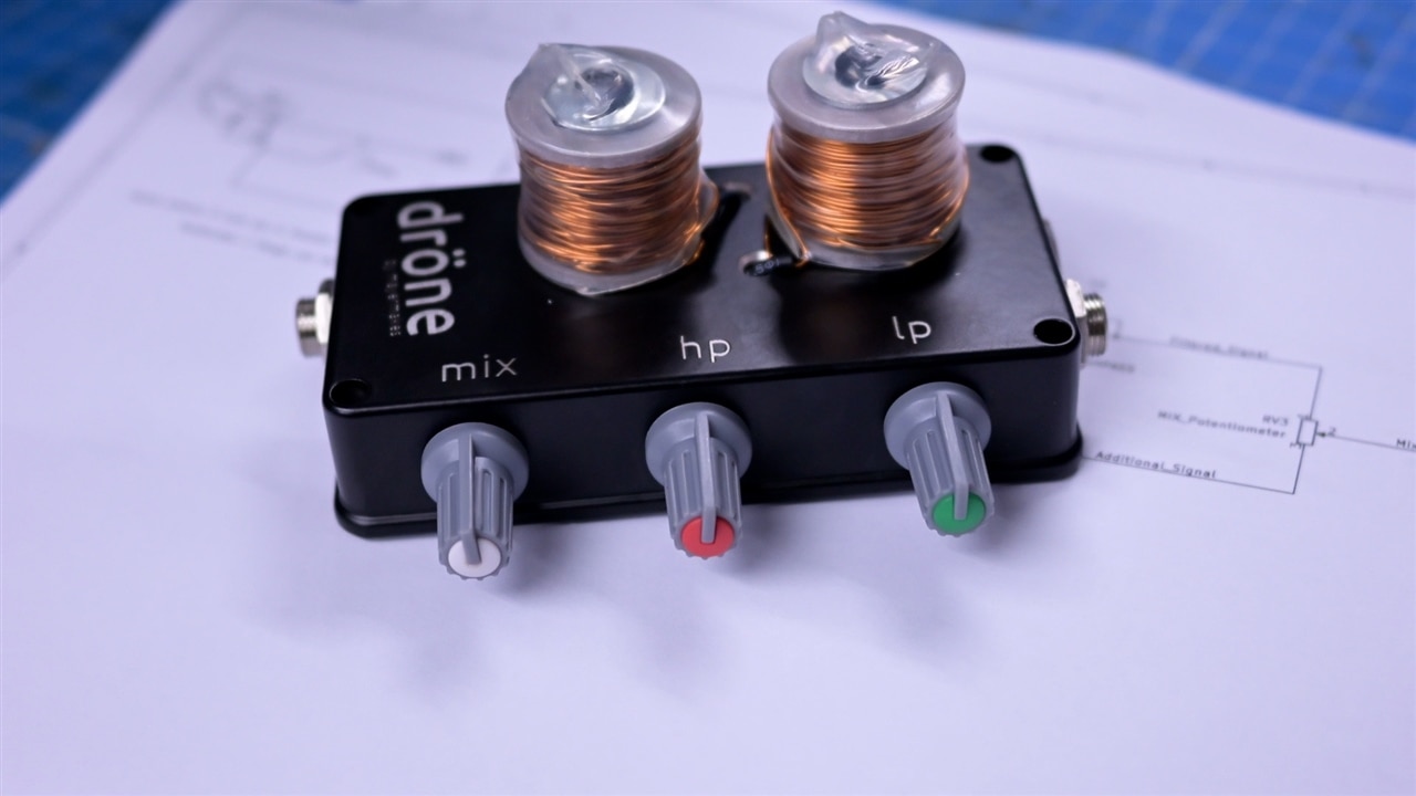

The result of this investigation was Dröne — a DIY oscillator-based synth that combines inductors, capacitors, and resistors into a tone generator influenced by the human body.

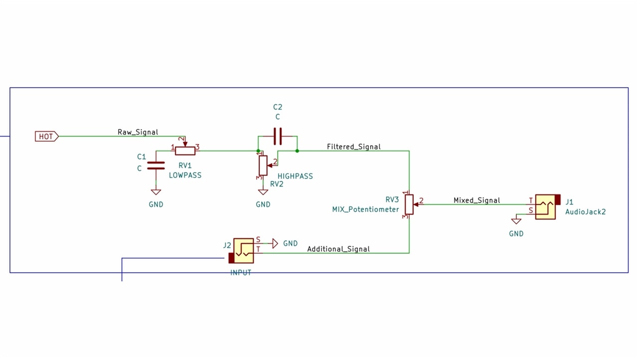

Clem designed the circuit as a hybrid LC/RC oscillator, similar in principle to those found in electric guitars or old analog tone generators. The oscillation depends partly on the performer’s capacitance to ground, meaning the sound changes when Clem touches, steps, or even moves near the circuit.
“So I can now tune the low-pass and high-pass filters of my circuit. But I also want to tune the pitch of the tone I’m producing… my body is the capacitor, so I put a potentiometer in series with myself.”
The circuit consists of three major parts:
  1. Custom inductors (coils) ,  hand-wound by Clem to act as tunable components in the oscillator.
  2. Filter network,  high-pass and low-pass filters, each controlled by a potentiometer.
  3. The player’s body,  acting as the variable capacitor in the circuit, modulating pitch and tone.

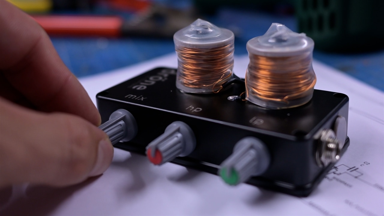

Clem also included a mix control to adjust between filtered and unfiltered signal paths, allowing him to blend tonal characteristics dynamically.
Adding Control: The Handpiece

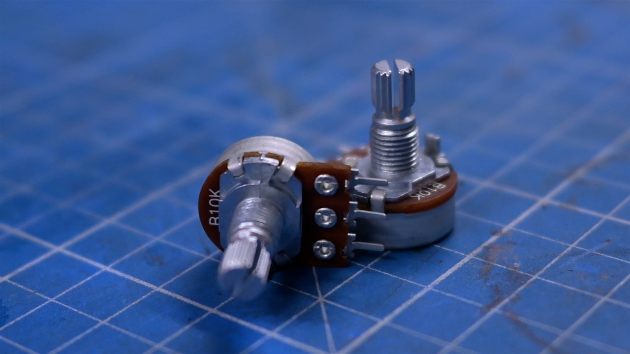

To give the player even more influence, Clem builds a “handpiece”—essentially a connector with an exposed wire attached to a ten-turn potentiometer. Why external? Because fitting such a chunky component inside the compact case would be impossible. This setup allows Clem to pre-set a pitch or frequency range, then dynamically alter the tone simply by touching the handpiece.
Even footwear matters. Touching the wire barefoot vs. in shoes? Totally different tonal character! You can even stomp rhythms into the sound—true analog body modulation.

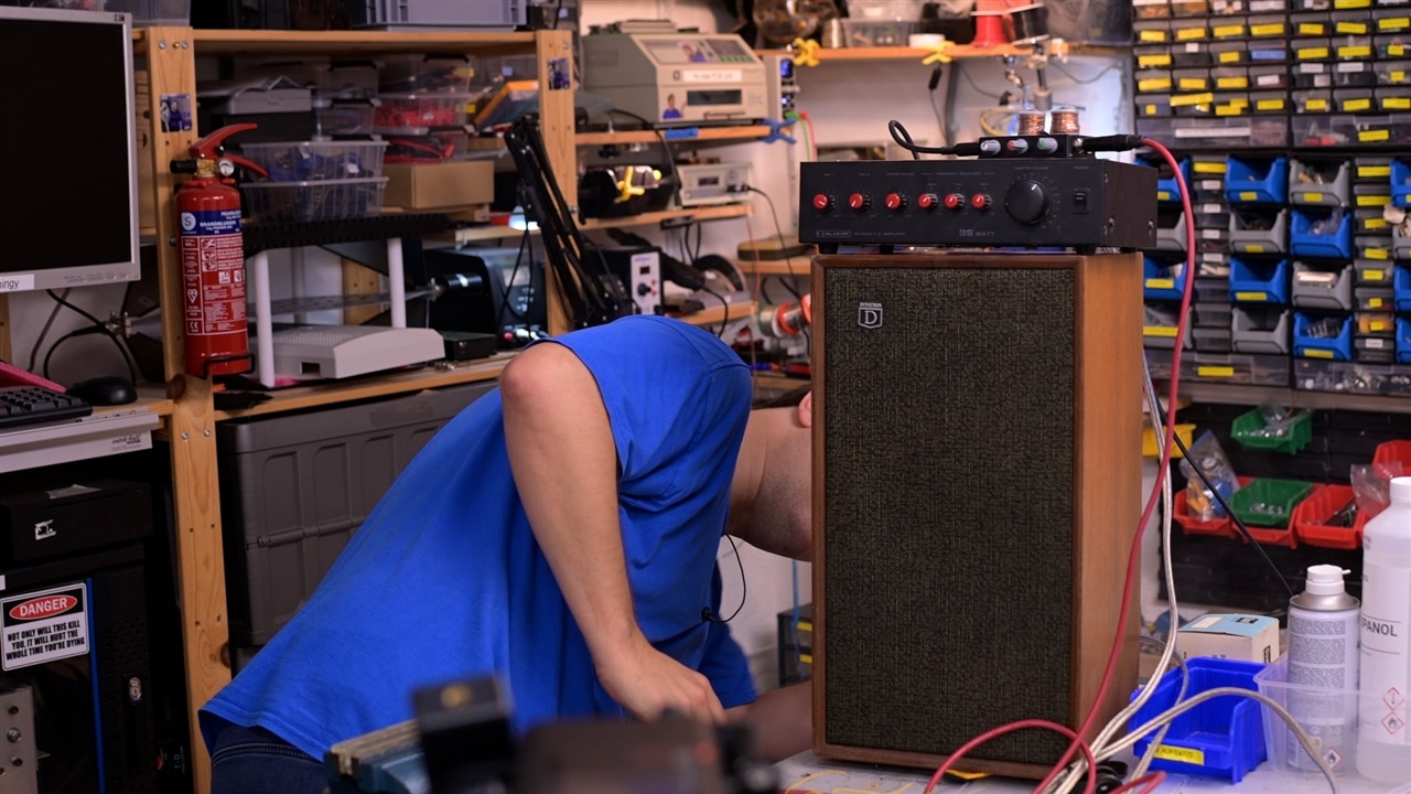

For the maiden test, Clem hooks Dröne (that’s what he calls his creation) up to a vintage 1970s turntable speaker and an in-store amplifier. The results? Thick, evolving drones with an eerie, almost vocal quality. Everything is going great—until the speaker starts smoking! Looks like the old driver couldn’t handle the sustained resonance. One brave speaker gave its life for the cause.

    Running the signals through an amplifier can be fun but as you discovered, a speaker really does not like the very low frequencies.
