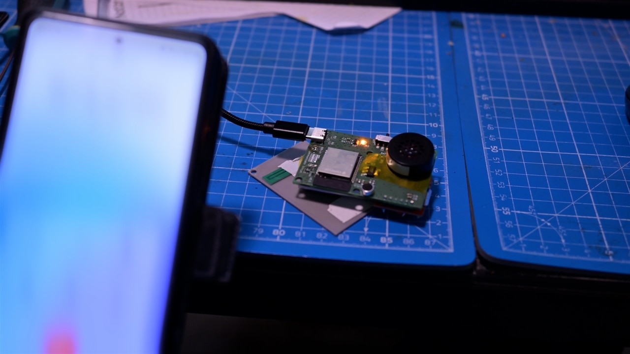

The result is a sleek, handheld communicator that looks like a prop from the universe of velour uniforms and blinking consoles, but secretly hides the workings of a real GSM phone. Beneath its compact exterior is an ESP32-S3 microcontroller paired with a SIM800L module, running as a fully functional 2G cell phone.
The Build
Clem’s goal was to design something that bridged the gap between bulky handheld communicators and the sleek, minimal badge-style devices seen later in sci-fi. More buttons, less subtlety, and a full measure of cool factor.
Under the hood, it’s surprisingly modern:
  • ESP32-S3 handles processing, Bluetooth, and communication with the GSM module.
  • SIM800L provides GSM connectivity, handling SMS, voice calls, and even data transmission.
  • 1300mAh LiPo battery keeps it powered.
  • 0.1F supercapacitor stabilizes power delivery during GSM transmit spikes.

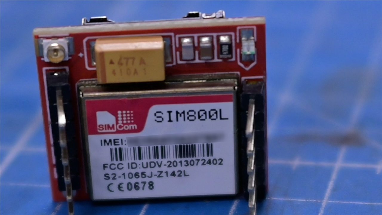

The SIM800L is notorious for drawing short, heavy bursts of current, up to 2A, when connecting to a cell tower. Clem found that even the onboard tantalum capacitor wasn’t quite enough to handle those spikes.
“There’s a tantalum capacitor on the SIM800L breakout board that should be able to provide the necessary power during these short bursts,” Clem says in the video. “But it seems it’s just a little bit not enough, so I added a super cap with 0.1 farad, yes, not microfarad, farad, and now it works a treat.”
The result: stable calls and a power section that, while compact, gives the device its own unique post-call scent. “It’s like the smell of victory,” Clem jokes. “And maybe slightly toasted electronics.”

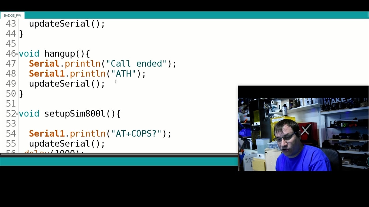

Getting an ESP32 to play nicely with a SIM800L is rarely straightforward. The two modules communicate using UART and AT commands, and their voltage levels don’t always match neatly.
“The module talks at 9600 baud,” Clem explains, “and both run on 3.3 volts, so they just about overlap. Usually, you’d use a level shifter in between, just to be safe.”
To simplify debugging, the ESP32 acts as a serial bridge, passing commands between the USB serial interface and the GSM module. Clem wrote a small Arduino function called updateSerial() to make this possible. It continuously forwards data between the USB port and the SIM800L — allowing him to manually send AT commands and monitor responses through a terminal.
This bridging design, combined with the setup() initialization routine, ensures the communicator always checks for module readiness before attempting any call operations. The firmware also manages basic call handling through simple serial commands:
  • ATA answers an incoming call
  • ATH hangs up
  • ATD<number>; places a call
These routines, along with a simple touchRead() debounce system, make up the main interaction logic inside the Arduino sketch.

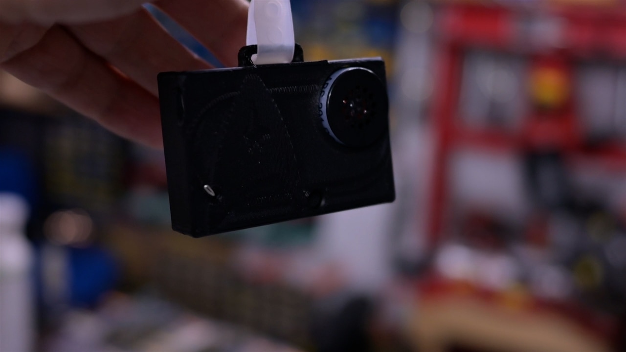

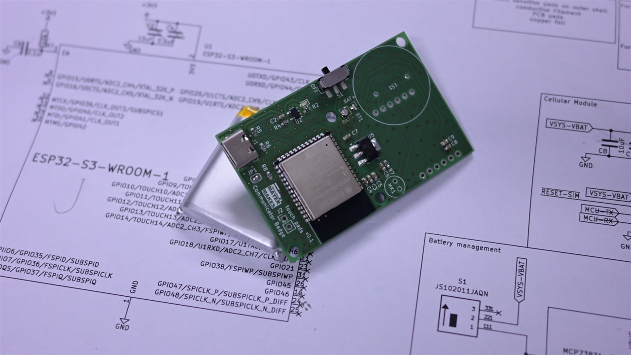

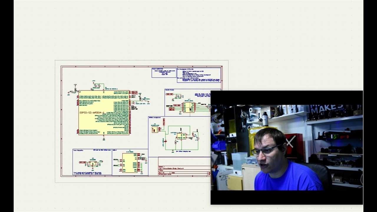

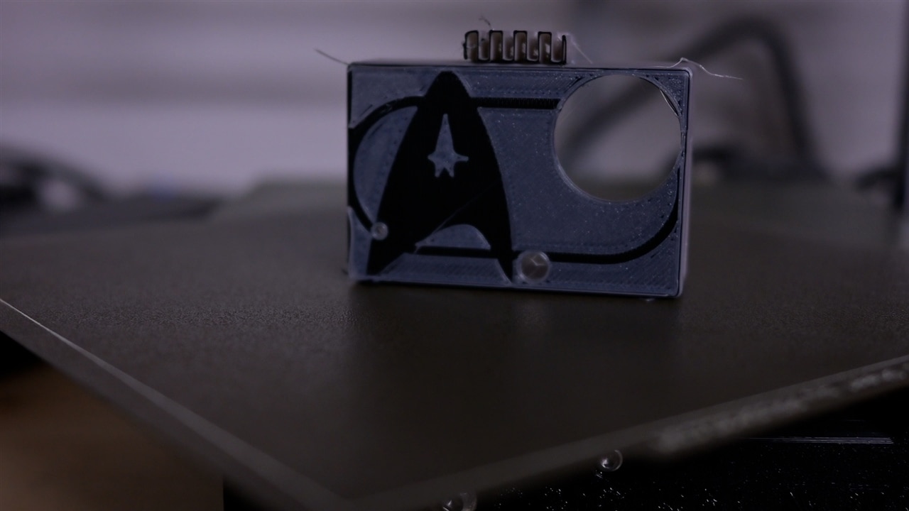

For the case, Clem used FreeCAD to model the enclosure around the PCB exported from KiCad. The housing is 3D printed using a mix of PETG for strength and conductive PLA for touch interaction. Early versions had the entire case conductive, but this caused unpredictable triggering of the touch interface.
“The touch interface was a bit too twitchy,” Clem admits. “Once the case touches me and then I move, it could trigger randomly. So I insulated the conductive parts and reprinted it, this time using PETG with only the badge logo printed in conductive filament.”
Touch interaction replaces a physical button — the entire badge surface responds to touch, making it feel like a single-button communicator. A one megaohm resistor between the touch pad and ground stabilises the signal and prevents lockups.

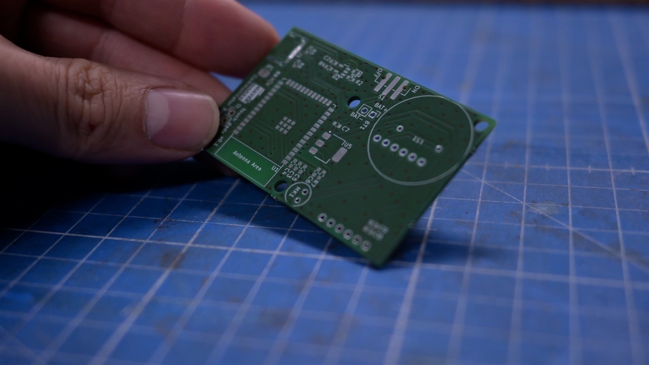

Internally, every component is arranged to minimise thickness. The ESP32-S3 and SIM800L are mounted back-to-back, sharing thermal load and space with the LiPo battery and USB-C port. The final assembly measures roughly 8–10 mm thick, depending on the speaker placement. Clem even re-used a simple badge clip from a trade show to complete the look.
“Now everything’s in here — the speaker, microphone, USB-C port,” Clem says, showing the final assembly. “And this is a little badge holder I got from a trade show. Now I can just clip it on my uniform and be ready for new adventures out in space.”
