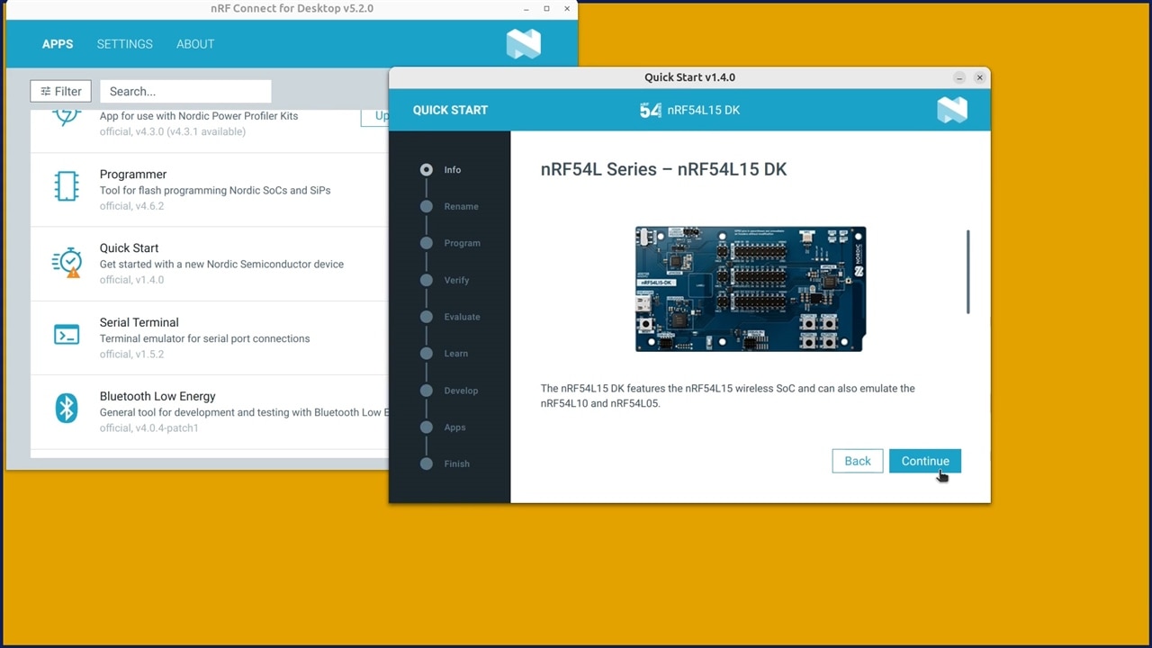

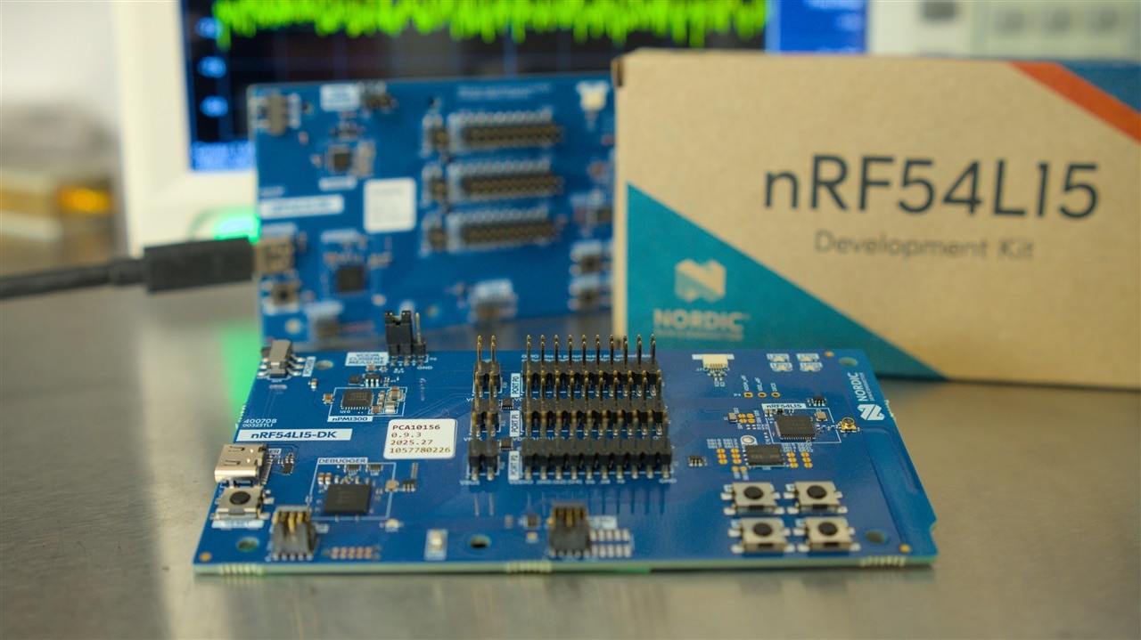

The Hardware: Why Pat Reached for the nRF54L15
Nordic’s nRF54L15 DK is the backbone of Pat’s entire investigation. He’s used Nordic chips for years and notes that the new 54-series devices are “an extension of the 52… a plus-plus version”, with a faster M33 core, better efficiency, and a RISC-V coprocessor for timing-critical jobs. That coprocessor caught his attention: “an independent little machine to handle time-critical tasks… without requiring anything from the main processor.” For something like channel sounding, full of tight timing windows, this matters.
But what really triggered the deep dive was Bluetooth 6.0’s new precise ranging capability, fully supported in hardware on this device. In his words: “what really got my juices flowing is that the 54L supports one of Bluetooth’s coolest new features: channel sounding.”
Pat also highlighted a couple of practical points makers will appreciate. First, Nordic made the DK simple. Instead of jumper forests, much of the configuration happens through nRF Connect Desktop, which keeps the board design clean. But he was honest about the tradeoff: “It turns things like the VDD into mystery meat… there’s no way to tell what it’s set to by looking at the board.” Second, the chip tolerates a broad voltage range (1.8–3.3 V), which let him power a reflector module with AA batteries during field tests.

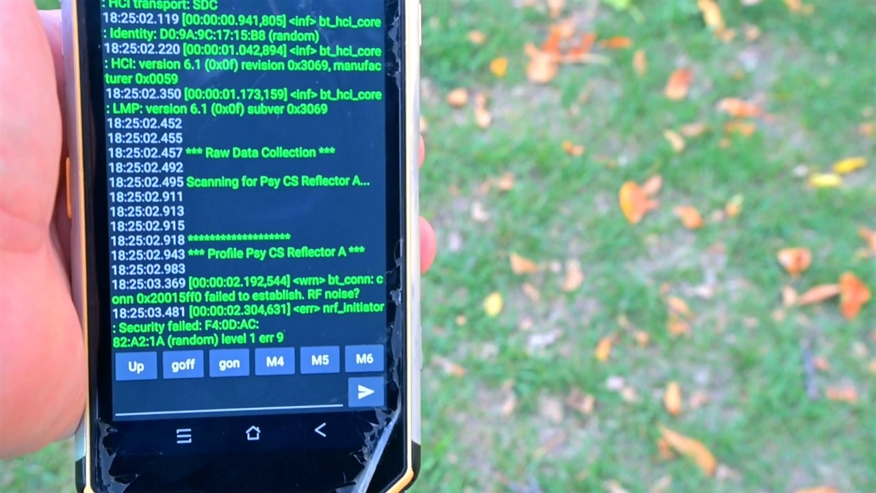

Testing in the Real World: Clotheslines, Parks, and a Lot of Data
After validating the radio behaviour and the firmware, Pat moved on to the fun part: range testing. Indoors, things were too chaotic—“tight and cluttered, with signals bouncing everywhere.” So he set up an outdoor test track.
Free-Space-Like Setup
To get as close to free-space propagation as possible, Pat needed to physically isolate the reflector. That’s where the clothesline came in. With the reflector suspended in mid-air, powered by AA batteries, and logging via his phone, he could walk away with the initiator DK and collect distances at various known positions.
He first tried rough distances of 5 m, 10 m, and ~50 m. Then he created a more carefully spaced flag line in a park, planting markers every 5 meters out to around 45 m. Even then, the handheld laser ranger wasn’t precise outdoors, so the distances were approximate.
What He Found
The data was revealing:
  • RTT was the most consistent and had “less than 1% failure rate” at mid-range.
  • Phase slope tended to over-estimate distance by 20–30%.
  • Inverse FFT (another phase-based estimate) was the most sensitive to disturbances.
  • Overall jitter in any method was 60–120 cm, even when the mean distance was right.
Pat noted that channel sounding absolutely works, but the hopes of “20 cm precision” using single PCB antennas aren’t realistic in this configuration. Adding antenna diversity, polarisation diversity, or improved RF front-ends would be the next step to tighten up accuracy.

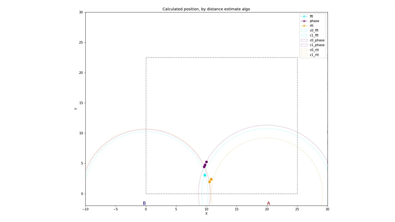

Trying Positioning with Two Reflectors
Distance is good, but Pat pushed further, could he triangulate position?
With two reflectors set 20 m apart, and the initiator rotating through connect → measure → disconnect cycles, he tried to compute intersection regions of the distance bands. Because “jiggle in the estimates” frequently made the two circles not intersect, he allowed ±50 cm tolerance to turn each circle into a band.
Getting both reflectors to sound simultaneously didn’t work yet, he suspects the sounding sequences interfere with each other, but by brute forcing sequential measurements he managed to get usable data. It wasn’t precise positioning, but it demonstrated the mechanics for future refinement.

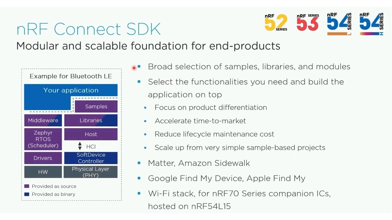

Working with the Nordic Ecosystem
Pat spent time discussing what it’s like to actually develop with the nRF54 family:
  • Zephyr RTOS: Powerful, open, and flexible, but a steep learning curve. “If you're new to it… it can feel like trying to sew with a sledgehammer.”
  • SoftDevice Controller: A necessary but opaque binary blob. Sometimes it produces cryptic errors with no source to inspect.
  • Developer Support: Nordic’s DevZone is invaluable, but replies take time.
  • Documentation: Genuinely excellent, and the Nordic Developer Academy has complete courses.
His message to makers is that Nordic gives you the tools, but you’ll need to get comfortable with Zephyr, device tree overlays, and a fair bit of abstraction.
