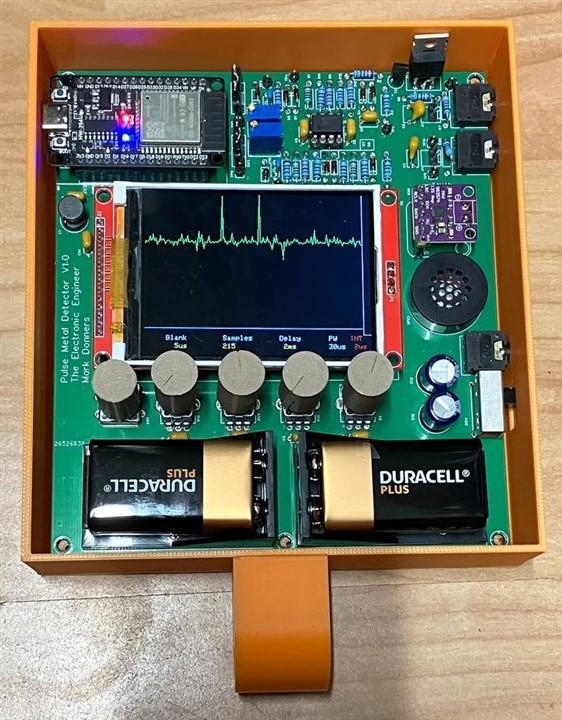

The detector is built around an ESP32, which handles pulse generation, signal sampling, user input, display output, and audio feedback. Around that core, the system includes:
  • A custom analog front end for driving the coil and conditioning the received signal
  • A graphic display for visual feedback
  • An audio board with speaker or headphone output
  • Adjustable controls for tuning detection behaviour
  • Interchangeable coils
Early in the video, Mark summarises the concept simply:
“This one uses an ESP32 and a graphic display, and it has a nice sound for you to detect metal.”
User Interface and Controls
The detector is designed to be adjusted while in use. The front panel includes four potentiometers, a touch button, and a power switch. These inputs allow the user to change detection parameters without modifying the firmware.
Using the controls, you can adjust:
  • Blanking time, which sets how long the system waits after a pulse before listening
  • The number of samples taken during each measurement
  • The delay between measurement sweeps
  • The sampling interval
Mark encourages users to actively adjust these settings while testing:
“You can just mess around with those parameters and see how that works out for you.”

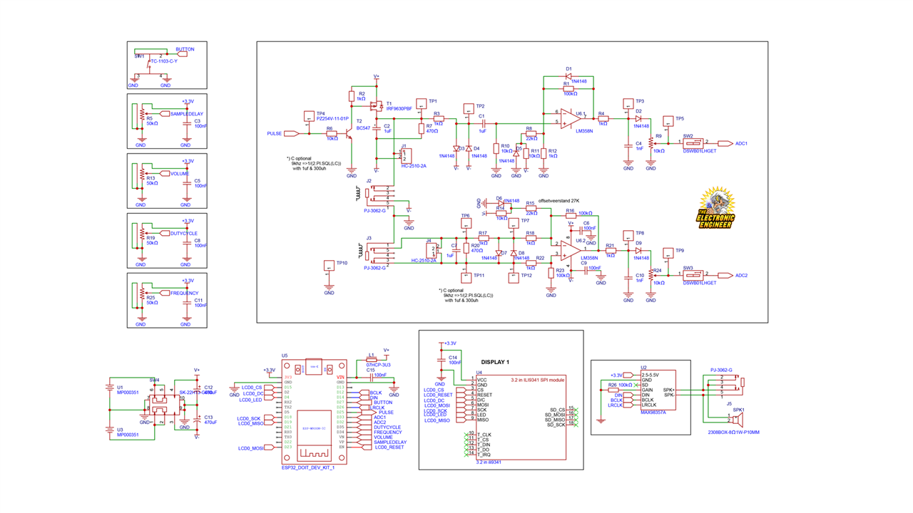

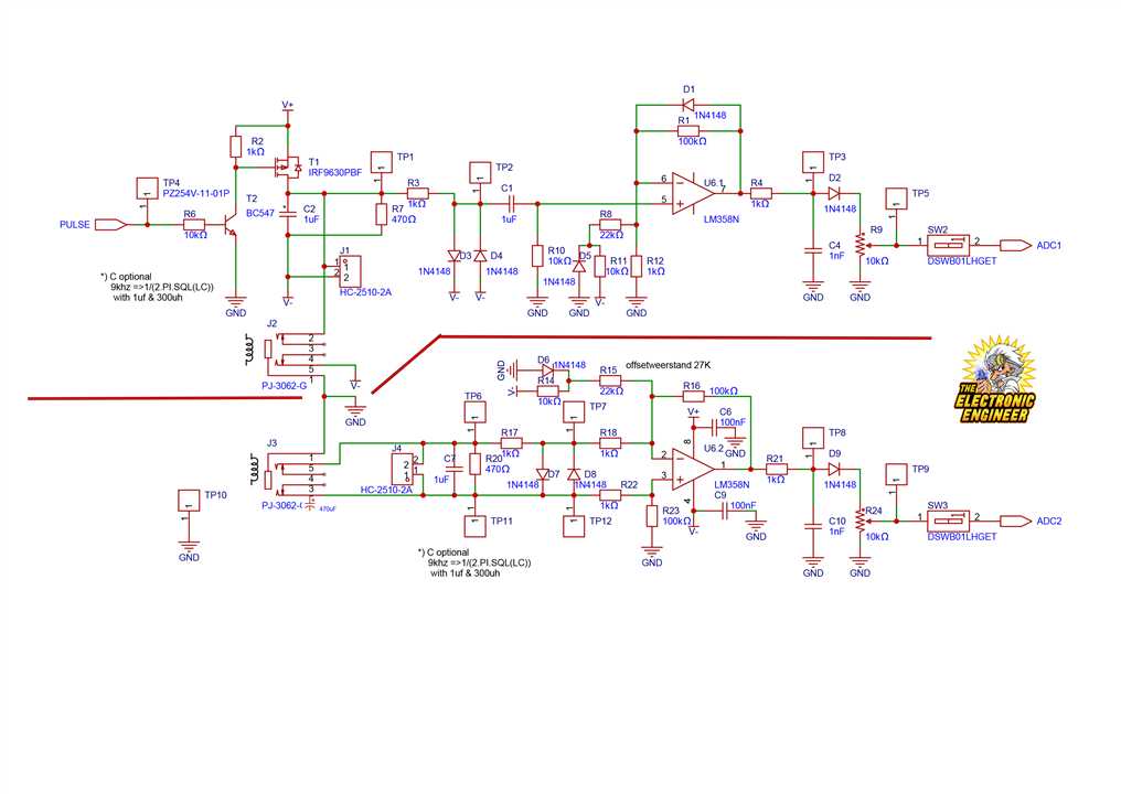

Analogue Front-End Circuitry
The analogue circuitry is divided into two nearly identical sections.
Transmit and Receive Channel
The upper section of the circuit drives the transmit coil. A short pulse generated by the ESP32 switches a MOSFET, boosting the signal to the full supply voltage, around 18 V peak. This produces a strong magnetic pulse in the coil.
Once the pulse ends, the coil begins to ring due to its inductance. This signal is carefully processed:
  • Diodes clip the high-energy pulse to protect the analogue circuitry
  • Only the low-level ringing signal is passed through
  • The signal is amplified, rectified, and filtered
  • The processed voltage is fed into the ESP32’s ADC
Receive-Only Channel
The lower section of the circuit uses the same signal conditioning chain but does not generate pulses. It continuously listens to a connected coil.
Mark explains why both circuits were included:
“At the time that I designed this, I had no idea yet if I’m going to use both the circuits or just one only. So I left both in there.”
This makes the design flexible for experimenting with different coil arrangements.

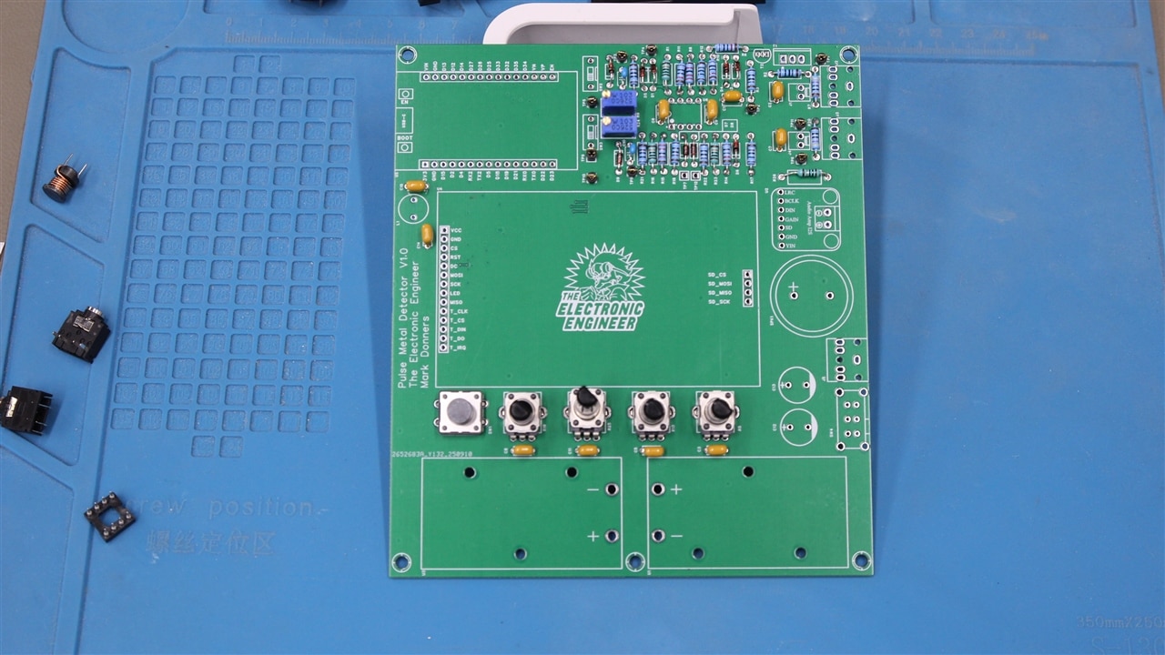

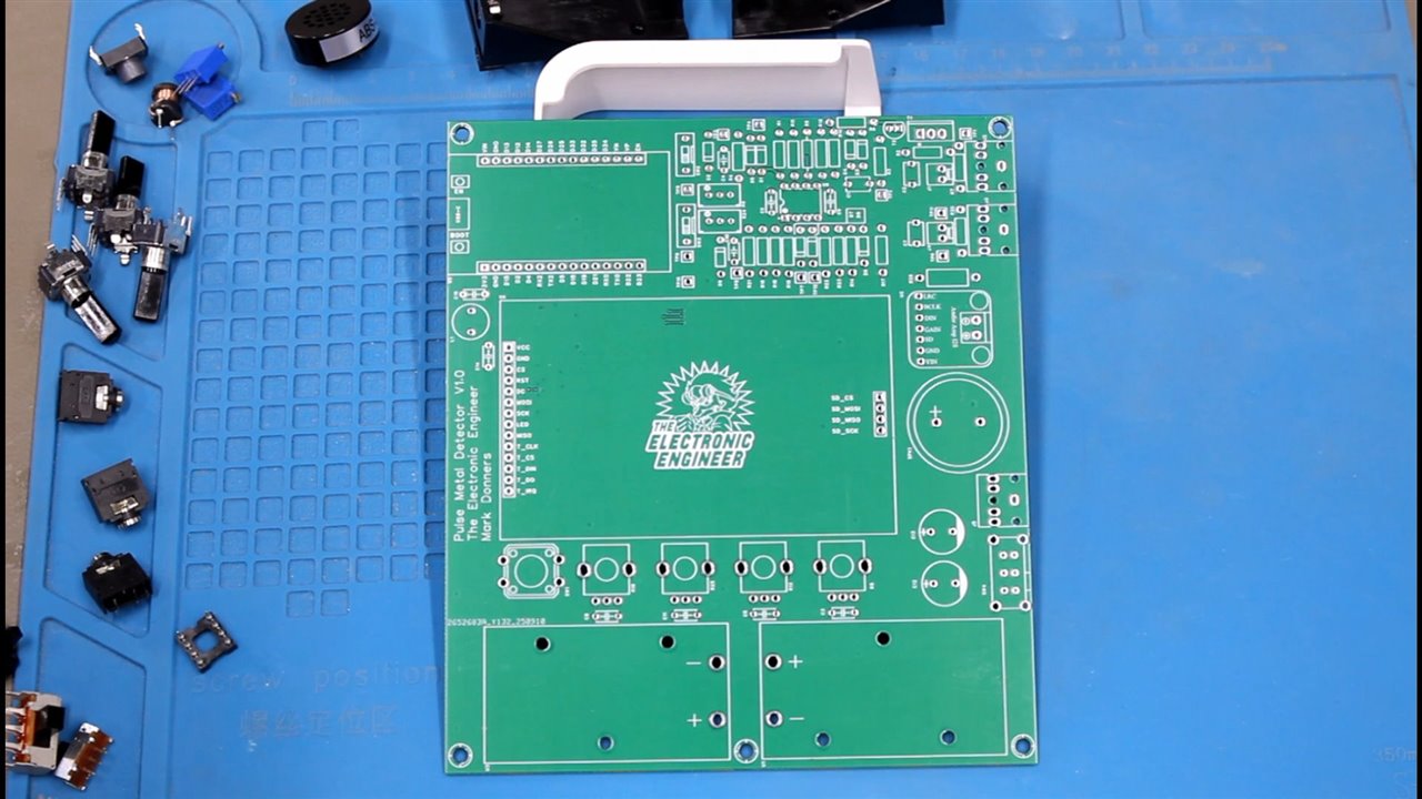

PCB Assembly Approach
Assembly follows a straightforward and reliable process. Mark recommends starting with low-profile components such as resistors, then moving on to capacitors and connectors, and finally installing sensitive parts like the ESP32, display, and audio board.
Throughout the process, careful inspection is important:
“Make sure to inspect the board closely to see that you didn’t make any short circuits when soldering.”

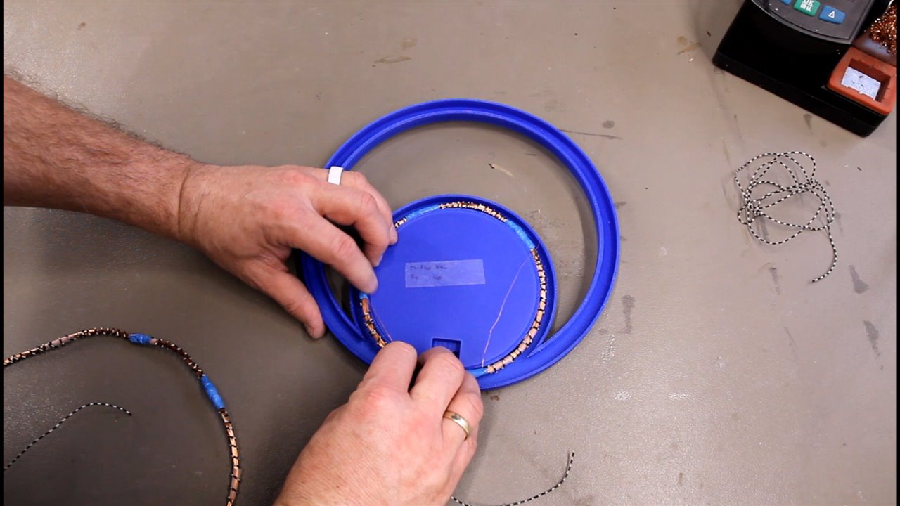

Coil Design and Winding
The coils are central to detector performance, so Mark chose to wind them by hand.
Small Coil
  • Wound on a 125 mm sewer pipe cap
  • Approximately 120 turns of copper wire
Large Coil
  • Wound using a custom 3D-printed mold
  • Includes a brim to keep the wire in place
  • Also approximately 120 turns
The process requires patience, especially when keeping the windings even:
“It’s kind of tricky, but with a little practice, you can get the hang of it.”

    "On the published PCB photo R7 and R17 near the coil connectors appear to be disconnected on one side, while the schematic shows them connected. Is this an intentional modification? If so, what is the reason?"
