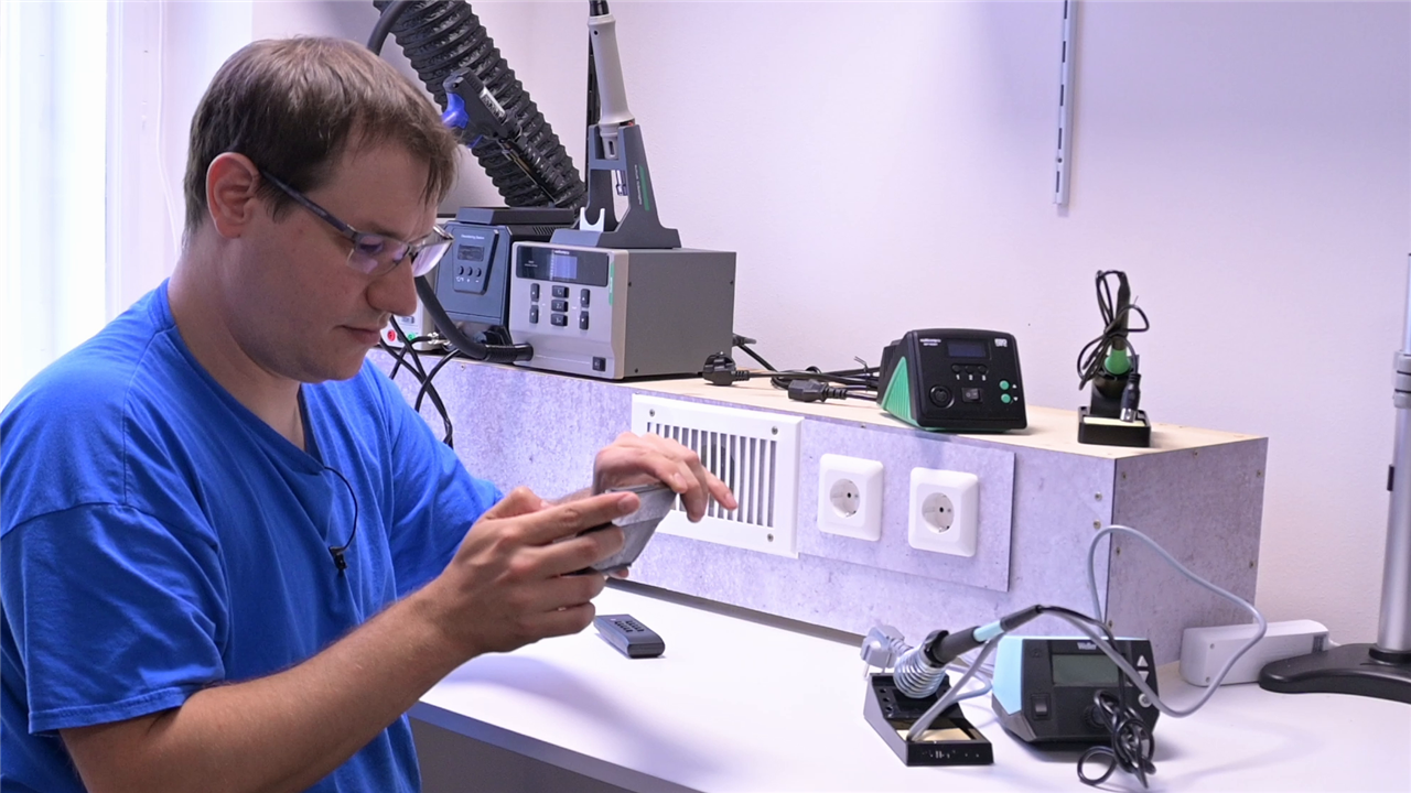

Clem Builds a Practical, Professional-Grade Electronics Workbench
In this project, Clem sets out to solve a problem familiar to many engineers and advanced makers: outgrowing an improvised workspace. After years of working around limitations in tools, ergonomics, and layout, he designs and equips a new electronics workbench that reflects how he actually works day to day. Rather than chasing brand prestige or maximum specifications, Clem focuses on reliability, workflow efficiency, and what he repeatedly refers to as “bang for the buck” .
This workbench is not presented as a luxury lab or a niche setup for one specific task. Clem explicitly frames it as something that “represents the type of electronics workbench you would have if you are an advanced maker” and also as “an entry level professional electronics workbench” for early-career engineers and hardware-focused startup founders .
The Workbench Itself: Ergonomics First
At the centre of the build is a hand-crank adjustable bench that allows Clem to switch between sitting and standing. Ergonomics is not treated as an afterthought. Clem explains that being able to move the bench up and down is essential for comfort during long debugging sessions, noting that the desk can travel far enough to support proper standing work without re-configuring the rest of the setup .
Mounted above the bench is a homemade fume extraction system, designed to pull solder fumes directly away from the work surface and out through a filter. Both the extractor and the overhead lighting are controlled via remote outlets. As Clem puts it, this avoids “fumbling with switches mid-project” and reduces exposure to fumes during extended soldering work .
The layout is deliberate. Clem arranges tools from left to right based on how frequently he uses them and openly notes that he is left-handed, which influences the flow. Items used constantly live within arm’s reach, while less frequently used equipment is stored on shelves just above the bench.

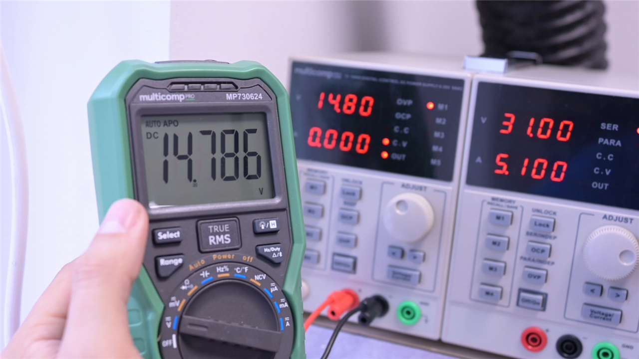

The first major instrument on the bench is a dual-output lab power supply from multicomp Pro. Clem’s requirements are specific: independently controllable channels, the option to daisy-chain outputs, and, most importantly, low ripple. “A power supply has to have as low ripple as possible,” he says, adding that there is a price point beyond which “you wouldn’t get that much more performance” .
He describes the unit as heavy, which he takes as a positive indicator for power supplies, and highlights that it hits the performance-to-cost balance he was looking for. Even small details matter here. The included one-meter test leads are usable, but Clem notes they may be a bit short and that he plans to evaluate them before committing to more.

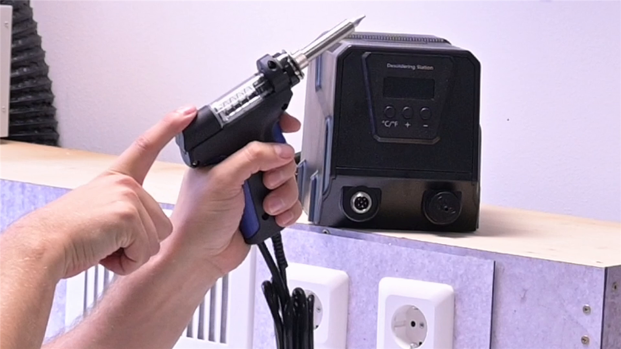

De-soldering is one of the areas where Clem is most blunt about past compromises. His previous budget de-soldering iron is described as “pretty much useless garbage,” frequently clogging and lacking the power needed to remove components reliably .
The replacement is a dedicated de-soldering station that includes multiple tips, cleaning needles, filters, and a proper holder. Clem points out practical improvements rather than headline specs: a better trigger, easier maintenance, and enough thermal performance to make de-soldering a routine task instead of something to avoid. This upgrade reflects a broader theme of the project: removing friction from common debugging workflows.

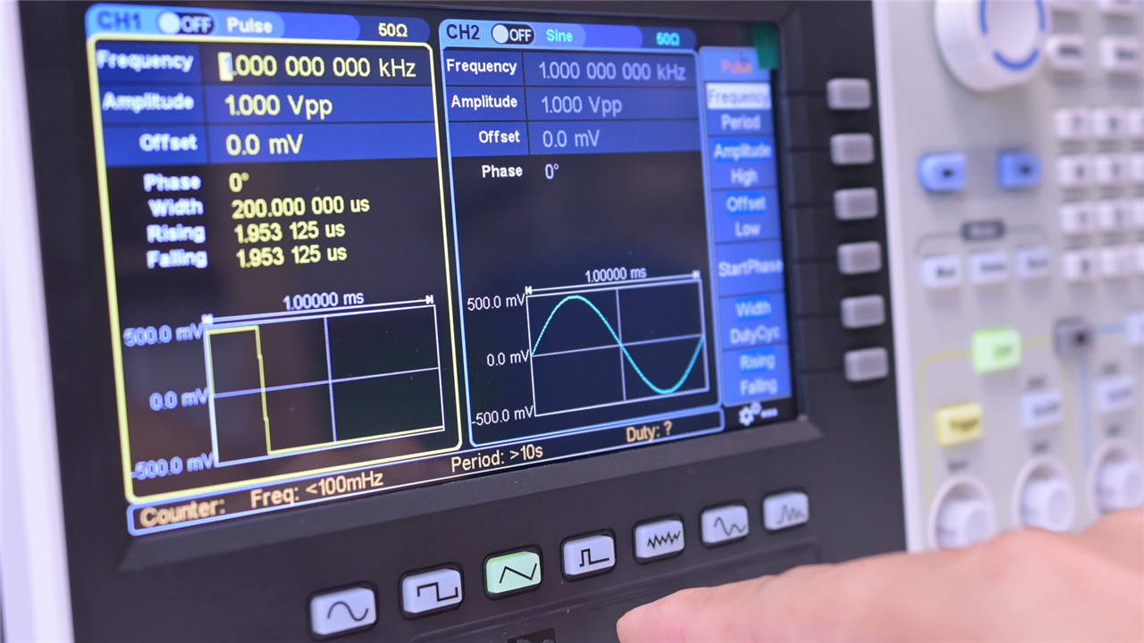

Signal generation is where Clem allows himself a more significant upgrade. His earlier generators were limited to low frequencies and basic waveforms, which he describes as insufficient for real development work. The new dual-channel arbitrary waveform generator supports frequencies up to 100 MHz and offers advanced modes such as sweep, burst, PWM-like signals, and user-defined waveforms.
“In most cases, I don’t need exactly those,” he says of simple sine or square waves. “I need like a real PWM signal where I can alter the duty cycle or… specific noises” .
Clem is clear that this is not essential for beginners, but for his work it removes a recurring limitation. Because it is not used constantly, the generator lives on a shelf above the bench and is brought down only when needed.

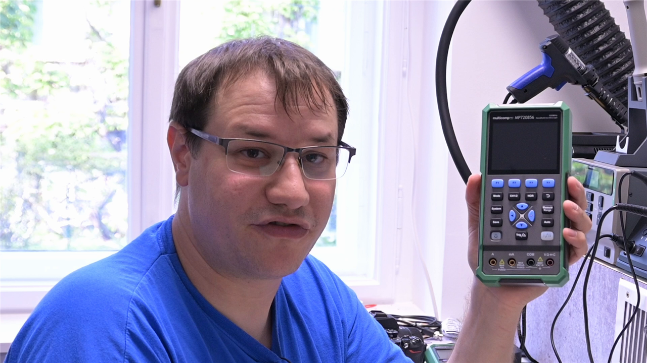

While Clem does own a full bench oscilloscope, it lives on a separate development desk near his computer. For this electronics bench, he opts for a handheld, battery-powered oscilloscope with 100 MHz bandwidth and built-in multimeter functionality.
This choice is driven by experience. Clem recalls having to debug large systems in the field, including appliances, where bringing a full bench scope and even finding power was impractical. “So now I just whip out this thing, connect it up, see the signal and go ‘oh yeah that’s broken,’” he explains .
The portable scope allows him to move seamlessly between benches and on-site troubleshooting without sacrificing measurement capability.

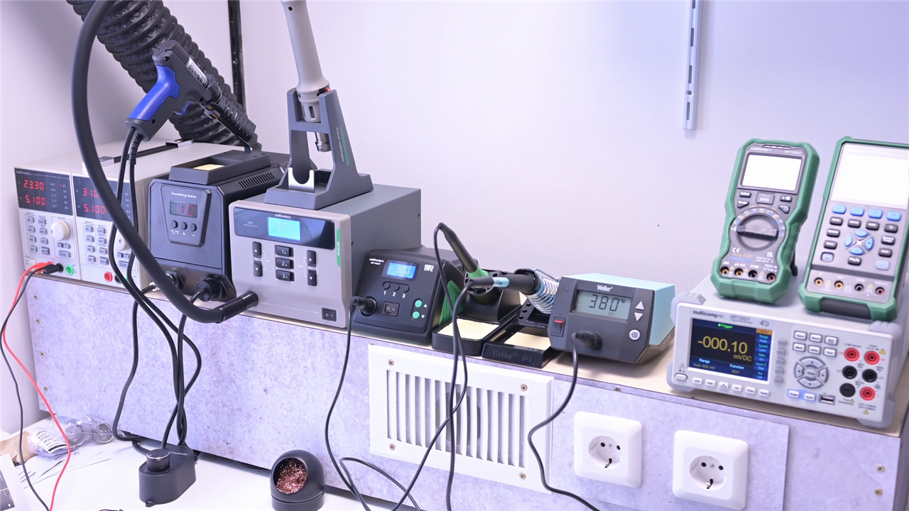

A Bench Built Around Real Use
By the end of the build, Clem has assembled a workbench that reflects years of accumulated lessons rather than theoretical ideals. There are no ultra-specialized tools here, by design. “Specialized work needs specialized workbenches,” Clem notes, and this setup is meant to cover the majority of electronics development tasks reliably and efficiently .
The result is a clear reference point for advanced makers and engineers looking to invest in their own workspace. It prioritizes ergonomics, repeatable workflows, serviceability, and tools that remove friction from daily work rather than add complexity.
