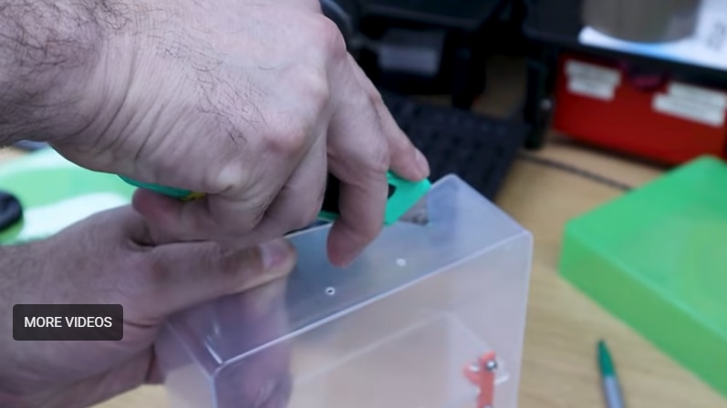

Early in the project, Lorraine breaks the system down into its core components: microphone, speaker, screen, button, servo, and a Raspberry Pi as the controller. This early sketching phase is important, because it reveals one of the recurring themes of the build: reducing complexity by choosing parts that can serve multiple roles.
The decision to use a Seeed ReSpeaker HAT is a good example. It combines microphone input, speaker output, onboard buttons, and LEDs in a single board, reducing wiring and setup effort. Lorraine notes that it “looks perfect actually for what I need,” largely because it avoids juggling separate audio components. This choice also shapes later software decisions, including how audio devices are discovered and selected in code.
From a physical design perspective, the box itself is as important as the electronics. The linguistics team’s requirement that the box be transparent drives several later decisions: how the Raspberry Pi is mounted, how the servo-driven locking mechanism is designed, and how the prize is separated from the electronics. Lorraine repeatedly returns to the idea that children should be able to see how the system works, not just interact with it.
Hardware Decisions and Constraints
As the project moves from concept to assembly, Lorraine reflects on practical constraints. Acrylic thickness, cutting methods, and durability under repeated handling all influence the design. A key concern is robustness: the box must survive being shaken, poked, and tested by children.
This leads to a change in the original locking idea. A freely rotating disc would be visually clear, but too easy to defeat physically. Lorraine recognises this risk: if the plastic is flexible, “you can just stick your hand in it and grab the sweet”. The revised design uses a servo-driven hook that physically blocks the lid, combined with a partial hinge so that only the prize compartment opens. This separation of electronics and reward is both a safety measure and a teaching tool.
Button placement and power switching are also considered carefully. The system needs to reset quickly between users, and adults need a way to intervene without dismantling the box. These considerations feed directly into the software flow later on.

    I noticed that when you made the initial passphrase recording you had the top cover open, so there is nothing obstructing the microphones on the ReSpeaker hat. However when you are trying to unlock the…

    "ask an adult for help when using sharp knives"  Slight smile

    Perhaps add a microswitch to the lid so that the servo doesn't attempt to lock the box until after the lid is closed.
    Can also be used as a tamper detect just in case anyone turns up with that hammer.
