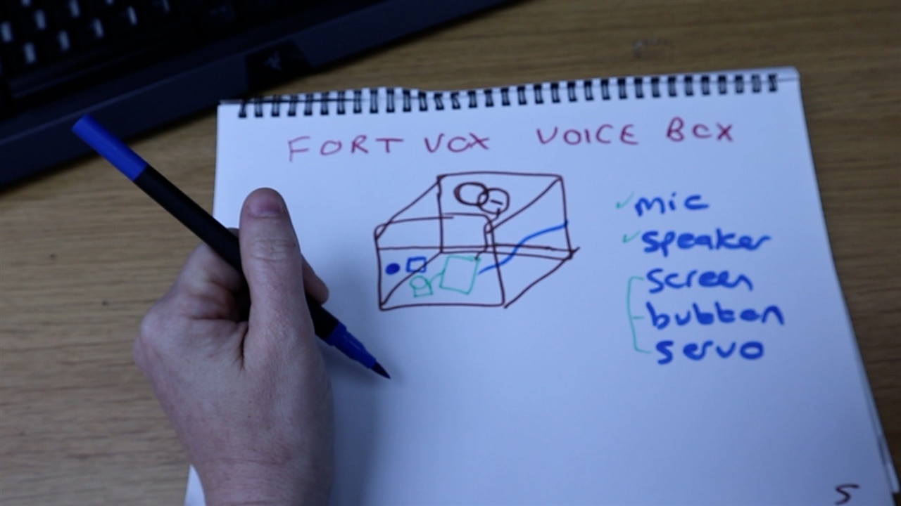

The Fort Vox Voice Box is a practical exploration of voice biometrics framed as a hands-on outreach project. Lorraine’s aim is clear from the outset: build a physical box that can only be unlocked using a spoken voice password, and use it as a tool for linguistics and computing outreach with children. The result sits deliberately at the intersection of hardware hacking, applied machine learning, and human behaviour.
Lorraine introduces the concept succinctly: a locked box, a treat inside, and a spoken phrase as the key. As she puts it, it is “a box that’s locked with a password but it’s a voice password,” designed so children can actively try to defeat it during outreach events. The emphasis is not on security in the commercial sense, but on transparency and learning. The electronics are intentionally visible, and the mechanics are simple enough to provoke curiosity rather than mystique.
Concept and System Breakdown

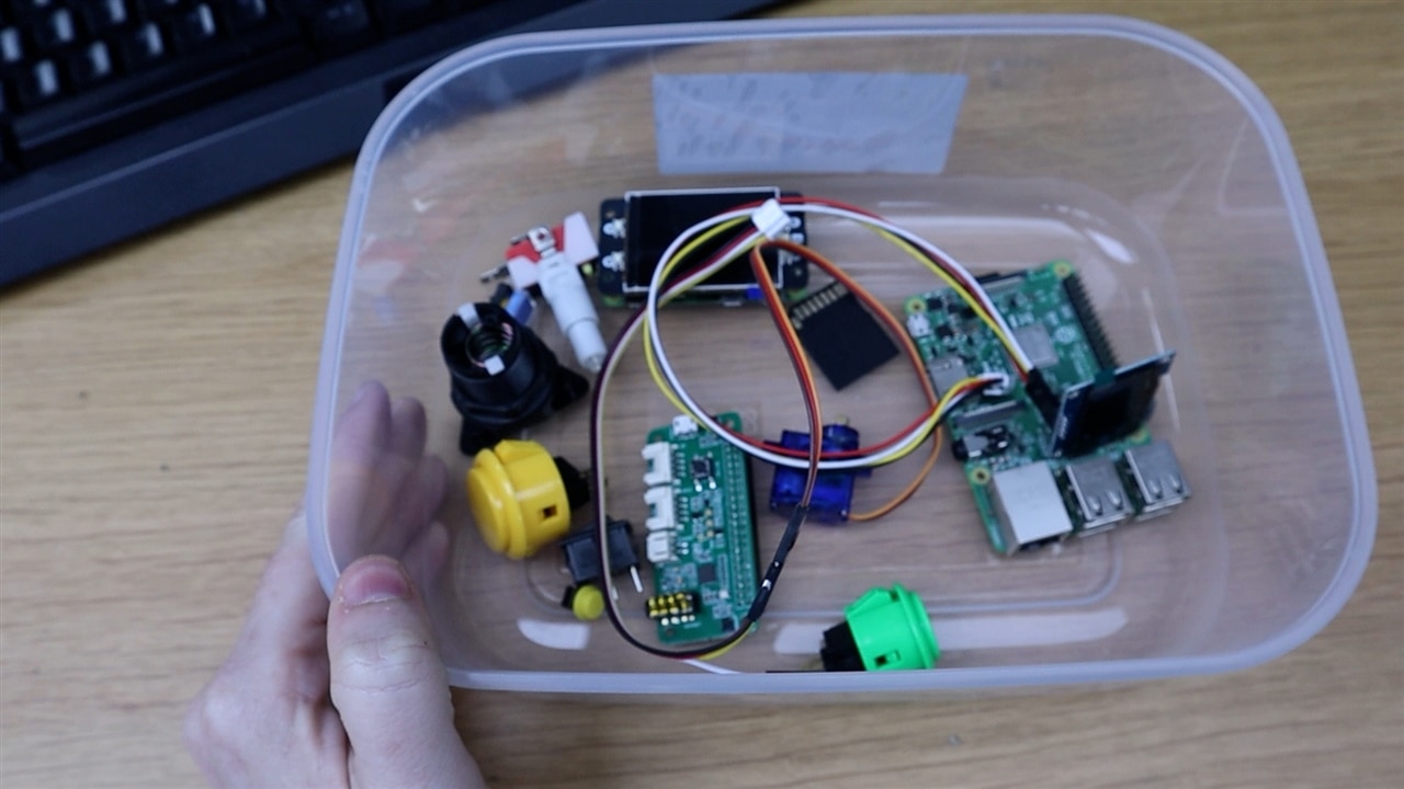

Early in the project, Lorraine breaks the system down into its core components: microphone, speaker, screen, button, servo, and a Raspberry Pi as the controller. This early sketching phase is important, because it reveals one of the recurring themes of the build: reducing complexity by choosing parts that can serve multiple roles.
The decision to use a Seeed ReSpeaker HAT is a good example. It combines microphone input, speaker output, onboard buttons, and LEDs in a single board, reducing wiring and setup effort. Lorraine notes that it “looks perfect actually for what I need,” largely because it avoids juggling separate audio components. This choice also shapes later software decisions, including how audio devices are discovered and selected in code.
From a physical design perspective, the box itself is as important as the electronics. The linguistics team’s requirement that the box be transparent drives several later decisions: how the Raspberry Pi is mounted, how the servo-driven locking mechanism is designed, and how the prize is separated from the electronics. Lorraine repeatedly returns to the idea that children should be able to see how the system works, not just interact with it.

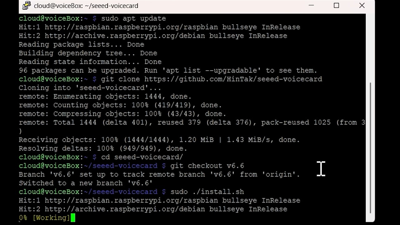

On the software side, Lorraine is explicit about the importance of environment choices. She deliberately avoids the newest Raspberry Pi OS release, noting that “we do not want bookworm… we need to go older, the bullseye”. This is a practical compatibility decision driven by audio libraries and HAT support, and it is a detail that anyone reproducing the project should pay close attention to.
Audio setup is validated early using low-level tools before being wrapped into Python. Lorraine accepts imperfections here, commenting that the microphones are “not amazing” and that some crackling is acceptable for the use case. This is an important reflection: the project is about relative similarity between voices, not studio-quality recordings.

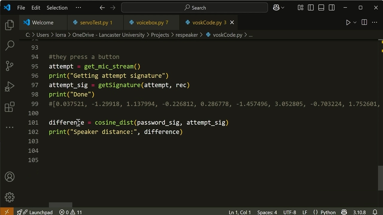

The most technically dense part of the project is the voice comparison itself. Lorraine uses the Vosk speech and speaker recognition libraries to extract a speaker “signature” from audio recordings. She is candid about this part of the code, describing much of the maths as “gobbledegook” to her, but the implementation works.
Looking at the Python script, the process is clear. A reference recording (password.wav) is captured and processed to extract a speaker embedding. Each attempt is recorded in the same way, and the two embeddings are compared using cosine distance:
def cosine_dist(x,y):
    return 1 - np.dot(np.array(x),np.array(y)) / np.linalg.norm(x) / np.linalg.norm(y)
A smaller distance means a closer match. Lorraine highlights an important behavioural detail here: timing and pauses matter. A long pause can dramatically worsen the score, which leads her to note that “that pause is going to kill a lot of people”. This observation feeds directly into future ideas about clipping silence or adjusting thresholds.
The threshold itself is deliberately loose. In the final system, a score below 0.5 triggers the servo to open the box. Lorraine leaves this choice open-ended, noting that it will ultimately be up to the linguistics team to decide what is “close enough” for their experiments.

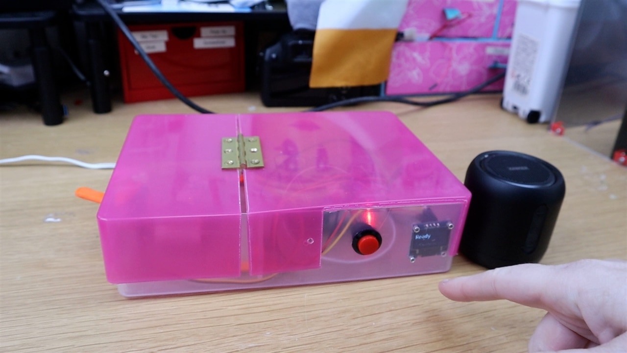

The finished interaction loop is simple and effective. The screen displays short prompts such as “Ready,” “Speak,” and “Calculating,” while audio playback reinforces what the correct phrase should sound like. In the Python code, this is handled with a small OLED helper that redraws the display for each state change.

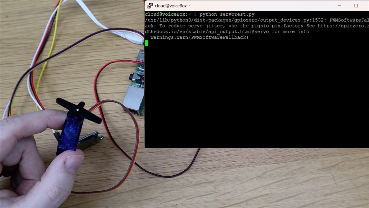

When a match succeeds, the servo opens the lock, pauses, and then closes again, ready for the next user. Lorraine notes a timing issue here during testing: the box can be slow to close if the servo movement overlaps with manual handling. This is flagged as something to refine, rather than ignored.
The live testing section of the project is particularly revealing. Lorraine and colleagues quickly discover that replay attacks work: recording the correct voice and playing it back can defeat the system. Rather than treating this as a failure, Lorraine treats it as a success for outreach. One participant summarises the moment simply: “broke the system”. For a project designed to provoke discussion about security, this is exactly the outcome she wants.

    I noticed that when you made the initial passphrase recording you had the top cover open, so there is nothing obstructing the microphones on the ReSpeaker hat. However when you are trying to unlock the box, you now have a plastic cover over the microphones.
    You might get better results if you raise the hat up and cut a hole in the cover above each microphone. Pop an acoustic overcover windshield over it to reduce the effects of breath noise.
    May also help if you isolate the box from the tabletop with some foam pads.
