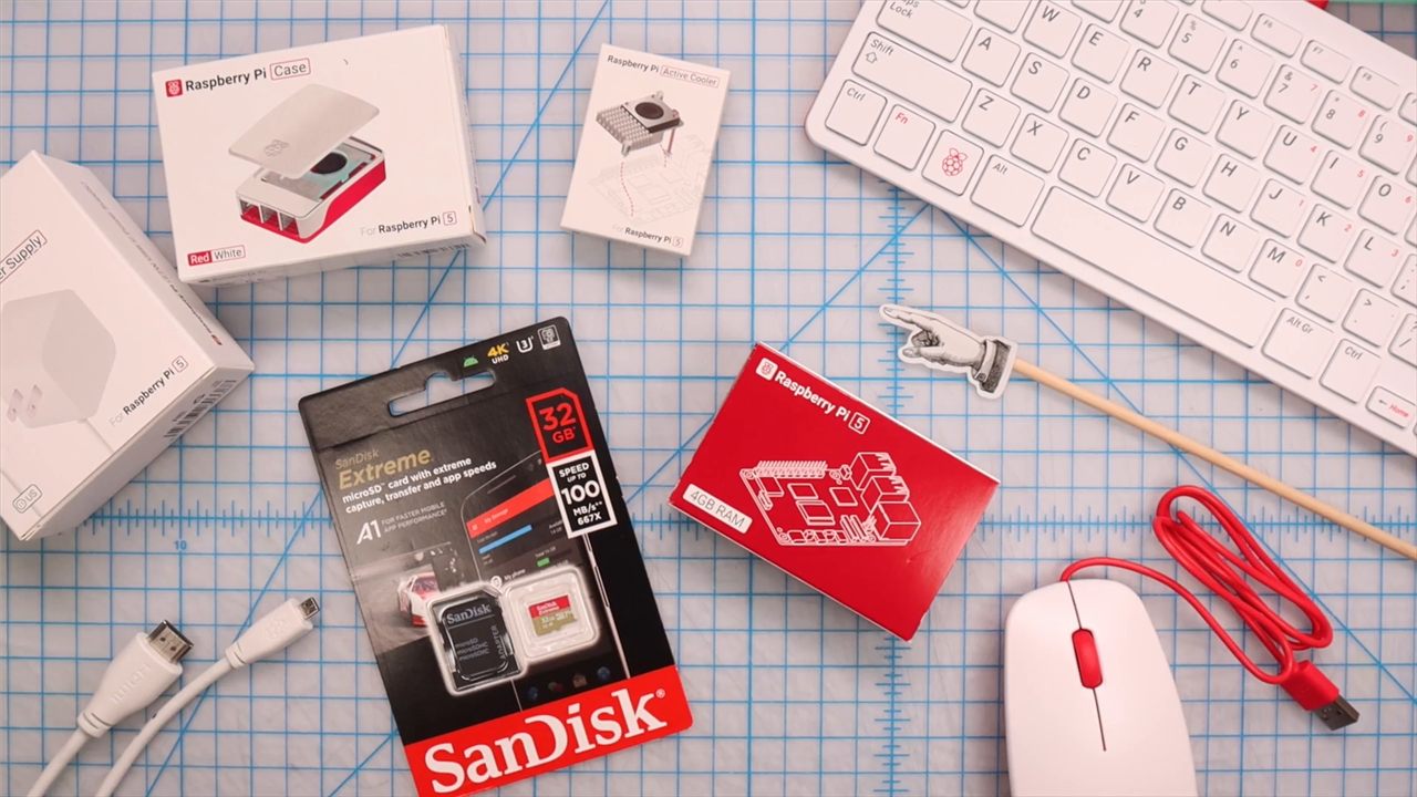

1. What You’ll Need
Before powering anything on, Natasha lays out a complete checklist. She keeps it simple and specific:
  • Raspberry Pi 5 board (2GB, 4GB, 8GB, or 16GB variant)
  • microSD card, 32GB or larger, Class 10 or better
  • microSD card reader (or SD adapter)
  • 5V 5A USB-C power supply (she uses the official 27W version which is recommended)
  • Micro HDMI to HDMI cable (you may want to seek out an alternative depending on your available monitor)
  • HDMI monitor or TV (adapting to DisplayPort monitors can be tricky but most have HDMI)
  • USB keyboard and mouse
  • Internet connection (Wi-Fi or Ethernet)
She notes her own card is 32GB, Class 30 - “so I should be good.”

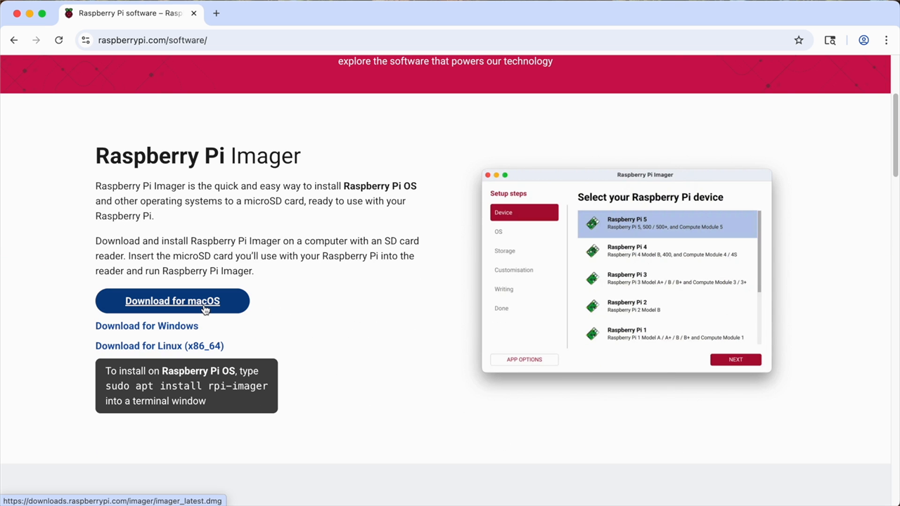

Step 2.1 – Install Raspberry Pi Imager
She downloads the official imager from raspberrypi.com/software and installs it (dragging to Applications on macOS).

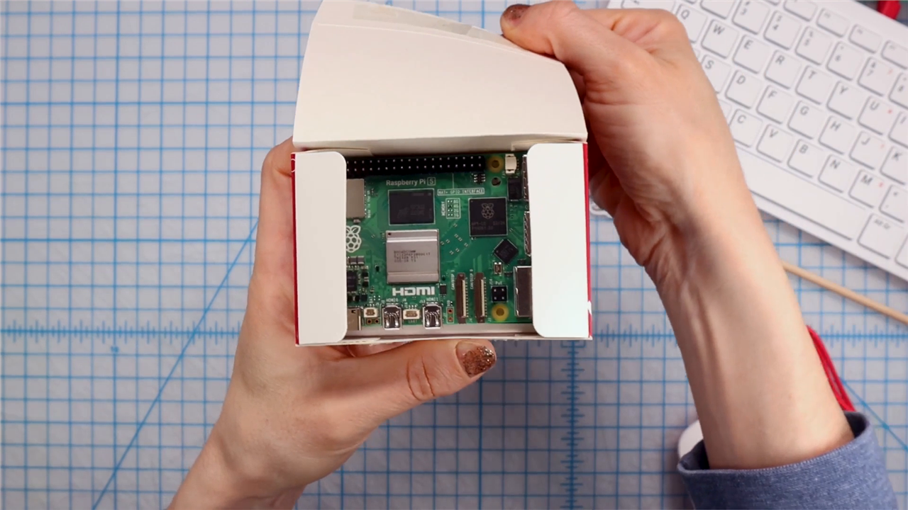

With the SD card prepared, it’s time to open the board.
Her reaction is immediate:
“Oh, yay! There she is.”

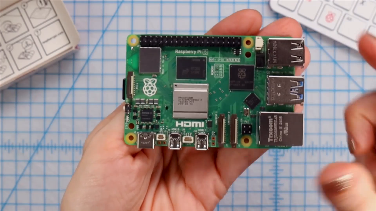

Step 3.1 – Board Overview
She gives a brief tour:
  • Ethernet port
  • Two blue USB 3.0 ports
  • Two black USB 2.0 ports
  • USB-C power input
  • Dual micro HDMI ports
  • 40-pin GPIO header
  • Power button
  • microSD slot underneath
This orientation is useful for first-time users unfamiliar with port placement.

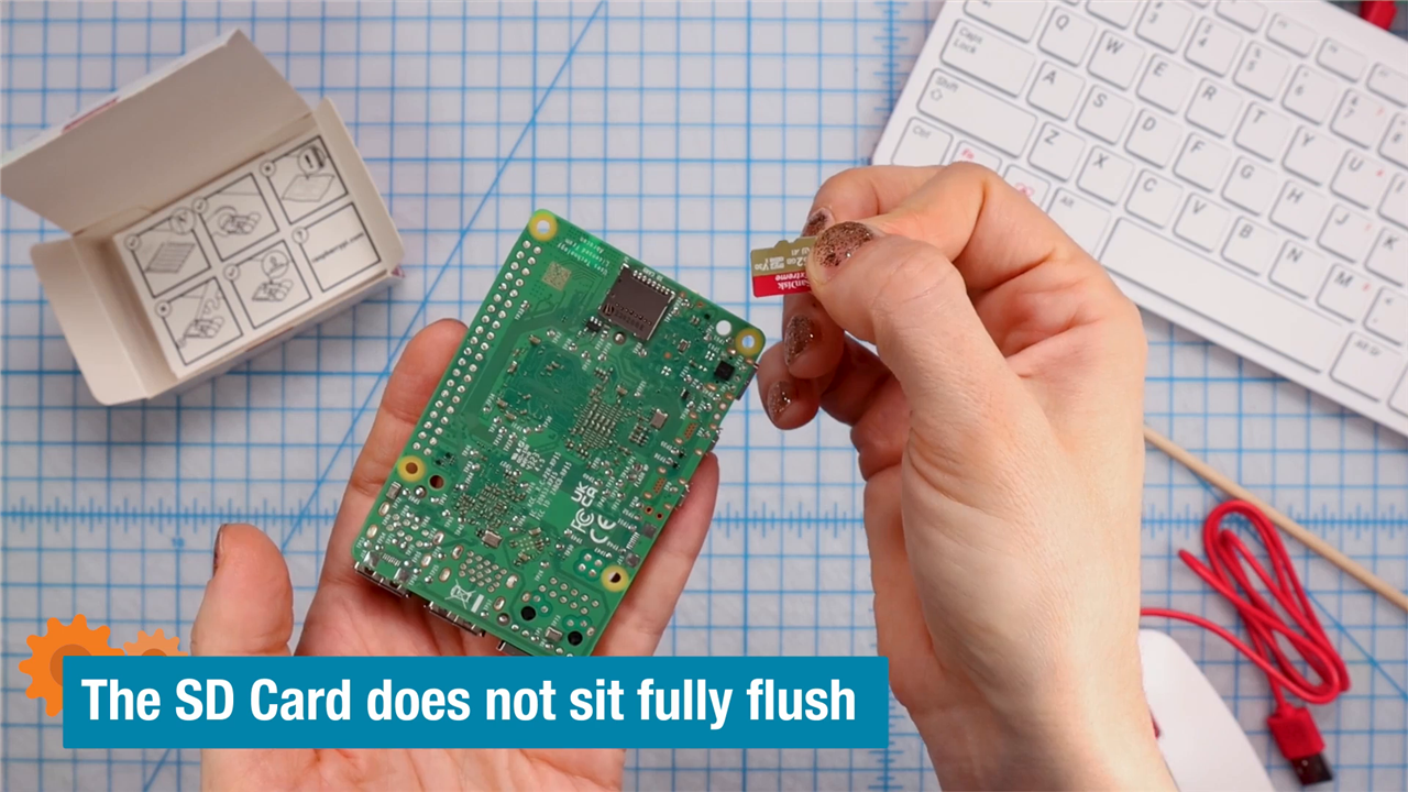

Step 3.2 – Insert the SD Card
The microSD card goes into the underside slot.

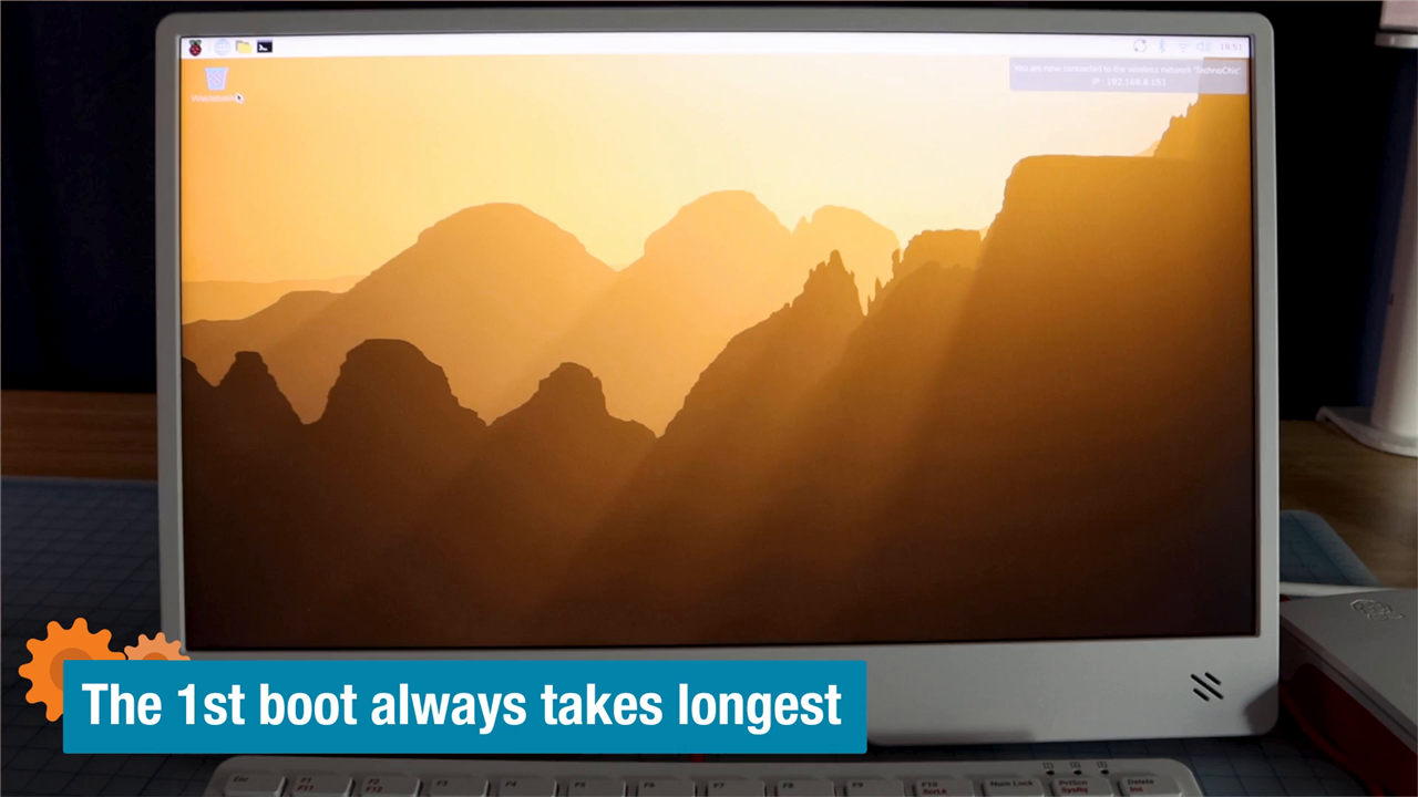

4. First Boot
Now everything is connected:
  • Micro HDMI to monitor
  • USB-C power
The Pi powers on.
“Yay! And it looks like a computer.”
If settings weren’t configured earlier, the setup wizard would guide through language, Wi-Fi, password, and display resolution. Since she preconfigured these, the system boots directly to the desktop.

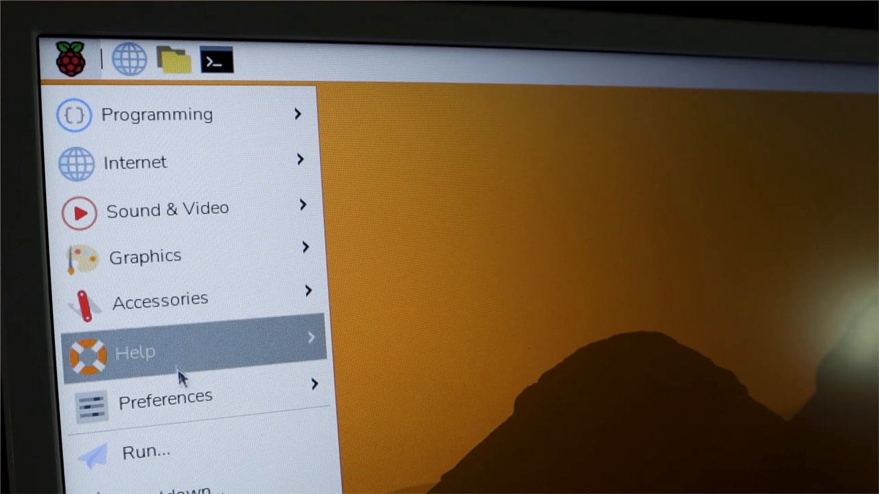

Natasha’s first instinct with any new system:
“The first thing I always like to do when I get a new computer is customise my desktop.”
She navigates:
Raspberry Pi icon → Preferences → Control Center → Picture
She selects aurora.jpg, commenting simply:
“Beautiful.”
This demonstrates that the Pi OS environment behaves like a standard desktop OS — file browser, browser, terminal, media player, and more are pre-installed.

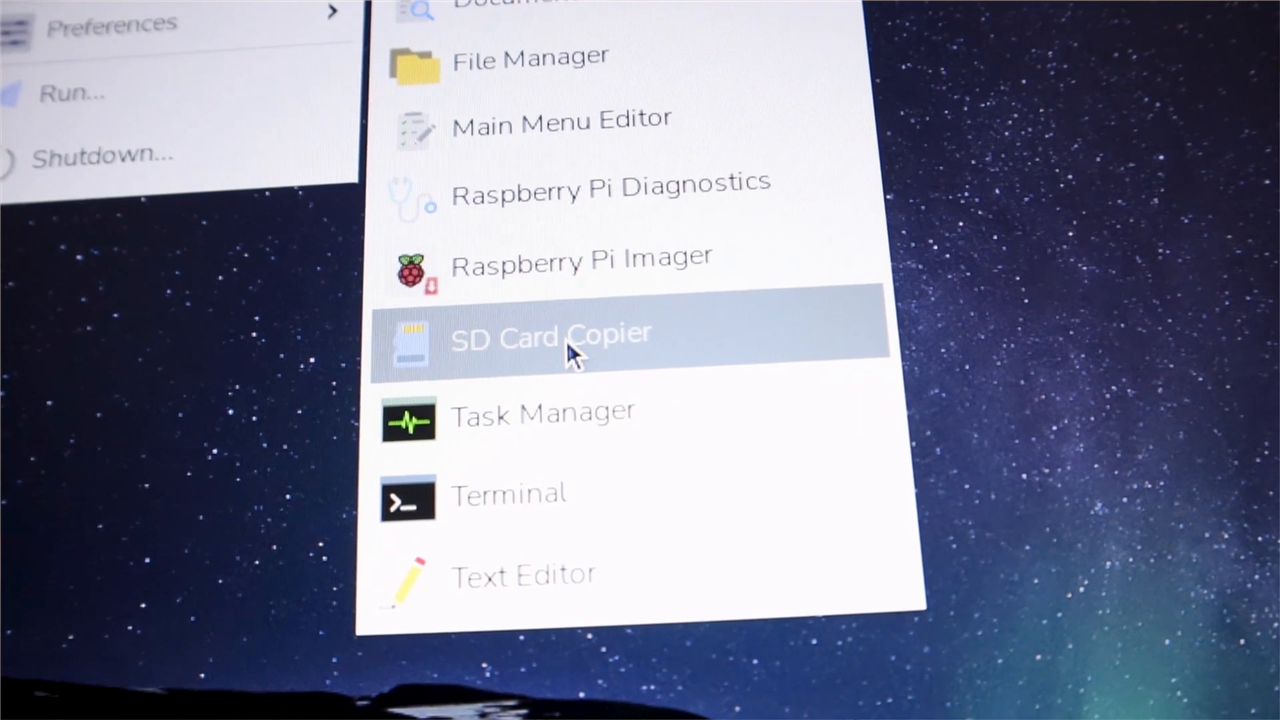

7. Backup and Maintenance
Before wrapping up, she highlights the SD Card Copier utility:
“This lets you clone your SD card to duplicate or back up your whole setup.”
Cloning is useful when:
  • Deploying multiple identical systems
  • Preserving a working configuration
  • Experimenting with riskier projects
For long-term use, this is an important habit.
