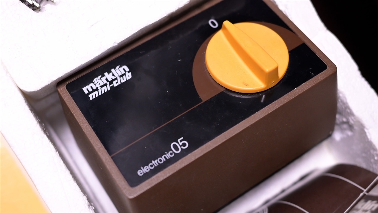

Testing the Original Controller
The first step is understanding the existing system.

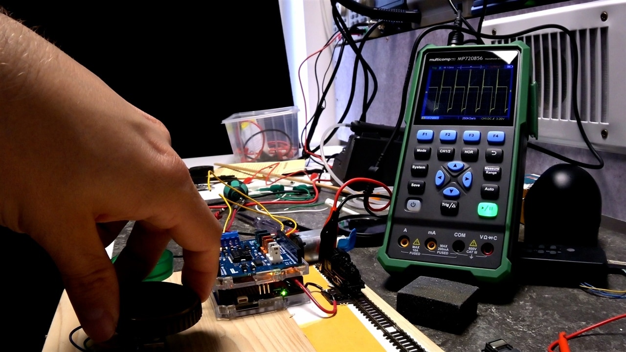

Clem connects the original controller, a variable transformer, to a short 700 mm section of Z-scale track and begins measuring its behaviour with an oscilloscope and a multi-meter. The design is typical of older analogue train controllers: a large dial adjusts the output voltage sent to the rails.
On the surface it looks smooth and continuous, but the measurements reveal several limitations.
Examining the output waveform, Clem observes:
“If I look at the waveform it produces on a scope, I can see it's meant to produce DC, but it's quite ripply.”
More importantly, the apparent analog behaviour is not truly continuous. The voltage changes in discrete steps because the transformer works by selecting different windings.
As Clem explains:
“You are reducing or increasing the number of windings that are active for the output… which is not gradual. It's actually in steps.”
The result is noticeable in practice. Small adjustments to the dial produce no visible response from the locomotive, until suddenly the voltage crosses a threshold and the train jumps into motion.
This makes delicate manoeuvres difficult, especially the kind of slow shunting operations Clem wants to perform with his miniature trains.
“There's no way for me to control my train as softly, smoothly and especially as slow as I want.”

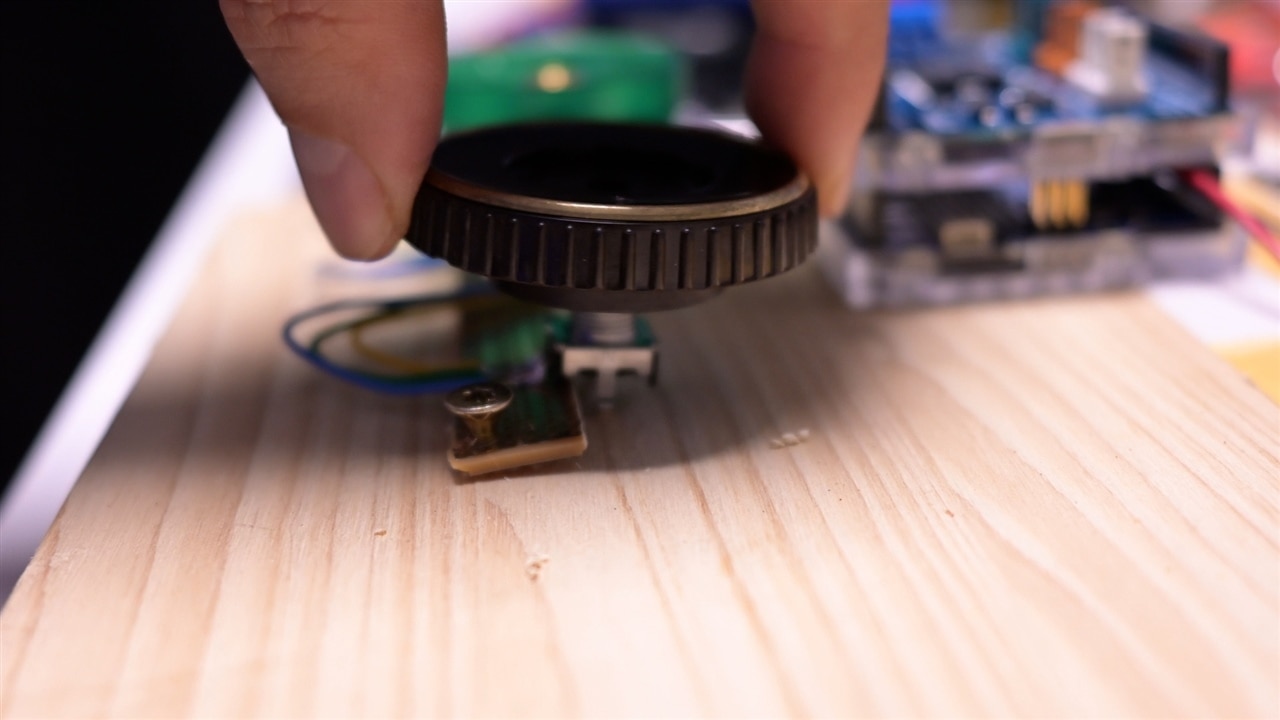

Developing the Input: Choosing the Right Encoder
The next step is selecting a control input.
At first glance, a potentiometer might seem like the obvious solution. However, Clem quickly dismisses that approach.
“If I would use a potentiometer, I would have to dissipate all the power through that potentiometer… I would need a massive potentiometer for that.”
Instead, Clem turns to a rotary encoder.
Unlike a potentiometer, an encoder does not directly regulate power. Instead, it produces digital pulses indicating rotation direction and amount. These signals can then be interpreted by a microcontroller.
“An encoder encodes rotation in a digital way. It only gives a pulse in either direction when I turn it.”
During testing, Clem evaluates two types of encoders:
  • one with tactile detents
  • one that rotates smoothly
Both technically work, but the smooth encoder provides a more natural analog-like feel for fine speed control.
“I want to know which of these feels more natural. That's how I verify the input stage.”

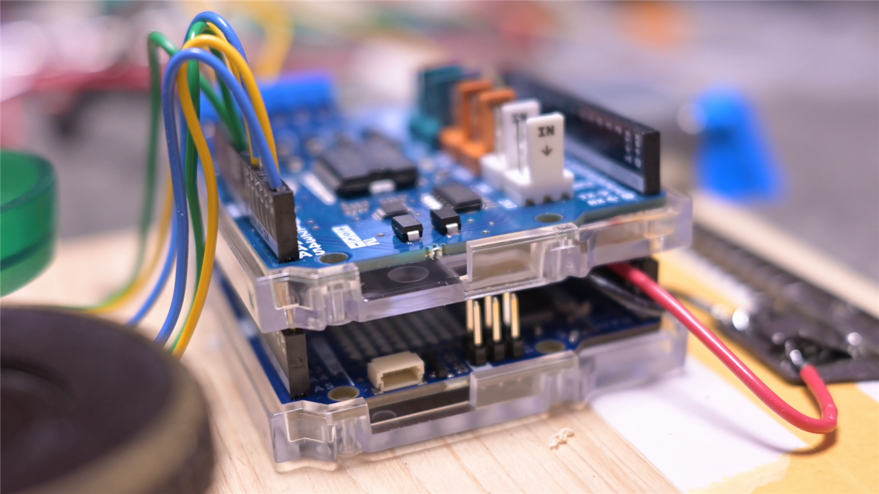

The Processing Stage: Arduino R4 and Motor Shield
To process the encoder signals and control the train, Clem uses an Arduino Uno R4, which is based on a 32-bit Renesas microcontroller.
He notes the distinction deliberately:
“Don't mistake that for the older ones… I'm using an R4, which has a 32-bit Renesas microcontroller.”
The output stage is handled by an Arduino Motor Shield Rev3, built around the classic L298N H-bridge motor driver.
This driver allows the Arduino to control both the direction and speed of the motor by switching power electronically.
As Clem points out, the concept is straightforward:
“A train set in its essence is basically a motor connected to cables that are in the shape of train tracks.”
The controller simply regulates how much power is delivered to that motor.

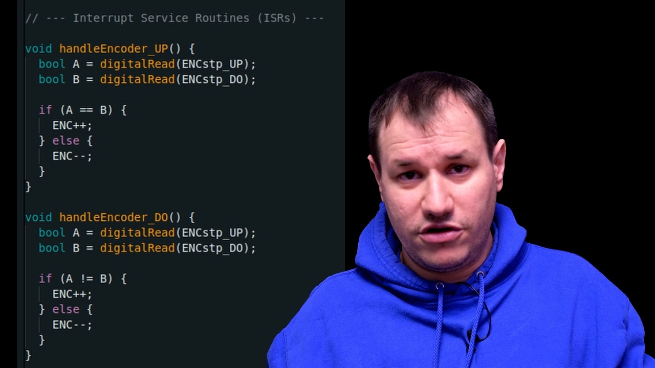

Understanding the Code
Clem’s prototype software evolves through several stages as he experiments with different control methods.
The initial implementation reads the encoder value and converts it directly into a PWM output.
In the code, the encoder count is stored in a shared variable updated through hardware interrupts:
volatile int ENC = 0;
Interrupt service routines detect the encoder’s quadrature signals and update the count accordingly:
void handleEncoder_UP() {
  bool A = digitalRead(ENCstp_UP);
  bool B = digitalRead(ENCstp_DO);
  if (A == B) {
    ENC++;
  } else {
    ENC--;
Inside the main loop, the current encoder value determines the direction and PWM output:
if (encCopy > 0) {
  Dir = 1;
  pwm = constrain(encCopy, 0, 255);
} else if (encCopy < 0) {
  Dir = 0;
  pwm = constrain(-encCopy, 0, 255);
The PWM signal is then applied to the motor driver:
digitalWrite(DIR_B, Dir);
analogWrite(PWM_B, pwm);
This structure allows the controller to respond instantly to encoder movement.

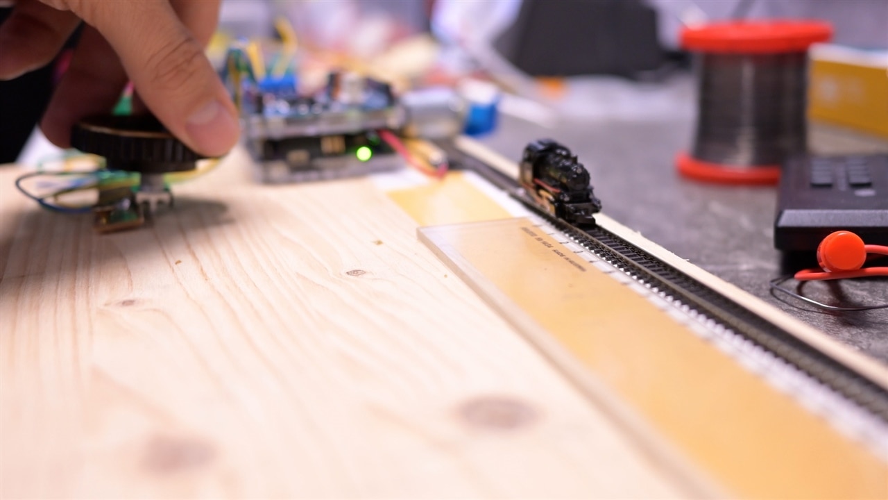

Verifying the Output
With the system assembled, Clem tests the controller on his short section of track.
He even attaches a ruler beside the rails to measure how quickly the train travels across the test distance.
“By seeing the little train move along this little piece of track, I can verify my output.”
The improvements are immediately visible.
The locomotive now starts smoothly, moves predictably, and responds proportionally to even small adjustments of the dial.
