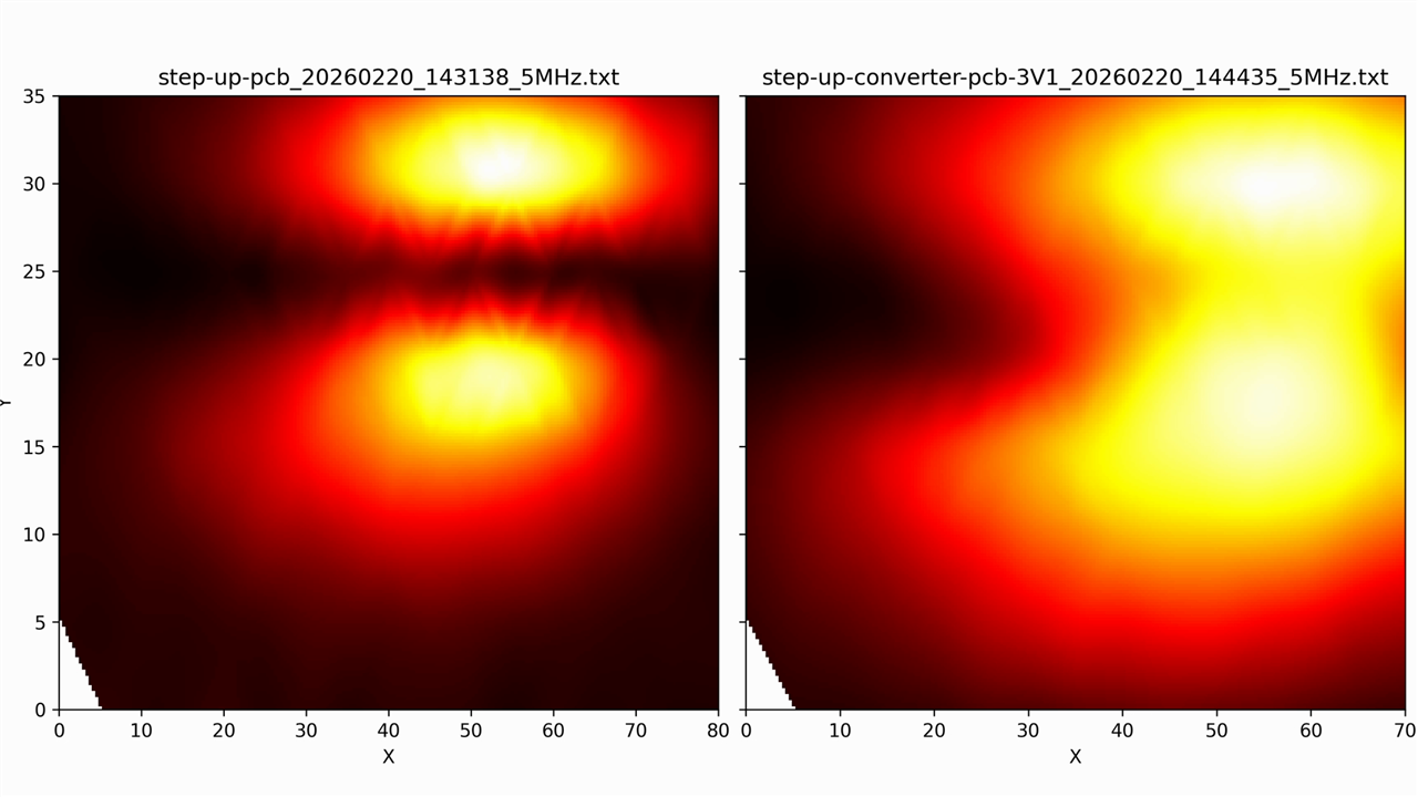

Once the user interactively defines the scan area by jogging the probe to the lower‑left and upper‑right corners of the region of interest, GRBL dynamically generates the zig‑zag toolpath. Clem deliberately chose GRBL 1.1 running on an Arduino Uno because it provides CNC‑style control without imposing the assumptions typical of modern 3D printer firmware.

The software is designed to scan multiple frequencies in a single run. At each X‑Y coordinate, the system measures all selected frequencies before moving on to the next point. This approach is reflected in the scanner module, which parses the generated G‑code and interleaves motion with data acquisition.
Each scan produces a plain text file per frequency containing X and Y coordinates along with received power in dBm. A secondary script converts this data into heatmap images. This separation allows raw data to be preserved for further analysis while still producing visuals that are easy for humans to interpret.

Using conductive tape, proper grounding techniques, and purpose‑built EMI gaskets, Clem shows how reducing the noise floor dramatically improves scan clarity. Once background noise is sufficiently suppressed, subtle emission sources become visible in the heatmaps, allowing engineers to draw much more confident conclusions.
