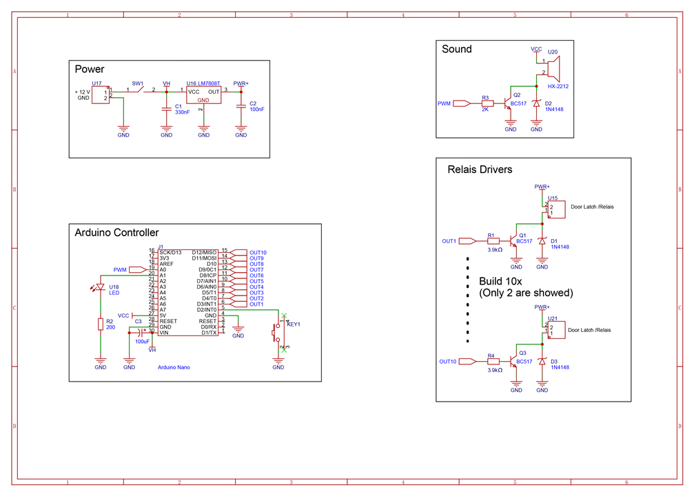

The Schematic
The system is divided cleanly into four functional sections: power, control, sound, and actuation.
The power design reflects Mark’s preference for simplicity and reliability over modern optimisation. While acknowledging newer approaches, he intentionally uses a linear regulator:
“I know it's not the most elegant regulator nowadays, but it's analog and it's proven and tested… that's why I use it.”
An input supply (e.g. 12V) is stepped down to 8V for the actuators. This is a deliberate choice to provide sufficient drive strength to the relay-based mechanisms responsible for releasing the sticks.
The Arduino Nano operates using its onboard regulator, while also serving as the central controller. A push button connected to digital pin D2 serves dual purposes: starting the game and toggling difficulty.
This behaviour is clearly implemented in the code:
#define StartButton 2
EasyButton button(StartButton);
void buttonPressed() {
  running = !running;
void sequenceEllapsed() {
  expertmode = !expertmode;
  digitalWrite(ModeLed, expertmode);
button.onPressed(buttonPressed);
button.onSequence(2, 1500, sequenceEllapsed);
Here, a single press toggles the game state, while a double press (within 1500 ms) activates “expert mode” — a faster-paced variant of gameplay.
The sound system is implemented using a PWM-driven speaker, producing simple tones to indicate game states. Mark describes this pragmatically:
“It’s only used to generate a beeping sound to indicate the start and the end of a game… it will do the job quick and dirty.”
Finally, the relay drivers form the core of the mechanical interaction. Each relay controls a latch mechanism holding a stick. When triggered, the latch releases, allowing gravity to do the rest.

int randStick = random(3, 13);
while (valueExistsInArray(droplog, arraySize, randStick)) {
This ensures that each actuator is triggered only once per game cycle, a detail not explicitly called out in the original blog, but critical to gameplay integrity.
