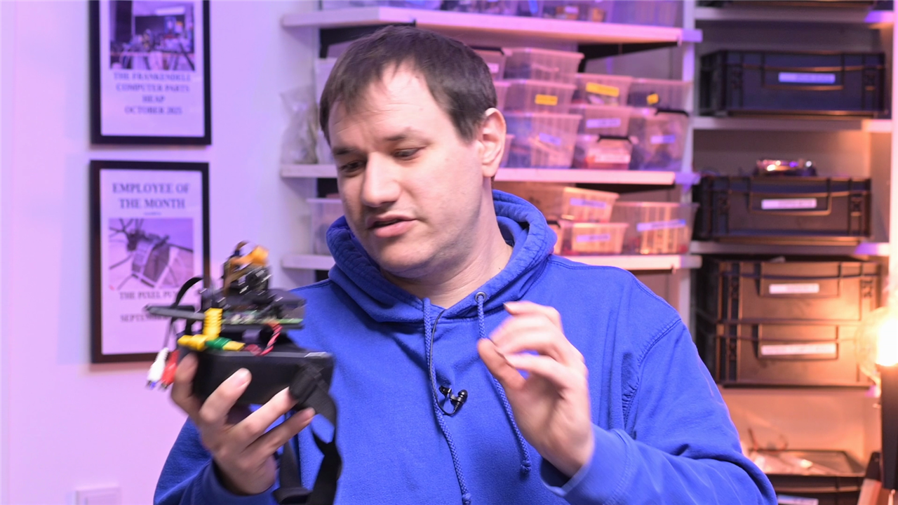

Strapping It On: The Human Test
With the system assembled, the real experiment begins. The cameras and Raspberry Pi are mounted directly onto the FPV goggles, with 3D-printed parts doing little more than holding everything in place and keeping cables out of the way. Ironically, the abundance of cables quickly becomes irrelevant: with eyes effectively on the sides of the head, anything directly in front simply fades from awareness.
The first test configuration places the cameras at a more animal-like angle, around 70 degrees. In this mode, everyday tasks become difficult but not impossible. Measuring the voltage of a AAA battery, writing the value down, and packing everything away can be done, albeit slowly and with exaggerated head movements. The brain begins to adapt, treating this strange stitched panorama as a new normal.
Push the cameras out to a full 90 degrees, however, and the experience deteriorates rapidly. Frontal vision all but disappears. Tasks rely almost entirely on touch. Even reading a multimeter display becomes a struggle. The discomfort escalates from simple disorientation to genuine nausea, accompanied by headaches that linger long after the goggles come off.
Beyond the discomfort, the experiment reveals something subtle about animal behaviour. Zig-zagging prey movements, often dismissed as panic, suddenly make sense. With side-mounted vision, maintaining visual contact with a threat means constant changes in direction. What looks erratic from the outside is, in fact, a logical response to a very different sensory input.
Equally revealing is how quickly the human brain attempts to adapt. Given enough time, it is clear that operating with side-mounted vision is possible. It is just profoundly unpleasant for a brain evolved to expect depth and focus straight ahead.
