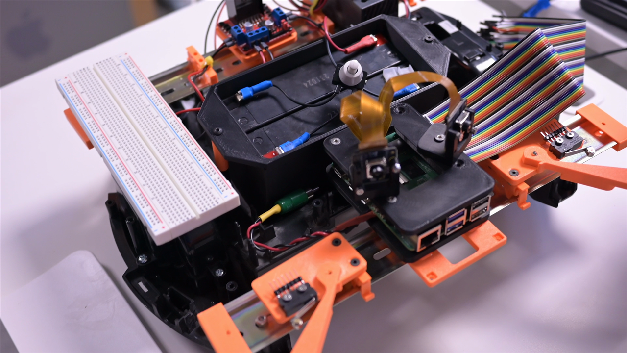

The reused chassis provides motors, wheels, and a compact structure,allowing Clem to focus on control systems and modularity rather than mechanical fabrication. One of the defining features of this build is the use of DIN rails. While typically associated with industrial control systems, Clem repurposes them to enable rapid iteration and experimentation.
“I just slap on some DIN rails on the robot’s chassis… which means you can just attach whatever you want,sensors, controllers, additional dev boards.”
This approach transforms the robot into a flexible platform rather than a fixed design. Custom and community-sourced mounts support components such as the Raspberry Pi, motor drivers, bump sensors, and power systems. The addition of limit switches mounted on articulated arms introduces basic collision detection, something not explicitly detailed in the original blog draft.
A particularly practical addition is the DIN-mounted USB power interface. This allows Clem to separate logic and high-power systems:
“This allows me to disconnect the Raspberry Pi whenever I just want to power up all the 12-volt systems… I don’t have to worry about my Pi not shutting down properly.”

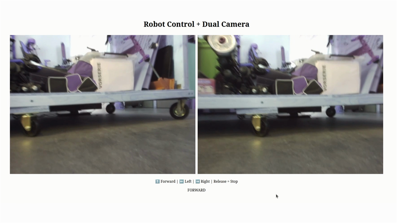

At the center of the system is a Raspberry Pi 5, paired with dual camera modules. These are configured to stream video simultaneously, widening the robot’s field of view.
“With two cameras, we can widen the field of view… which means it’s a lot easier to navigate around.”

Powering a Raspberry Pi 5 alongside motors is non-trivial, and Clem’s solution deliberately deviates from typical lightweight robotics design.
Rather than lithium-based batteries, he opts for two 6V sealed lead-acid batteries wired in series:
“The cheapest, heavyweight solution… is just classic lead-acid batteries… I actually need more weight… otherwise it will slip.”
This decision illustrates a key engineering trade-off: the added mass improves traction for the spring-loaded drivetrain while still delivering sufficient current.

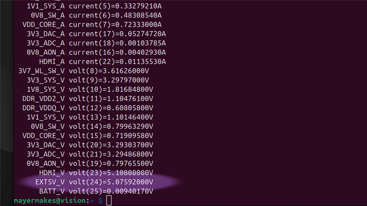

Fine-tuning the voltage regulator proved critical. Clem highlights an often-overlooked nuance:
“I don’t measure that with a multimeter… I need to know what the Raspberry Pi sees… I want it to always see 5.0 to 5.1 volts.”
This insight is particularly valuable for anyone attempting similar builds, as it avoids common brownout issues under load.
A Deliberate Choice: No ROS, FastAPI and Real-Time Control
Unlike many robotics platforms, this build intentionally avoids ROS (Robot Operating System). Clem instead develops a lightweight, purpose-built system tailored to his exact requirements.
“I’m not using ROS… I just rather do it from scratch and just how I want it to be.”
This decision simplifies the software stack, reduces overhead, and keeps the system highly responsive, though it does place more responsibility on custom implementation. The robot is controlled over a network using a Python backend built with FastAPI and served via Uvicorn. This combination enables near real-time responsiveness.
“I wanted to have real time controls… using the keyboard arrows… Flask, Bottle… none of these would yield any form of real time controls.”
The final implementation exposes both HTTP endpoints for video streaming and a WebSocket interface for command control. The structure is clear in Clem’s code:

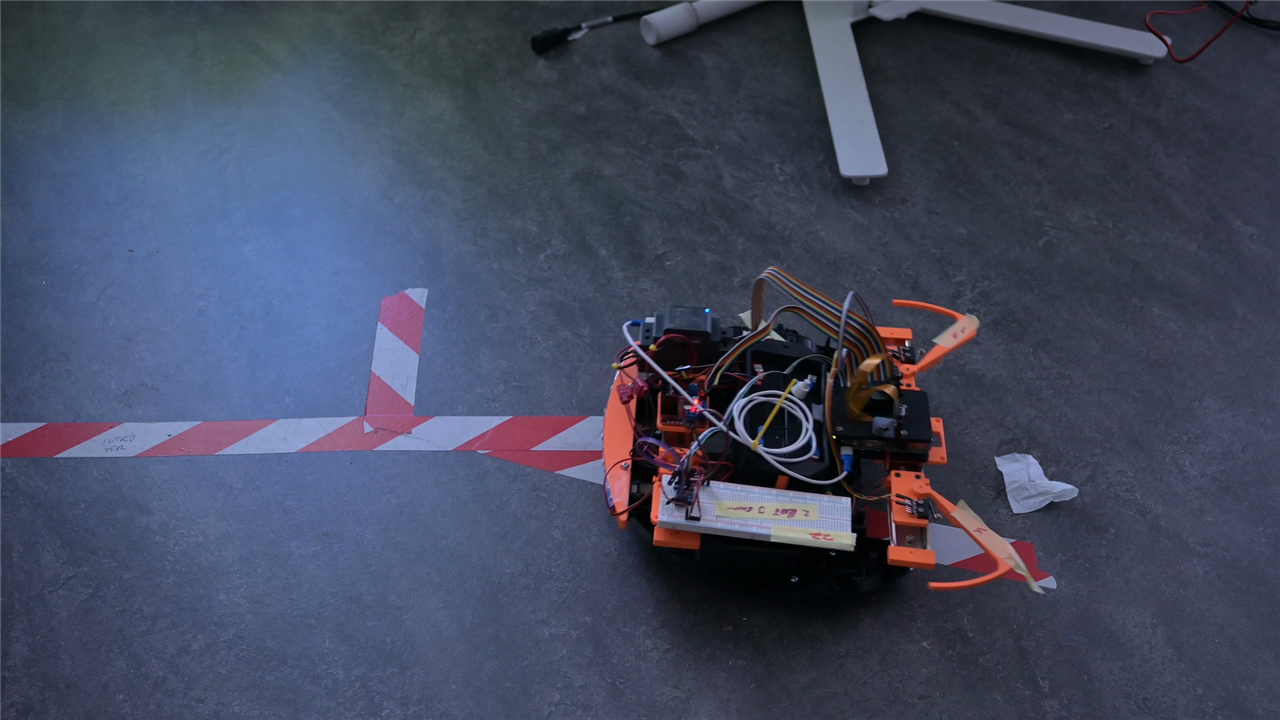

“I couldn’t run the motors backwards… once I got stuck in a corner, I was stuck.”
Incremental testing allowed Clem to isolate and resolve these issues without overcomplicating the system early on. This iterative approach is consistent throughout the project. Despite its technical depth, the project retains a playful objective, retrieving a dropped tool:
“Of course the robot can just hand me a broom… it works… kind of.”
More importantly, Clem positions this build as a foundation for future work. The system is not yet autonomous, but it is designed to become so.
“Now we have a fully real-time controllable robot… but it’s not autonomous yet… what kind of sensors and processing power should we add?”
