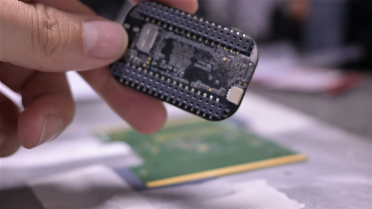

At the centre of the build is the PocketBeagle 2, chosen not for simplicity but for control and flexibility. Although not as beginner-friendly as some alternatives, Clem deliberately leans into its strengths, noting its fast boot time and suitability for edge applications.

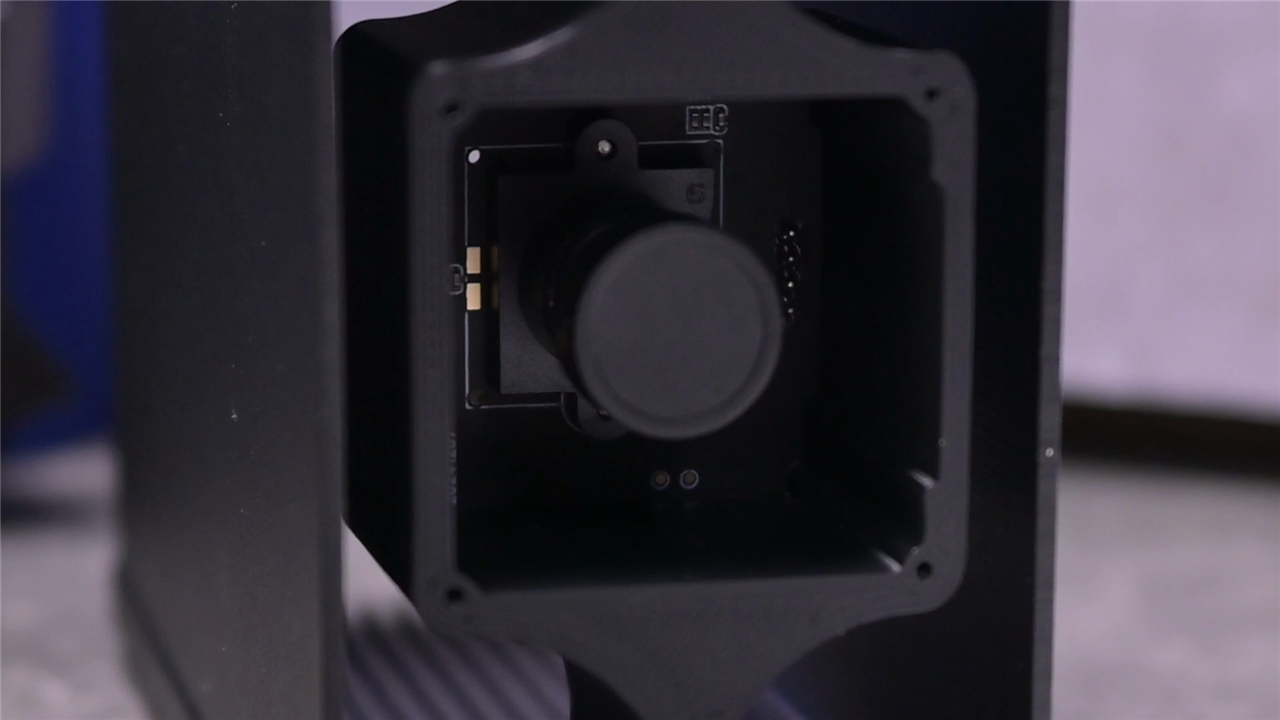

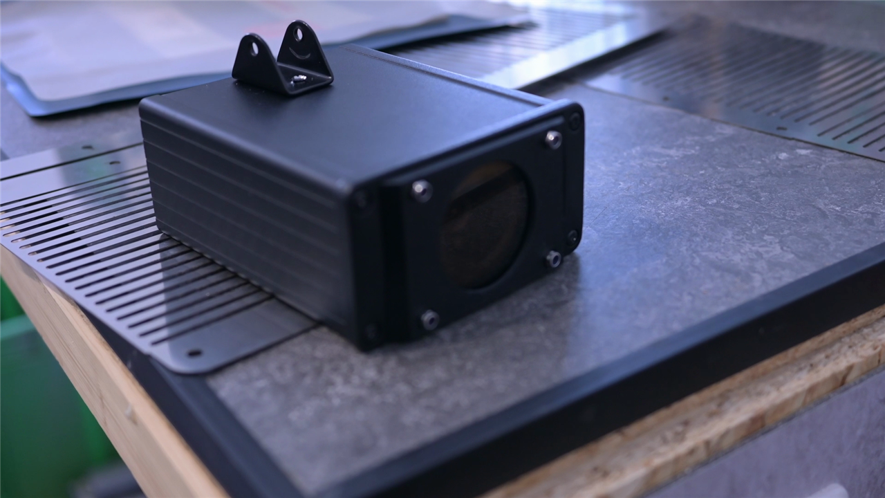

To give the device a familiar form factor, parts from a dummy security camera were repurposed,including the glass front and swivel mount. However, the final enclosure is far more robust. A watertight aluminium housing from Hammond Manufacturing provides environmental protection, while internal slots allow direct PCB mounting.
Mechanical design plays a key role throughout. Custom ASA 3D printed parts ensure precise positioning of the USB camera module, with the material selected for its durability and thermal stability. Clem highlights the importance of temperature resilience, explaining that internal heat from the embedded computer required a material that wouldn’t deform over time.
The project demonstrates careful planning at the mechanical-electrical boundary. By using manufacturer CAD data, Clem designed the PCB before receiving the enclosure, achieving a precise fit with just 0.2 mm of tolerance,evidence of how reliable modern design workflows can be when properly executed.

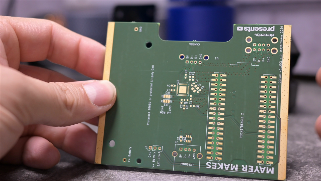

Custom PCB and USB Integration

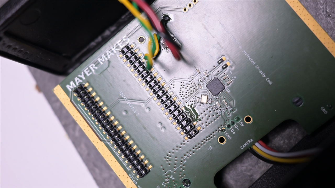

The custom PCB serves as the backbone of the system, integrating power distribution, USB connectivity, and expansion. A Microchip USB2514 hub controller enables multiple USB devices to operate simultaneously, crucial for combining the camera, storage, and networking interfaces.
This aspect proved to be one of the most challenging. Clem admits,
“I’ve been a bit of a burnt child with USB hub designs… it was down to the crystal and its load capacitors.”
Initially intending to simplify the design with an oscillator, he encountered a compatibility issue late in the process. The device he selected produced a voltage level unsuitable for the hub controller, risking damage to the chip.
A last-minute redesign reverted the system to a traditional crystal oscillator network. Even then, compromises had to be made:

Although this configuration snippet relates to the software stack, it reflects the same engineering philosophy, working within constraints while maintaining system-level reliability. On the hardware side, Clem worked with slightly mismatched capacitor values, relying on trace capacitance to balance the circuit.
“The only way to find out is to just try it.”

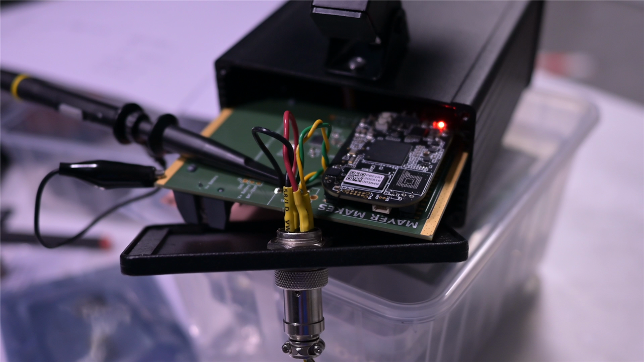

Networking and power delivery introduced unexpected complexity. Instead of integrating networking directly into the camera housing, Clem routes connectivity through an external junction box. This isolates access points and ensures that tampering with the camera itself doesn’t expose the network interface.
The system uses a Traco Power 5 V supply, paired with carefully tuned voltage output. What initially appeared to be a networking issue turned out to be something far subtler:
“Under full load my device will draw enough power to make the voltage drop… just enough to make the PocketBeagle stall.”
A minor voltage adjustment, from borderline levels to a stable ~5.0 V, resolved persistent connection failures. This kind of issue is often overlooked but demonstrates how sensitive embedded systems can be to power integrity.

With all components enclosed in a watertight aluminium housing, heat dissipation becomes critical. Clem addresses this with a small heatsink mounted directly to the processor, coupled to the enclosure using thermal compound.
This effectively turns the entire chassis into a passive heat spreader. As a secondary benefit, the system self-heats in colder environments, reducing the risk of condensation or frost:
“It produces warmth itself… in the winter… it will also keep itself free of any frost.”

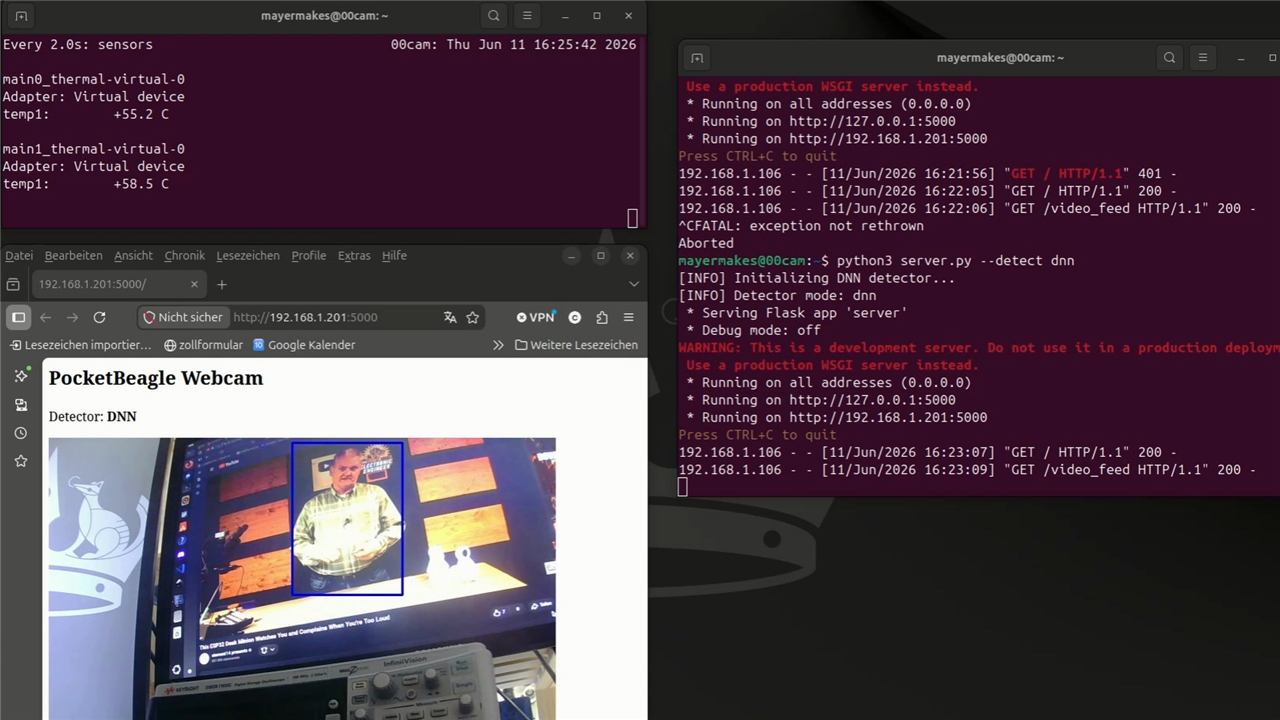

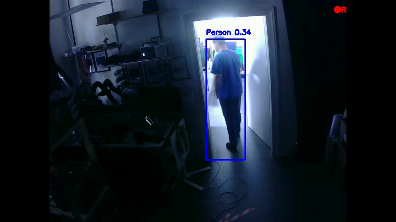

Rather than recording continuously, the system uses on-device computer vision to detect human presence. Two detection methods are implemented: HOG (Histogram of Oriented Gradients) and a lightweight DNN running locally on the PocketBeagle 2.
As Clem explains:
“HOG… barely works… But DNN… does all the inference locally on its own hardware.”
The software stack is intentionally minimal, built around Python, OpenCV, and a simple web server. The streaming and recording logic is handled through a Flask-based application:

Recording is triggered only when a person is detected, with a short delay before stopping:
“If a person gets in view… it starts recording… and if that person left… for more than three seconds it will stop it.”
This behaviour dramatically reduces storage requirements and makes reviewing footage far more efficient.
