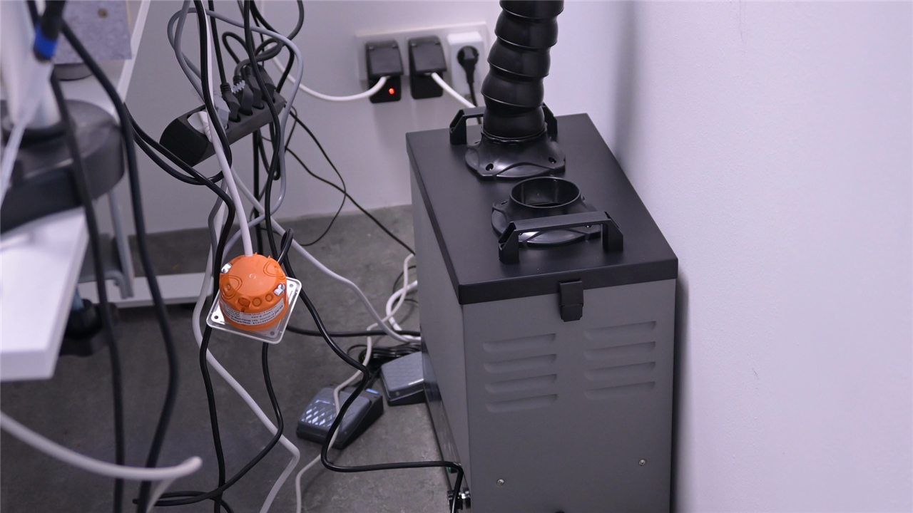

A Better Approach to Fume Extraction
One of the more visible upgrades came directly from community feedback. During the previous workbench tour, viewers questioned whether the existing DIY extraction setup provided adequate protection for prolonged soldering sessions. Rather than making incremental changes, Clem decided to install a dedicated dual-arm fume extraction unit. The system incorporates pre-filtration, HEPA filtration, and activated carbon filtering within a self-contained package.
The upgrade complements the original extraction arrangement rather than replacing it entirely. Both systems have been integrated into the existing remote-controlled switching setup, allowing them to operate simultaneously whenever soldering work begins.
"The community's nagging got me to upgrade the fume extraction system."
In use, the dual extraction arms provide considerably more flexibility than the previous fixed arrangement, allowing airflow to be positioned directly where fumes are generated. While the original extraction system continues to contribute overall airflow, the dedicated extractor offers the advantage of being portable and self-contained, making it useful in situations where permanent ducting is impractical. After testing both approaches side-by-side, Clem concluded that the dedicated extractor provided superior filtration and positioning flexibility while still integrating neatly into the existing workshop infrastructure.

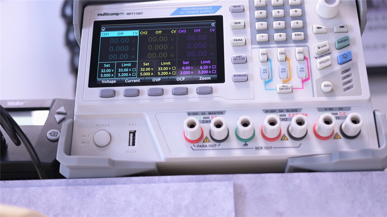

Although Clem remains a fan of his existing bench power supply, particularly because of its simplicity and speed of use, the new upgrade focuses on capabilities beyond simply delivering power. The centrepiece of the new measurement stack is a programmable four-output bench supply featuring two 0-30 V, 5 A channels alongside a dedicated low-voltage precision channel and an independently controlled USB output. The additional channels dramatically increase flexibility when powering more complex projects.
The power supply is supported by a programmable bench digital multimeter, a programmable DC electronic load, and an arbitrary waveform generator. Together they create a complete measurement platform capable of sourcing power, applying controlled loads, performing precision measurements, and generating test signals.
The installed equipment includes:
  • MP711001 programmable four-output power supply

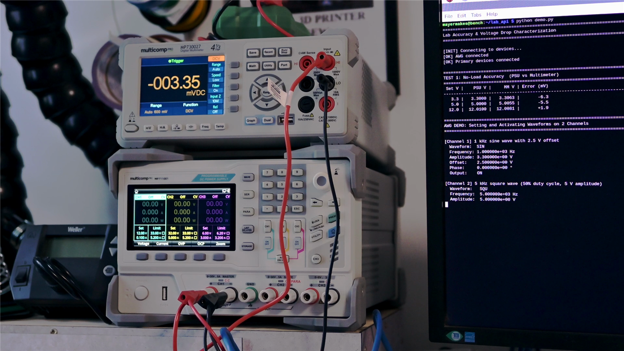

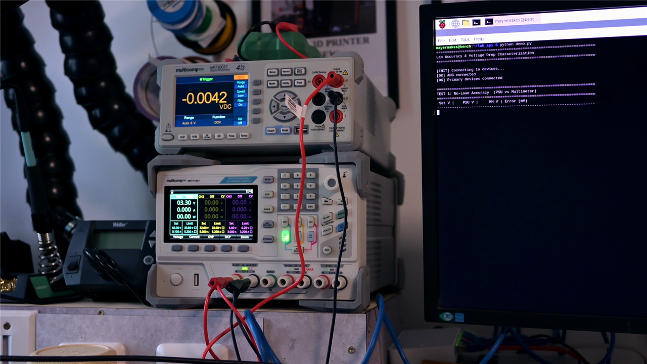

The demonstration application performs several automated validation exercises that would be time-consuming to execute manually.
The workflow includes:
  • No-load accuracy validation at multiple output voltages
  • Voltage-drop characterisation under increasing load current
  • Power-supply regulation testing across 3.3 V, 5 V and 12 V rails
  • Constant-resistance load testing
  • Arbitrary waveform generator control and activation
The script automatically applies voltages, changes load conditions, waits for outputs to settle, collects readings from multiple instruments, calculates deviations, and records the results. Rather than simply taking a single measurement, the framework sweeps through operating ranges to build a much more complete understanding of system behaviour.
"I can automate that and just go through all the possible scenarios and then see how much the error in measurement is."

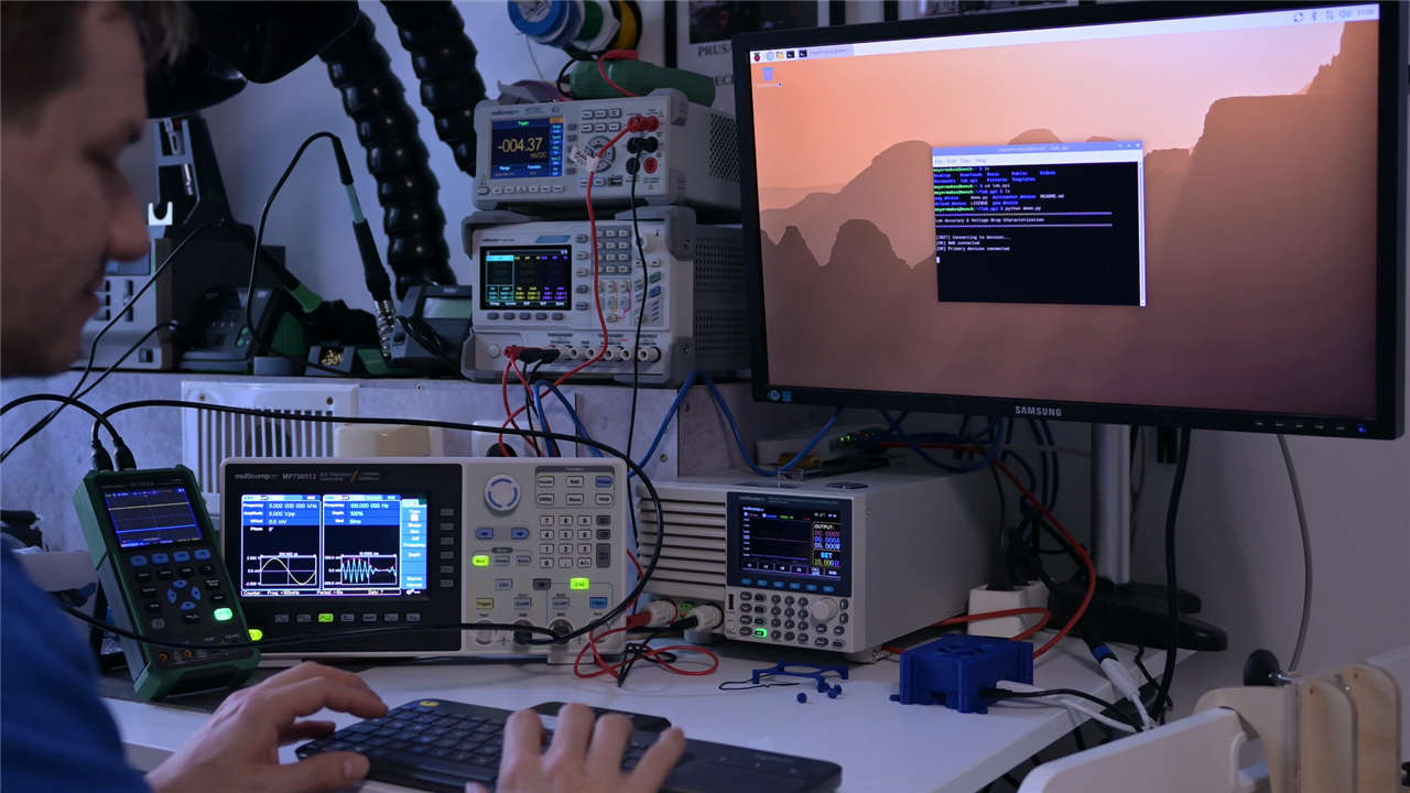

Because every instrument is connected via Ethernet, the measurements can be run from anywhere on the network.
"For sensitive measurements I can even leave the room and run them from outside and still look at all the data in real time."
This becomes useful whenever environmental effects could disturb measurements or when long-duration tests need to be left unattended.

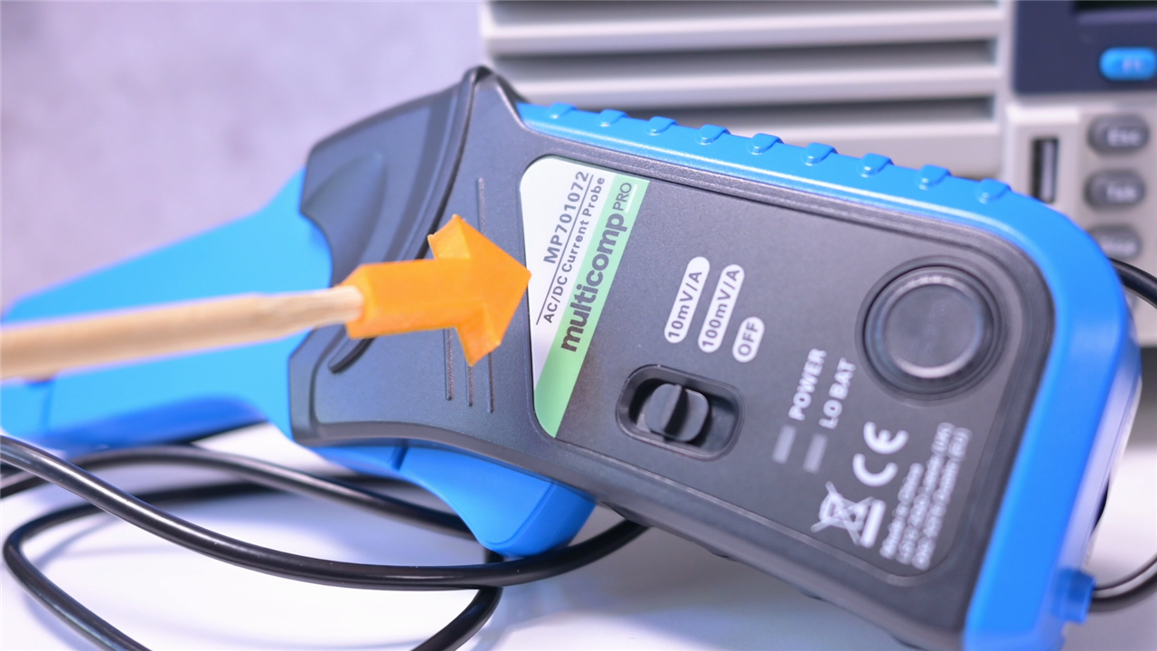

Unlike traditional current measurements that require inserting a meter into the circuit, the clamp allows current to be monitored without disconnecting or modifying wiring.
The probe provides a voltage output proportional to the measured current, making it suitable for direct connection to either a multimeter or an oscilloscope.
Selectable output scaling allows engineers to trade sensitivity for measurement range, depending on the application.
"I don't have to break up the circuit anymore."
While not intended to replace precision inline measurements, the probe dramatically simplifies troubleshooting and verification tasks where convenience is more important than ultimate accuracy.
