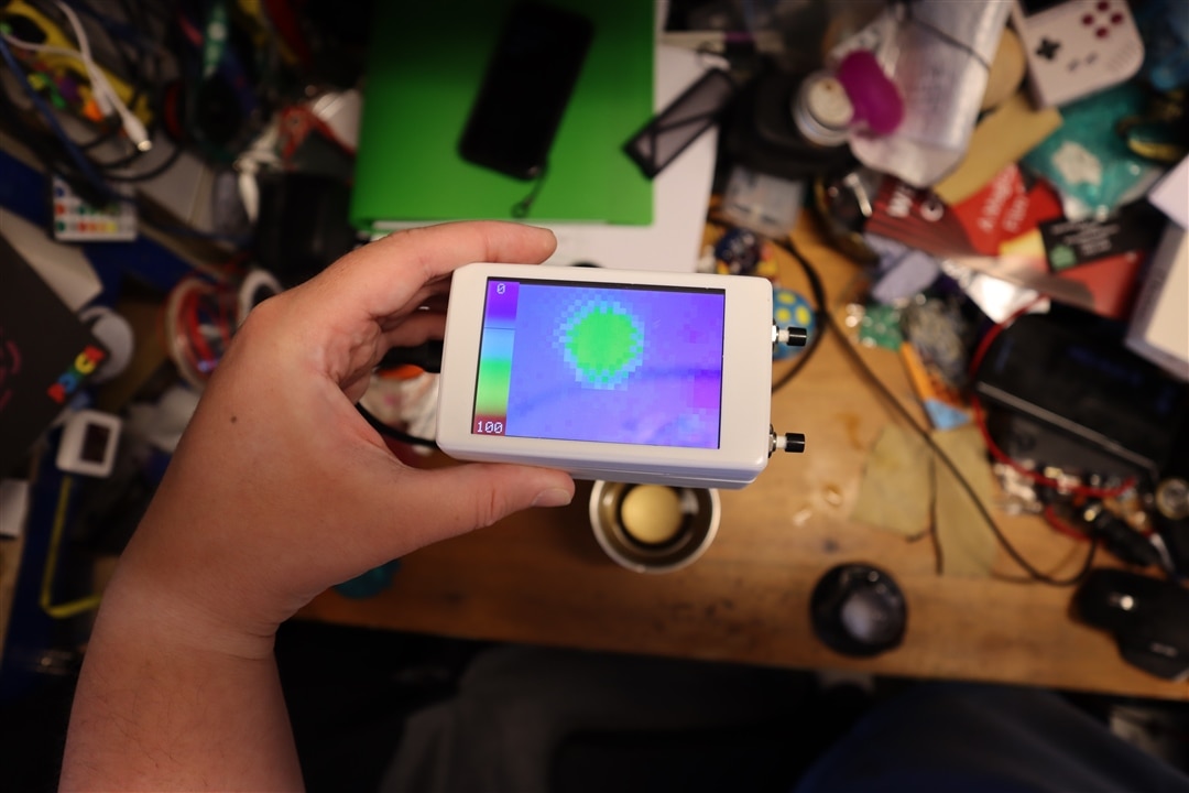

Before committing to the enclosure design and software architecture, the project began with a simple proof-of-concept test.
The thermal sensor and display were wired together with the Arduino, and example software from the display and sensor libraries was adapted into a quick prototype. To verify operation, two everyday thermal references were selected: an ice cube and a container of near-boiling water.
"I've taken the example code for the library for the camera and the screen and just popped them together just to make a really simple test to check this is going to do what I want it to do."
The resulting thermal images immediately demonstrated that the system was operating correctly. Cold regions appeared deep blue, while high-temperature regions saturated towards red. Even subtle thermal effects became visible.
"I'm getting detail of the steam coming off the cup as that greeny, so not as hot but hotter than ambient temperature."
The testing phase also verified that temperature gradients around the cup could be observed clearly, with transitions through yellow and green before reaching ambient background temperatures. Many DIY thermal imaging projects stop at a bench-top prototype, but this build was intended to become a practical tool capable of being stored in a toolbox and used repeatedly.

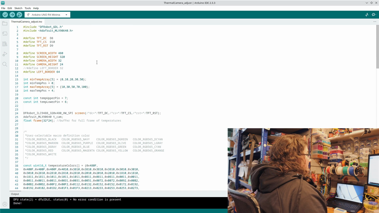

The firmware was developed using the Arduino IDE, combining display libraries from DFRobot with thermal imaging support from the Adafruit MLX90640 library.

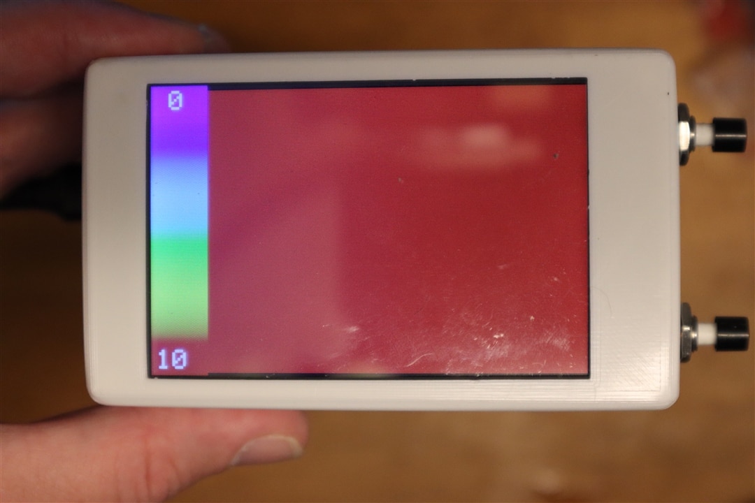

Rather than relying on a fixed colour scale, the software introduces configurable temperature limits and colour mappings. Arrays define selectable temperature bands and associated palette values, allowing the display range to be adapted to different inspection scenarios.
"I've made an array of temperatures that I think would be nice to choose between for the minimum and for the maximum."
A significant enhancement beyond the initial proof-of-concept was the addition of a graphical reference scale. Alongside the thermal image itself, the software generates a colour bar displaying the current temperature mapping and ambient reference point.
"I've made a little bar on the screen just so you've got something to reference."
This is particularly useful when comparing thermal scenes because colours alone can sometimes be misleading without context. Showing the active scale ensures that temperature differences remain meaningful as users adjust ranges.
The display rendering process converts each measured temperature into a colour lookup value and then expands the low-resolution thermal array into larger screen pixels.
"Displaying each pixel as 13 by 13 square."
This scaling approach preserves the sensor's underlying structure while making the image large enough to be useful on the handheld display.

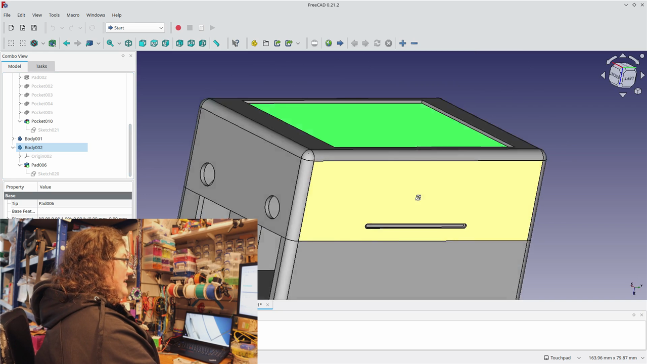

Custom Enclosure Development and Performance and Practical Applications
To transform the electronics into a finished product, a dedicated enclosure was modelled and 3D printed.
The housing was designed around the precise requirements of the hardware, including mounting locations for the Arduino, openings for the pushbuttons, accommodation for the acrylic display cover and a dedicated aperture for the thermal imaging sensor.
The enclosure design was created in FreeCAD, allowing dimensions to be adjusted until everything aligned correctly. Once printed, the finished parts closely matched the original CAD model and provided the foundation for final assembly.
The completed unit feels much closer to a commercial inspection tool than a development-board prototype, while still retaining all of the flexibility of an open-source design. The finished camera provides a useful way of visualising heat loss, identifying hot components and locating unexpected temperature variations. Like many MLX90640-based systems, it operates at relatively modest frame rates due to the amount of processing required to convert raw sensor data into temperatures and rendered images.
Even so, the camera is perfectly capable of highlighting thermal differences across surfaces, electrical equipment and household environments.
"It'll give me an idea of just what temperature something is with a visual graphic of where that is."
For energy-efficiency surveys, that means doors, windows, insulation gaps and draught-prone areas become immediately visible. For electronics work, it offers a way to identify unexpectedly hot components and thermal bottlenecks without specialised commercial equipment.
