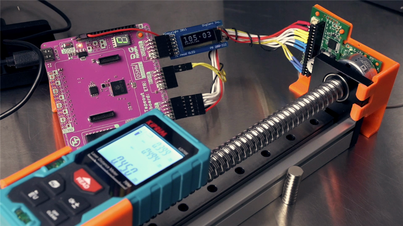

The demonstration centred on a linear positioning table driven by a ballscrew with a pitch of 5 mm per rotation. A battery-powered deployment was envisioned where equipment could spend most of its life sleeping, yet still wake up and immediately know its location regardless of movement while power was removed.
"No power, but no homing sequence and no constant recalibrating. Just always works, reporting position the instant it's turned on."

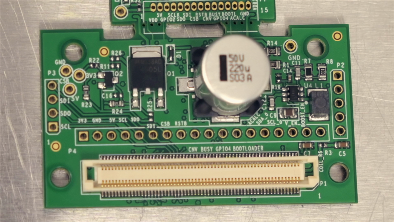

The ADMT4000 evaluation kit consists of two board sections. The upper section contains the sensor itself and can be detached from the main evaluation platform, while the lower section provides development and support circuitry.

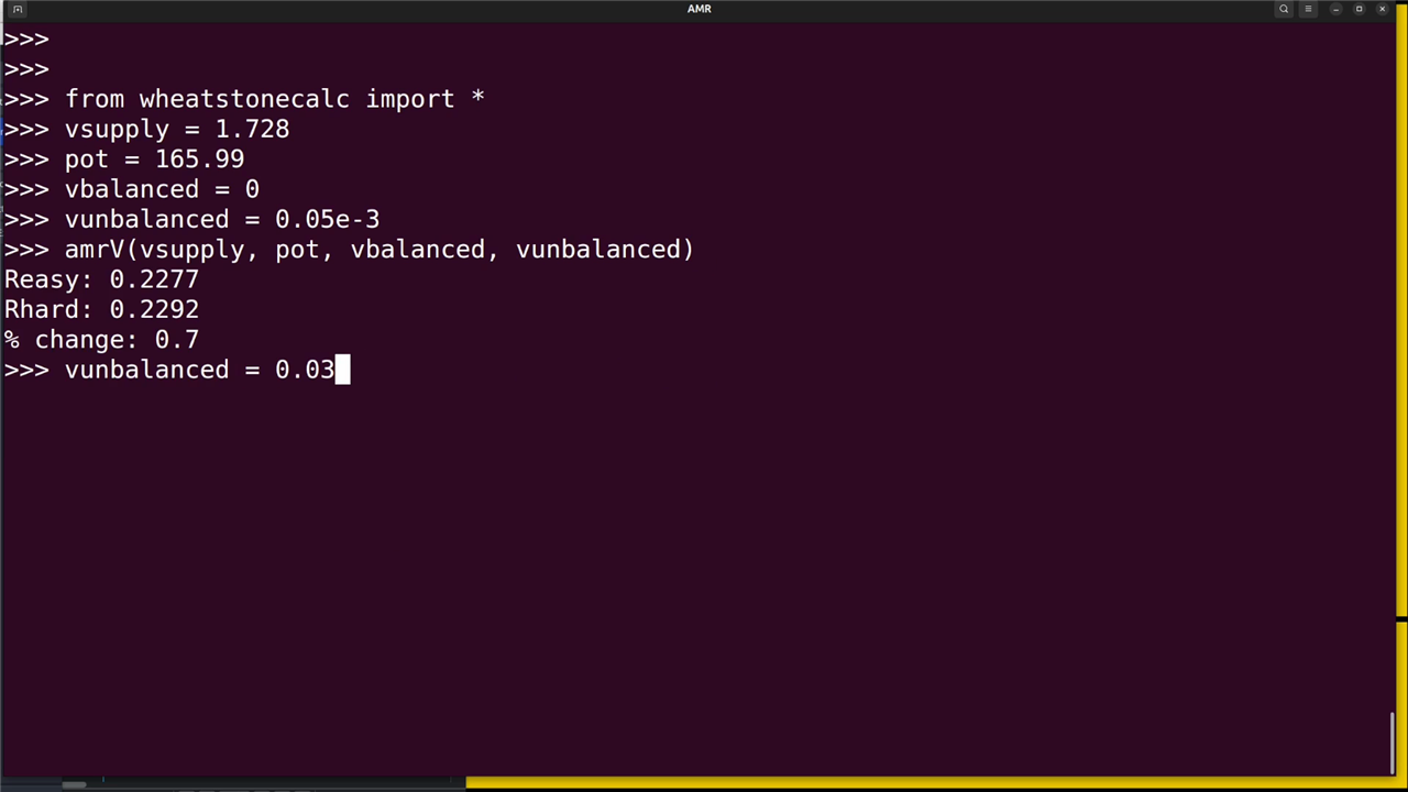

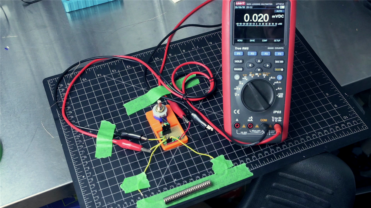

To better understand AMR, an experiment was created using a section of nickel-based guitar string, a Wheatstone bridge circuit and a collection of strong magnets.
The setup attempted to observe the tiny changes in resistance that occur when magnetic fields alter electron scattering inside ferromagnetic materials.
"We're demonstrating AMR, a quantum effect, in this little piece of guitar string with just a regular DMM."
The measured change was estimated at approximately 0.4%, corresponding to only a fraction of a micro-ohm. Despite the extremely small magnitude, the Wheatstone bridge arrangement successfully revealed the effect.
This experiment provides an accessible demonstration of the same physical phenomenon the ADMT4000 exploits to determine angular position.

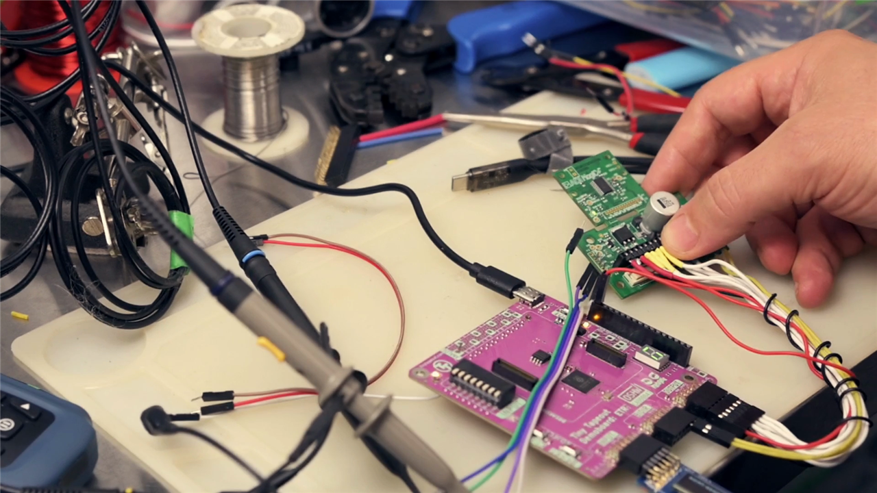

Debugging an Unexpected Hardware Issue
Bringing the sensor online was not entirely straightforward.
Initially, communication appeared unreliable. Sometimes the device responded perfectly. At other times it appeared completely dead.
Early suspicions focused on wiring, firmware and SPI timing. Oscilloscope measurements confirmed data transmission was occurring correctly, yet valid responses were inconsistent.
Careful examination of the schematics eventually revealed the root cause.
Several identically labelled SPI signals on the evaluation board were not actually connected together. Communication paths routed through an analogue switch controlled by the SDP interface hardware.
"I was sending the data, but just not getting anything back."
Once the analogue switch was bypassed with jumper wires connected directly to the sensor section, communications became completely reliable.

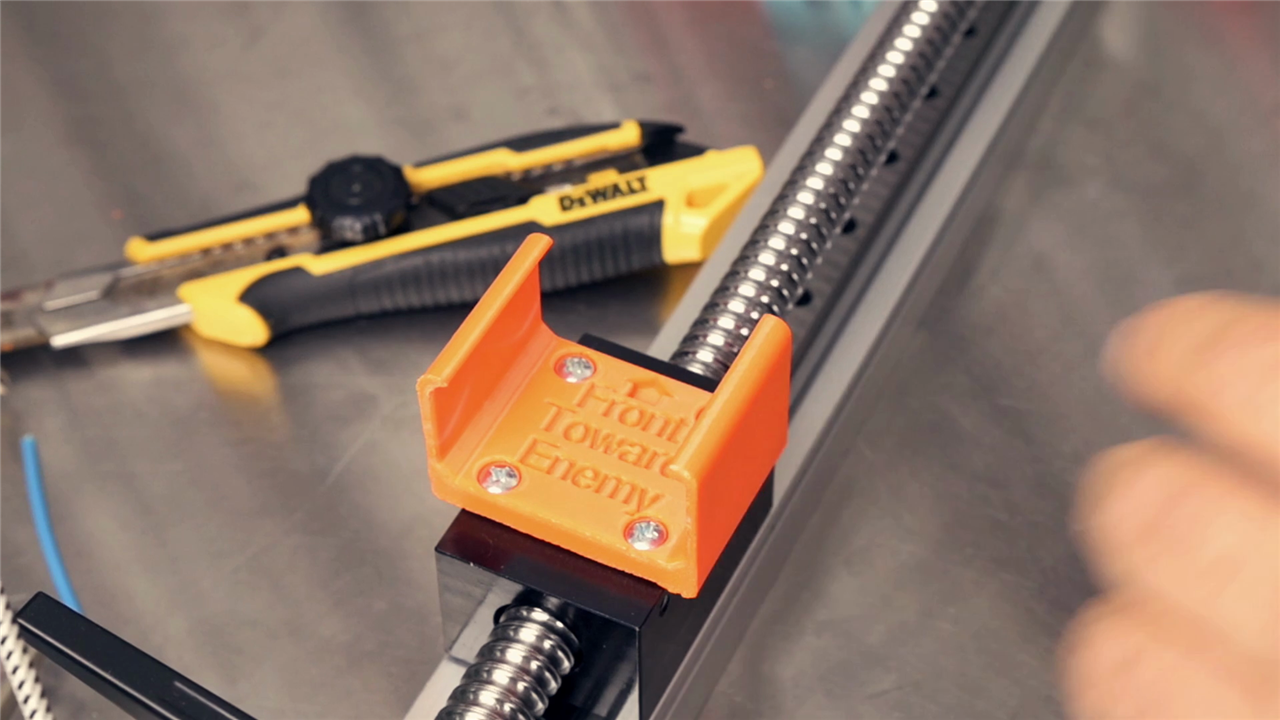

Designing Custom Mechanical Parts and Accuracy Testing
Although the evaluation kit provides its own magnetic assemblies, incorporating them into a practical mechanism required additional hardware.
OpenSCAD was used to design a shaft adapter that couples the supplied magnetic assembly to the ballscrew. A separate support bracket was designed in FreeCAD to hold the evaluation board, maintain sensor spacing and provide attachment points for the magnetic shielding ring.
The finished components are available as downloadable 3D models and make it considerably easier to integrate the evaluation hardware into experimental setups.To validate the system, measured travel was compared against readings from a laser distance meter.
With a 5 mm pitch ballscrew, ten complete turns should produce exactly 50 mm of travel.
The measured displacement matched expectations, demonstrating that the sensor correctly tracked angular position across multiple revolutions while translating it into useful linear movement.
The ADMT4000 ultimately offered substantially finer resolution than the laser distance reference being used for verification.
