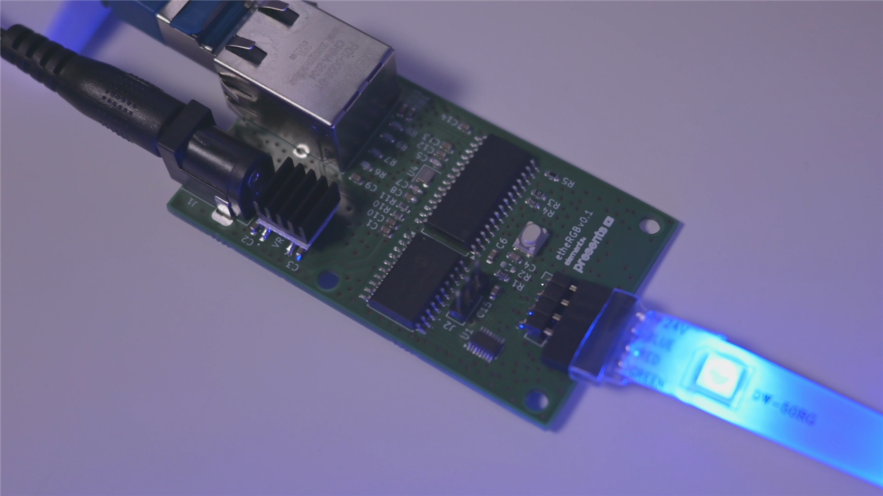

The heart of the project consists of an ATtiny3226 paired with an ENC28J60 Ethernet controller. The choice is interesting because neither component is especially new or fashionable.
The ENC28J60 communicates over SPI, making it ideal for small 8-bit microcontrollers. While newer Ethernet devices are available, the chip benefits from years of community support, mature software libraries and a well-understood design process.
The firmware itself deliberately avoids complexity. Rather than embedding application-specific logic into the controller, the device simply accepts colour commands over the network.

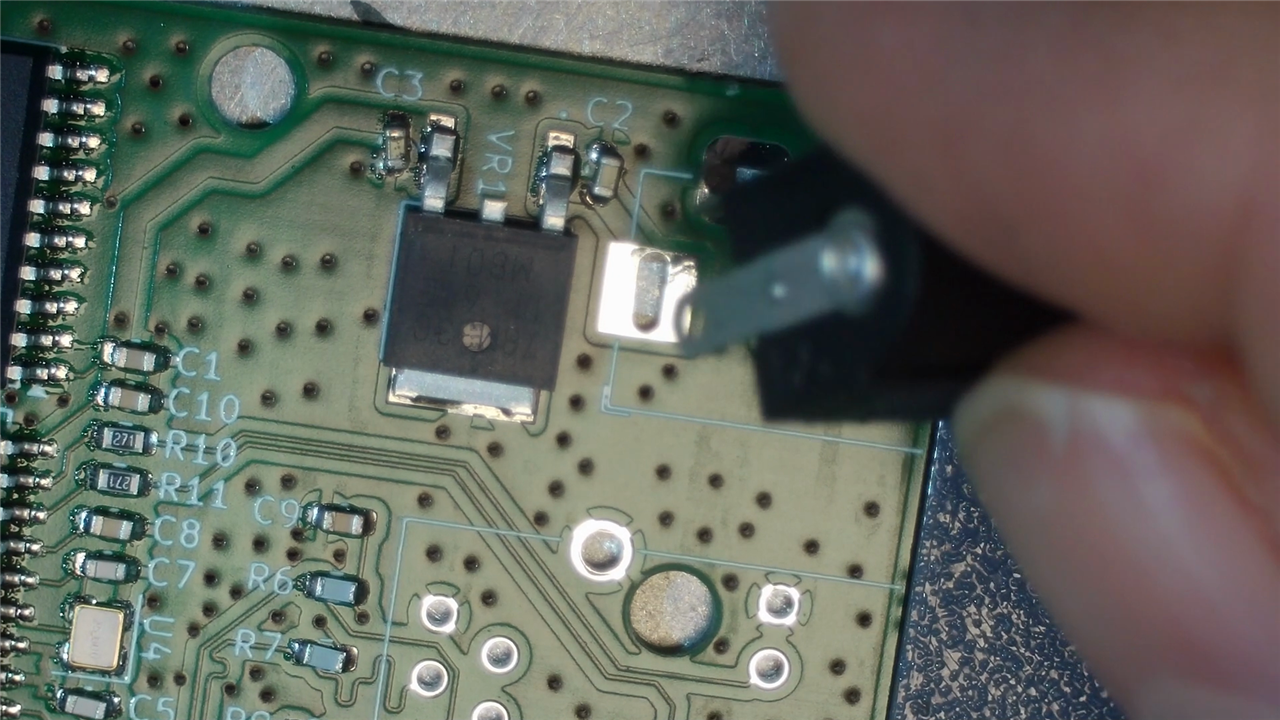

Why an LDO Won the Design Review
Another notable design decision concerns power regulation.
Most modern projects would default to a switching power supply for efficiency reasons. Clem chose a linear regulator instead.
At first glance this appears inefficient, but his reasoning is grounded firmly in practical engineering considerations.
The controller must operate across the voltage range commonly found on RGB strips, reaching up to approximately 24 V input. Using an LDO allowed him to reduce this voltage to the 3.3 V required by both the microcontroller and Ethernet hardware with minimal design complexity.
More importantly, it eliminates another potential source of debugging headaches.
As Clem notes:
"It avoids having to debug any interference issues between the switching and my Ethernet lines. So those could couple in and I'm not ready to debug that yet."
For a prototype that isn't intended to run continuously, the additional efficiency of a switching supply simply wasn't worth the additional cost, complexity or potential EMI concerns.

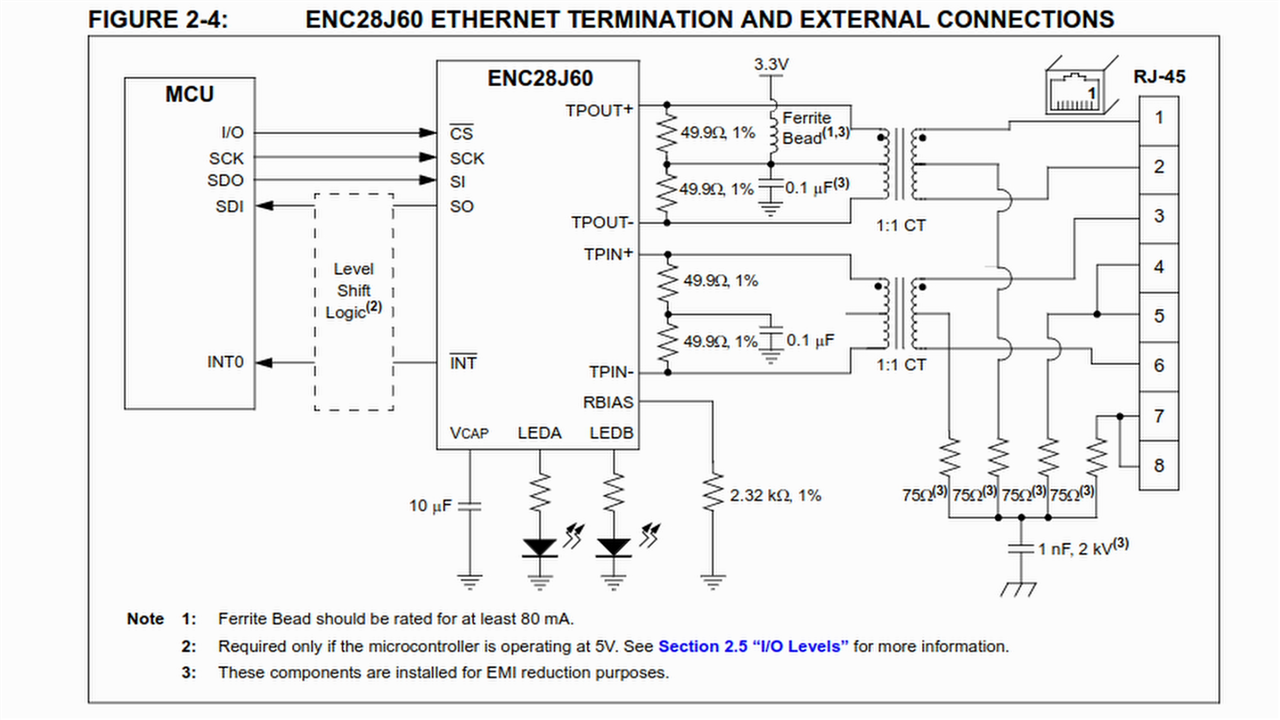

Ethernet Is More Than Just An RJ45 Socket
One of the lessons reinforced throughout the project is that Ethernet hardware demands attention to detail.
Connecting an Ethernet controller directly to an RJ45 connector is not sufficient. Ethernet requires isolation transformers, termination networks and supporting circuitry to meet signalling requirements and maintain reliability.
To reduce complexity, Clem selected a BEL MagJack, integrating the Ethernet magnetics directly into the connector assembly. This significantly reduced component count and simplified PCB layout. The MagJack used in the design appears in the BOM as part number P01-0002-01.
During the PCB routing stage, the differential Ethernet pairs required careful handling:
"You have to route them as pairs in KiCad and tune their length to each other so the signals take the same time to travel the distance."
Although the trace lengths on this design were relatively short, the project serves as a useful demonstration of real-world differential pair routing practices.

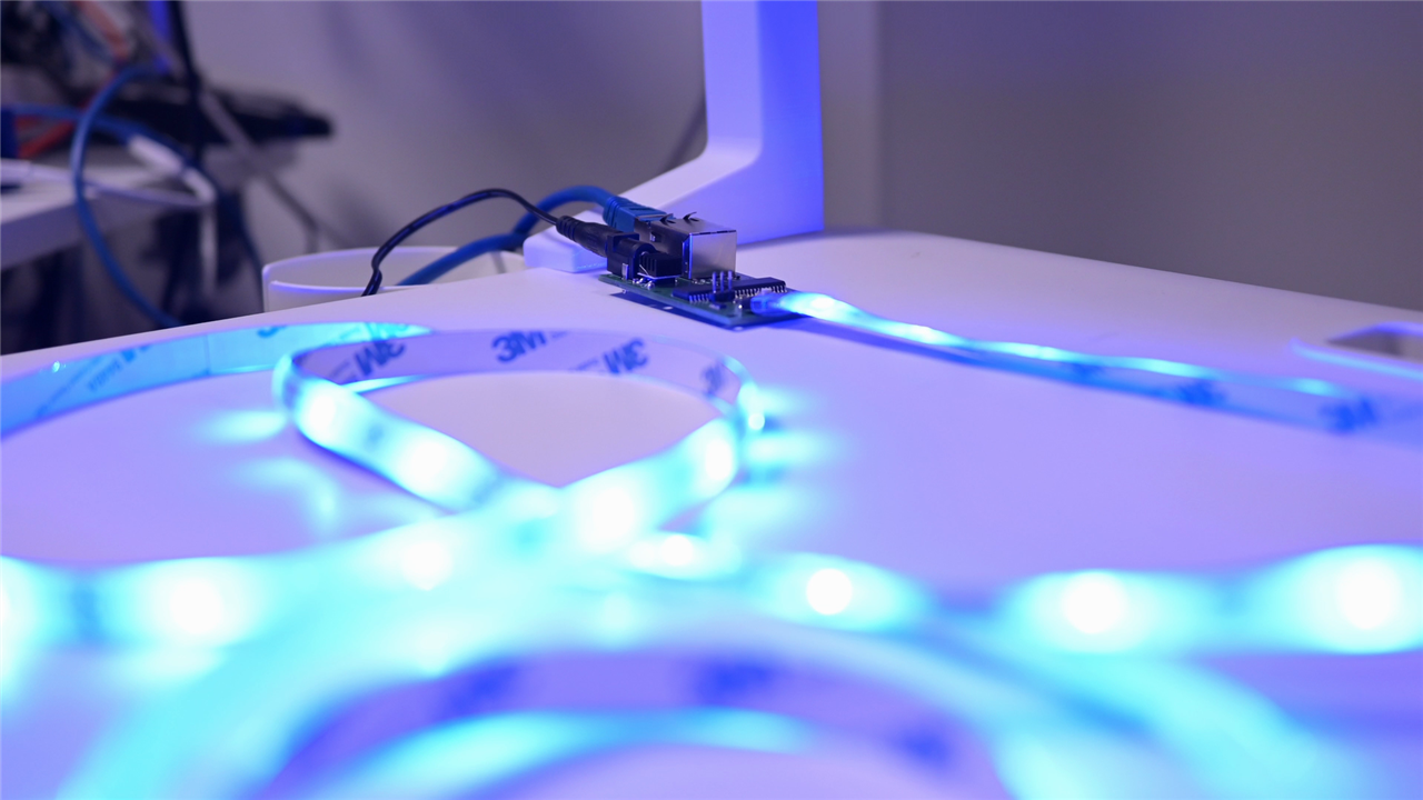

Turning LEDs Into Debugging Tools
One particularly elegant feature of the project is the diagnostic system.
Without a dedicated serial interface available, the LEDs themselves became the debugger.
The controller communicates its status entirely through colours:
  • Red indicates communication failure with the Ethernet controller.
  • Blue indicates Ethernet hardware is present but has not connected successfully to the network.
  • Green indicates successful operation and network connectivity.
When the board stubbornly remained blue, considerable effort went into investigating software, networking and protocol issues before the real problem emerged.
A bad solder joint.
After extensive experimentation, reheating and reflowing the board solved the issue completely.
The experience serves as a familiar reminder that sophisticated faults often have surprisingly simple causes.

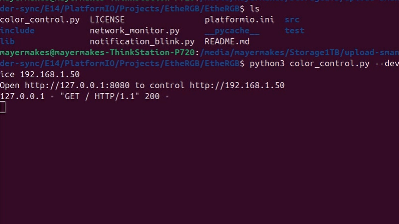

Software That Lives Outside The Device
A particularly clever architectural decision was keeping application logic away from the firmware. The project downloads listed in the support files include:
  • color_control.py
  • network_monitor.py
  • notification_blink.py
The browser-based colour controller provides a lightweight web interface for selecting colours and sending them directly to one or more EtheRGB devices.
Beyond that, Clem created two more practical demonstrations.
The first monitors network traffic and visualises network activity through colour changes.
The second watches Ubuntu desktop notifications and causes the strip to blink whenever a notification appears.
"You don't have to log into your applications or have to use their weird API. You can just use a little function in Ubuntu itself."
Because all application logic exists externally, additional uses become straightforward to develop. CPU utilisation, GPU activity, build completion alerts, server monitoring and workflow notifications become simple software exercises rather than firmware modifications.
