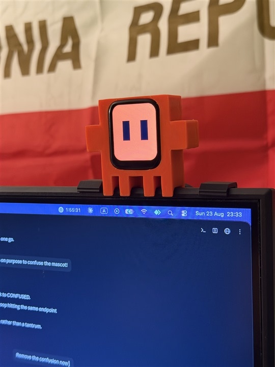

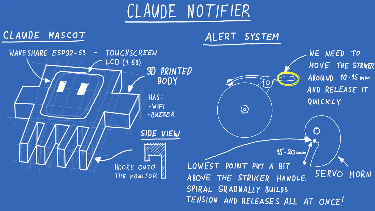

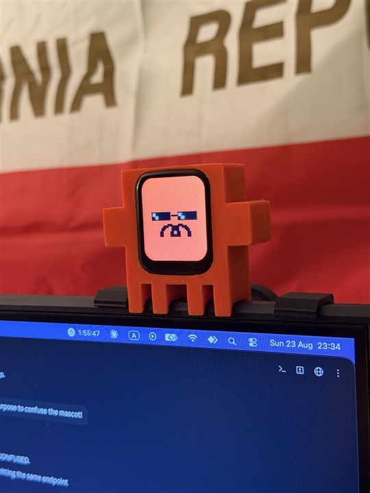

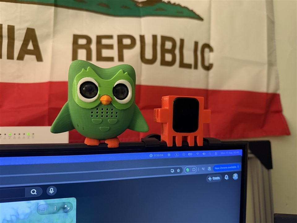

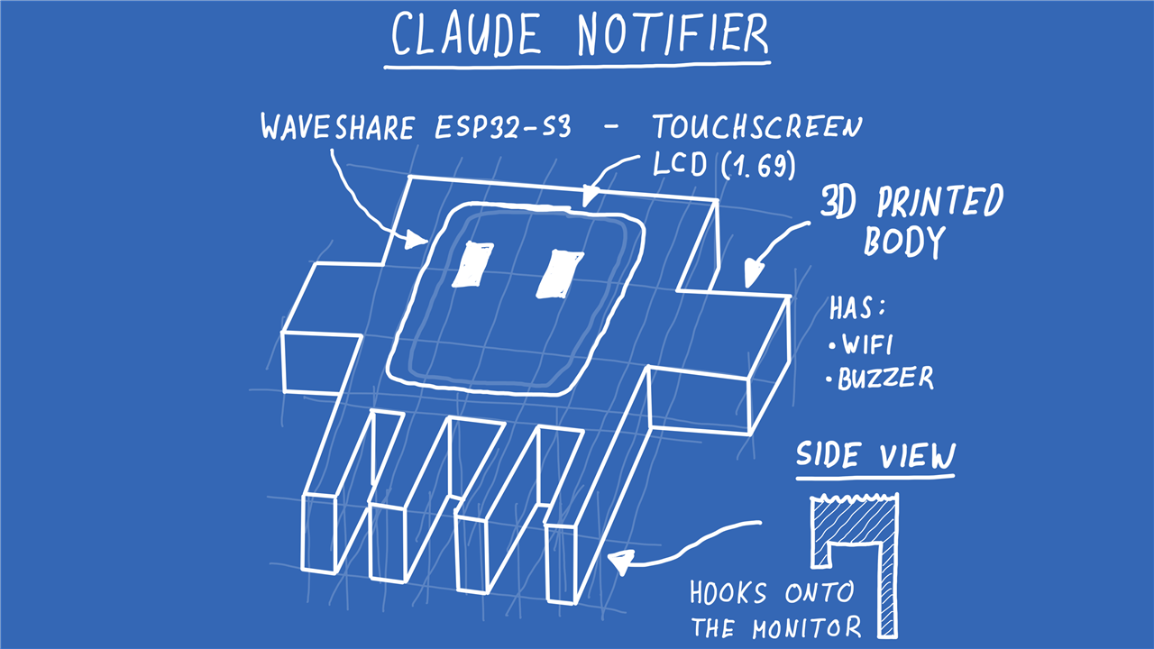

The physical design deliberately mirrors the small crab-like mascot used by Claude Code. The body is fully 3D printed, with the display fitting neatly into the centre of the enclosure and hooks built into the legs allowing it to hang directly from the monitor.

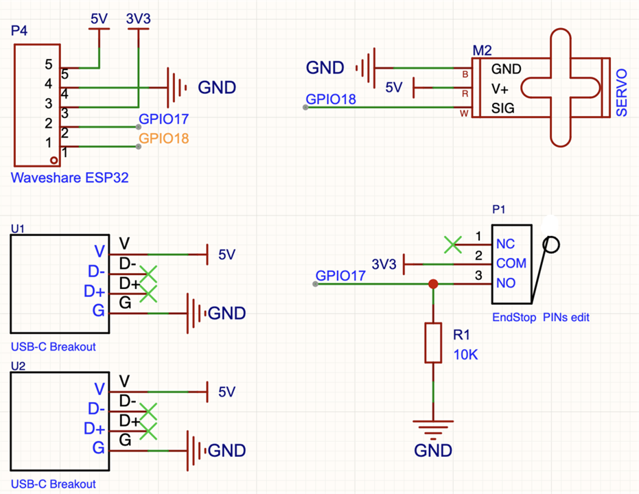

To keep the hardware as compact as possible, Milos used a Waveshare ESP32-S3 Touch LCD board with a 1.69-inch touchscreen. The module combines Wi-Fi connectivity, a colour display, touch input and a built-in buzzer, giving the project almost everything required on a single board.
"It's a great all-in-one board that also has a piezo buzzer inside. It also has Wi-Fi, so it will cover all of the functionality that we need."
The finished design routes everything through a single connector and includes a dedicated opening for USB programming access, allowing firmware updates without removing the electronics from the enclosure.
Four M2 fasteners secure the shell together, while internal mounting points ensure the ESP32 board slots neatly into position. STEP files are also provided with the project, allowing builders to customise the design for different monitors and mechanical preferences.

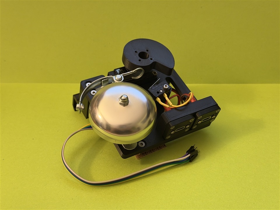

A separate bell-striking mechanism was designed using a continuous rotation servo, a custom printed cam and an actual mechanical bicycle bell.
"We need something a bit more diabolical, something a bit more loud, something that will actually stop you from doom scrolling."
The bell mechanism works by using a spiral-shaped cam attached to the continuous rotation servo. As the servo rotates, the cam gradually builds tension on the bell striker before suddenly releasing it. This creates a clean, satisfying ring using the bell's original striking mechanism rather than a solenoid or linear actuator.
Describing the design, Milos explains:
"As the servo motor rotates, it gradually builds up tension, and in the end it releases all of that tension."
The hardware uses a microswitch to detect the striker position, allowing the firmware to count completed bell strikes accurately and stop at the correct location rather than relying entirely on timed movement.
The final bell assembly also contains USB breakout boards that allow power to be daisy-chained, making cable management much easier when mounted on top of a monitor.

The most charming aspect of the project is how much personality has been built into the device. The touchscreen allows users to change faces and interact directly with the mascot. Different expressions appear when Claude is working, sleeping, confused, excited or waiting for input. The facial system is considerably more advanced than a few static images. The firmware animates eye movement, blinking, sleeping behaviour, boredom, excitement and even annoyance.
If the mascot is tapped repeatedly, it eventually loses patience.
"If you try annoying it a bit... you can see that it gets pissed off and it rings the bell at you."

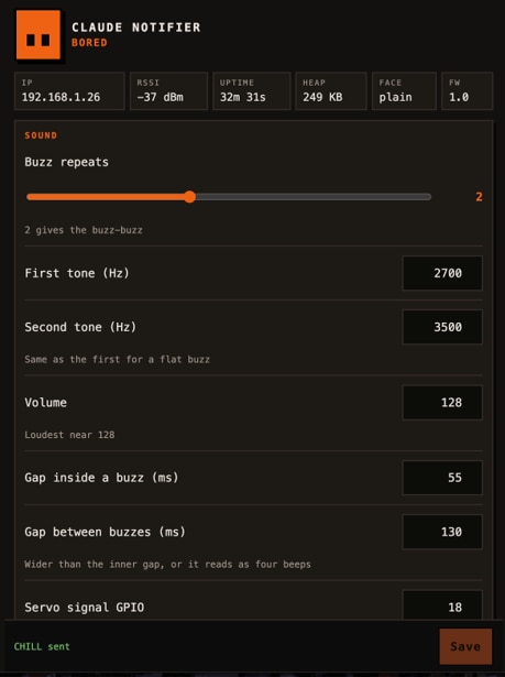

The web interface allows virtually every aspect of the experience to be customised, including:
  • Buzzer frequencies
  • Bell behaviour
  • Servo configuration
  • Face styles
  • Mood testing
  • Brightness levels
  • Network settings
  • Custom artwork

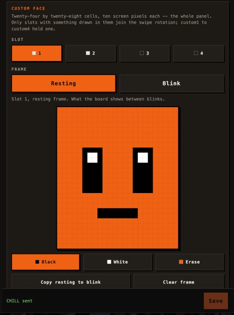

One standout feature is the built-in face editor. Users can design entirely new expressions using a pixel-art interface and save them directly to the ESP32's non-volatile storage.
The implementation supports multiple user-created face slots, custom blink frames and persistent storage that survives power cycles.
The firmware comments neatly summarise the philosophy:
"A drawn face gets the same mood vocabulary as a built-in one without the user drawing a single extra frame."

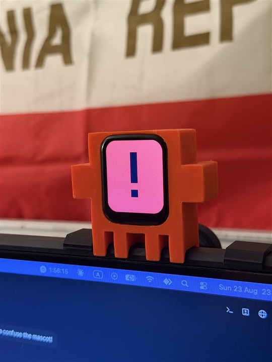

Once configured, the notifier operates automatically. When Claude finishes a task, the mascot becomes visibly excited. When an error occurs, it looks confused. If rate limits are reached, the display switches to a dedicated warning state. Most importantly, when Claude requires user input, the notifier demands attention with both visual and audible alerts.
"This will for sure stop the doom scrolling."
Whether it's the animated expressions, the touchscreen interaction or the mechanical bell that sounds suspiciously like fresh cookies emerging from the oven, the device succeeds at grabbing attention without requiring another browser tab or desktop notification. The finished Claude Notifier is a wonderful combination of software engineering, embedded systems, CAD design and a healthy sense of humour. It transforms a very modern problem into an excuse to build expressive hardware, and in doing so turns an AI coding assistant into a desktop companion that feels oddly alive.
