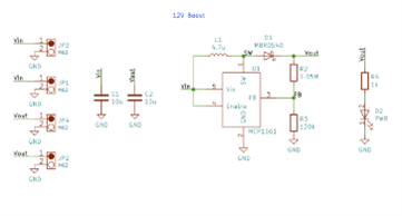

5v to 12v Boost
Product NameManufacturerQuantity
Product Link
C0805C106K4PACTU -  Multilayer Ceramic Capacitor, C Series, 10 - F, - 10%, X5R, 16 V, 0805 [2012 Metric]KEMET1Buy Now
MBR0540 -  Schottky Rectifier, 40 V, 500 mA, Single, SOD-123, 2 Pins, 620 mVON1Buy Now
4.7uH 0805 Inductor 600mATaiyo-Yuden1Buy Now
DC-DC Boost, SOT-23-5, 200mA outMicrochip1Buy Now

12 V BoostBreadboard Circuits

    Fred27 over 8 years ago +1
    "Why are you using 2 microcontrollers?" (14:28) That's exactly what I was wondering. The MSP430FR2633 can easily do what the Arduino was doing, saving you power, components and the need to generate 5V…
  • jwore
    jwore over 8 years ago +1
    thanks for including the parts list, can't wait to go buy that $15,000 oscilloscope so I can try this project at home
  • Fred27
    Fred27 over 8 years ago in reply to jwore +1
    That is a great oscilloscope, but a DS1054Z (or a logic analyser) would do the job too.

    baldengineer over 8 years ago in reply to Fred27
    I would have ended up with 5 volts anyway. The PowerBoost is my go to LiPo controller. Also, the 12v boost converter I had really struggled with the solenoid’s peak current when it’s input was directly off the battery. Putting two boost converters (3.7 to 5 and 5 to 12) in series let me use what I had on-hand.
    As for the the two micros, look at my reply to DAB.
