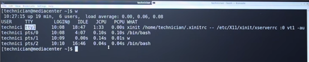

Felix demonstrates how to switch between different virtual consoles. From command line he types "W" which allows him to see which user is logged into which console. The screen shows that the only virtual console that’s active is tty1:
On this particular machine there are six different virtual consoles that are setup.  To switch between them you simply hold down “ctrl alt” and then press either function key 1 through function key 6 sequentially.  To go from tty1 to tty2 simply hold down “ctrl alt” and function key 2.

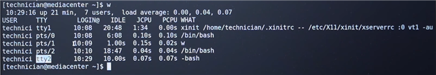

Hitting “control alt” and then function key 3 gives you tty3. After demonstrating this with all six virtual consoles he goes back to tty2 and logs into it. Felix goes back to tty3 and logs in as a different user.
Next, Felix goes to Virtual Console 2 and instantiates another instance of the graphical environment. To do this he types startx and this gives him a whole new desktop that is completely different from the previous desktop.  Anything they do on the graphical environment that they’ve instantiated on virtual console 2 will be completely independent from anything they do on virtual console one.  A practical instance of this would be if someone wanted to set up a machine to do multiseat.  Multiseat is sort of like multihead except the difference is that there are multiple monitors connected to one computer but at each monitor there is also an addition of input devices like a keyboard and mouse. So there’s multiple keyboards and monitors, maybe even audio devices, all connected to one computer, and then it would essentially function as a mainframe did a long time ago.
