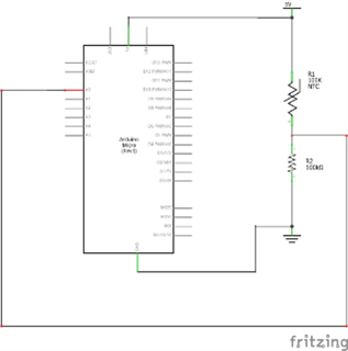

DaftMike builds a thermometer using an Arduino and a thermistor.  He’ll write some Arduino code, build a circuit, and then convert the values into a temperature reading.  He’ll use an NTC thermistor as a sensor. This is a special type of resistor whose resistance changes with temperature. In order to read it with an Arduino he’s going to build a circuit on a breadboard.  This will require some wire and a 100K resistor.

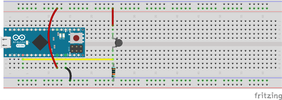

For this project, DaftMike will use an Arduino MicroArduino Micro because it plugs directly into the breadboard but you can use any Arduino you like. He uses wire to connect 5 volts to the top power rail and ground to the bottom power rail. There are usually multiple ground pins (marked ‘GND’).  You can connect to any of these.  He connects the thermistorthermistor to 5V and in the same column he connects the resistor to ground.  It doesn’t matter which way around these components go, they work either way.  Finally, you connect midpoint to analog pin p0.   You can now write some code:

DaftMike gives a diagram of the circuit. It’s a voltage divider where R1 is the thermistor and R2 is 100K. The equation for voltage dividers is Vout = Vin *R2/(R1+R2).  Vout is what we measured in the code, Vin is 5 volts, R2 is 100K, and R1 is what we are solving for.
