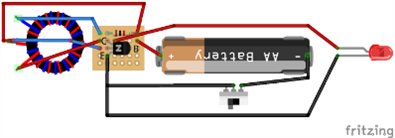

Learn how to get more bang from your battery by using an inductor to make a battery juicer that can run a flashlight off a single, used battery.

    jw0752 over 7 years ago +6
    Hi Karen, Most switch mode power supplies have a common mode inductor on their power inputs to minimize EMI. I mention this as they are a good source for the toroidal transformers that you recommend for…
    jw0752 over 7 years ago in reply to DAB +4
    Hi DAB, Here is a situation similar to Karen's where I am soldering and connecting a resistor to a transistor on a piece of protoboard. I am open to learning from you how you would improve this technique…
    jw0752 over 7 years ago +4
    Hi Karen, I have been experimenting with the circuit and I found that the 2N2222 will allow the battery to be drained down to about 0.6 Volts. If on the other hand you use a Germanium NPN transistor the…

    makerkaren great episode, a useful example of these fundamentals. What controls the frequency of oscillation? Shouldn't there be a series resistor for the LED for when the battery is full?
    And a general thought, perhaps you could make the circuit long and thin and fit it into the battery case alongside the other battery.
    Hi Karen,
