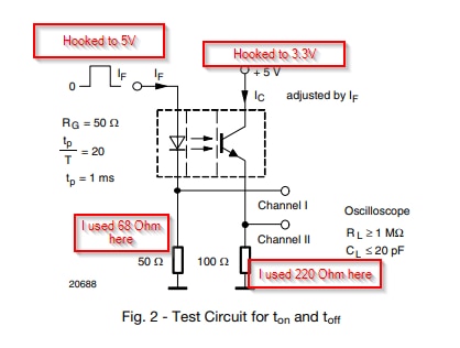

    for whatever reason, i'm still getting numbers all over the place. particularly when I put something blocking the beam, and leave it there. I did get my multiplexer boards, so today i'll be trying to get a pair of the tof sensors working at the same time.

    aspork42 over 5 years ago in reply to easyejl
    If you look at the schematic, you really only have an LED and a resistor in that part of the circuit; nothing else; not any more complicated than that. I really only chose 5v since that is what my breadboard had available right there. LEDs run fine on both 5 and 3.3 V.

    easyejl over 5 years ago in reply to aspork42
    the major standout difference I see from what I was doing is that you're using 5v for the emitter and 3.3 for the receiver which I hadn't been doing. about to try it.

  • aspork42
    aspork42 over 5 years ago in reply to aspork42
    Here's what I did.
    The output shown for 'channel II' gives either 0.03V or 2.8V. I then take it and push into a simple comparitor circuit with the op-amp to get 0 or 3.3V output.
    I am getting pretty good reads. It is surprisingly binary on/off. I’ll post the schematic for that part later today. I started by using the example circuit in the data sheet. Using one of the op-amps to make the signal 0-3.3 volts output.
  • easyejl
    Are you getting consistent reads from the photo interrupter? If you are, let me know what you're using for pull down as mine is all over the place.
