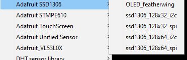

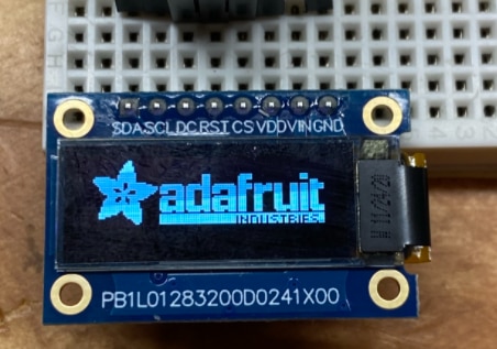

    Hi there - is anyone out there having issues getting their screen to work?
    im trying with I2C and it doesn't show up on the bus (3.3 v from the MKR). I noticed the back of my board says 5V Supply so I also tried with a level SHIFTER and putting all signals at 5v. Using the Adafruit library SSD1306.h with SSD1306 drivers.
    Data sheet mentions the other pins, but seems like I shouldn't need them with I2C.
    sneak preview of the breadboard stage...
    • Vote Up +5 Vote Down
  • kmikemoo
    kmikemoo over 5 years ago in reply to aspork42
    aspork42  It's SPI.  I used the Adafruit library, but opted for the hardware SPI instead of the default software SPI.  This left the I2C open for the TOF sensor.  If there's a way to convert it to I2C, I haven't stumbled across it.
  • aspork42
    aspork42 over 5 years ago in reply to kmikemoo
    They are right next to each other in the examples:
    And this is pretty confusingly marked, not with MISO/MOSI/SCLK/CS as normal for SPI. Instead we have SDA and SCL which seem to indicate I2C.
    At any rate, I was able to get it running via SPI as you noted (and 3.3V). Thanks for the response image

  • beacon_dave
    beacon_dave over 5 years ago in reply to aspork42
    "...And this is pretty confusingly marked, not with MISO/MOSI/SCLK/CS as normal for SPI. Instead we have SDA and SCL which seem to indicate I2C..."
    It looks like the controller used supports both.
    https://www.midasdisplays.com/getmedia/f3485ee8-9e11-41fc-809f-2afd900c2651/SSD1306BZ.pdf?ext=.pdf

  • easyejl
    easyejl over 5 years ago in reply to beacon_dave
    In theory sure, but the description in their docs is confusing, at least to me.
    It is nice that the mkr has that connector for a 2nd i2c channel but I ordered a multiplexer anyhow.

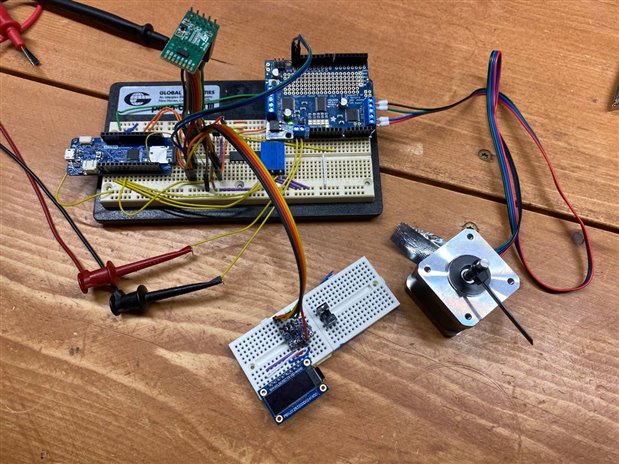

  • aspork42
    aspork42 over 5 years ago in reply to easyejl
    I've got basic communication with all the devices at this stage - temperature sensor, photo-interrupter, screen, distance sensor. Using the op-amp for some signal conditioning. Have a few more things to do still though... I have some cool things planned right now, but don't want to give it away.
    I was playing with the stepper motor and was able to get it to turn to indicate the temperature, and turn based on the distance read for the distance sensor. I've got everything except the screen all inside of one sketch. Just got the screen going the other day so need to roll that in. After that I have mechanical build to do image
    Debating making a circuit board to clean things up... but don't really like using the stepper; should really have a servo for what I'm doing.

  • aspork42
    I am getting pretty good reads. It is surprisingly binary on/off. I’ll post the schematic for that part later today. I started by using the example circuit in the data sheet. Using one of the op-amps to make the signal 0-3.3 volts output.

  • easyejl
    easyejl over 5 years ago in reply to aspork42
    the major standout difference I see from what I was doing is that you're using 5v for the emitter and 3.3 for the receiver which I hadn't been doing. about to try it.
    Oh and just as a funny thing I noticed, you can't have Cura running and the Arduino IDE at the same time and have the arduino IDE work correctly. Took me a while to work that out image
  • aspork42
    If you look at the schematic, you really only have an LED and a resistor in that part of the circuit; nothing else; not any more complicated than that. I really only chose 5v since that is what my breadboard had available right there. LEDs run fine on both 5 and 3.3 V.
