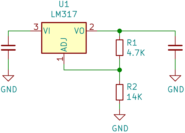

On some linear regulators, you have access to that feedback network through a pin called "Feedback" or "Adjust." As an example, the LM317 LM317 is an adjustable regulator. It has three pins: input, output, and adjust. It is possible to "set" the output voltage to anything between 1.25 and 37 volts by using a voltage divider. Remember that reference voltage of 1.25 volts mentioned a moment ago? It comes into play with adjustable regulators.
The output voltage divider creates a voltage drop across R1 that is the difference between the desired output and the reference voltage. In the case of the LM317, it is 1.25 volts! From a user's perspective, that reference voltage only matters because you use it along with Ohm's Law to set the output voltage.
When you look at an LM7805LM7805 or the more modern NCP1117NCP1117, these regulators have the feedback network integrated into their silicon. That is the only significant difference between a fixed and adjustable linear regulator.

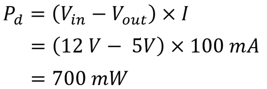

One way to think of linear regulators is that they are voltage-controlled resistors. The regulator adjusts its practical resistance so that the voltage on the output node is at the desired level. This model also explains why linear regulators are so inefficient: they drop the voltage difference from input to output, like a resistor. Since the current going in is the same as the current going out, it is easy to calculate the linear regulator's power dissipation.
For example, a 5 volt NCP1117NCP1117 with 12 volts in and 5 volts out creates a 7 volt drop across the regulator. With just 100 mA of current, the regulator would have to dissipate 700 milliwatts. Another way to look at the conversion, it is only 40% efficient at delivering power to its load!
If you need the linear regulator is going to dissipate around 1 watt, you should consider a TO-220 or DPAK package. With the TO-220, I would still recommend a heat sink. And with the surface mount DPAK, make sure the PCB has a large copper fill connected to the package's tab.

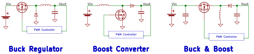

Switch mode Power Supply
A switching supply has an entirely different architecture compared to the linear regulator. Switching supplies, or "switchers," make use of the energy storage capabilities of capacitors and inductors.
Capacitors store energy in an electric field. Inductors, however, use a magnetic field to store energy. By charging and discharging these devices, it is possible to create output voltages that are higher or lower than the input voltage.
In a switching supply, a transistor charges up an inductor and then allows the inductor to discharge. The capacitor smooths out the ripple created by this charge and discharge cycle. Depending on the capacitor and inductor configuration, this arrangement could increase (boost) or decrease (buck) the input voltage. Switching supplies can also do both, in which case, they are a boost-buck converter.
Another advantage of a switching supply is that they are incredibly efficient. In the linear regulator, the transistor is always on and always dissipating power. A switching supply's transistor is either ON or OFF. When it is on, it has milliohm resistance. When it is off, it is open. In both cases, the dissipated power is meager.
Neither the transistor, capacitor, or inductor is ideal. So all three have some losses associated with them. However, it is still possible to design a switching regulator where over 90% of the input energy gets converted to the output. Even a poorly designed switching supply might be at least 70% efficient. Not bad when compared to the linear regulator's 40% efficiency, eh?
The trade-off comes in the design process. Switch-mode power supplies are sensitive to values picked for the inductor and capacitor. You have to pay attention to characteristics like the capacitor's ESR. When laying out a PCB for a switching supply, you need to follow stringent rules. If not, there can be a large amount of ripple voltage, poor performance, and EMI issues from the switching elements. Fortunately, most switch-mode ICs have well-written application notes to describe their proper design.
