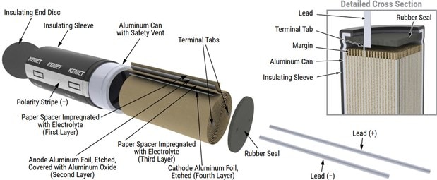

Example construction diagram from a 35V 100uF KEMET ESH35V 100uF KEMET ESH.
Why does ESR change?

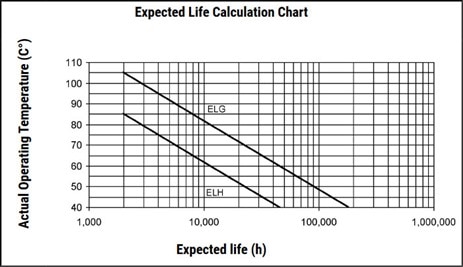

Aluminum electrolytic capacitors before the 1990s all used a liquid electrolyte in their construction. Over time that liquid dries out. Part of that dry-out is just from evaporation, but that isn't the primary contributing factor. We call it a liquid electrolyte, but it is more like a paste—an acidic paste. Its pH level has the unfortunate side-effect of breaking down the capacitor's dielectric layer. The good news is that as it breaks down, applied voltage causes the layer to re-grow. But how does it grow? Well, remember the dielectric layer is an aluminum oxide. Oxides need oxygen. That oxygen comes from the electrolyte.
Example Aluminum Electrolytic Lifetime Chart (also from KEMET ESH)
So the electrolyte both breaks down and reforms the dielectric layer. This process is the reason why aluminum electrolytic capacitors have a rated "lifetime" associated with them. Eventually, the electrolyte runs out of oxygen to contribute to oxide (re-)growth. At that point, the leakage current and its equivalent series resistance (ESR) becomes very high. After either of those parameters passes a limit, the parts are considered at parametric end-of-life.
By measuring either the leakage current or ESR of a capacitor, we can determine if it has reached its end of life or not. Also, depending on the data history available, you might be able to estimate its remaining life.

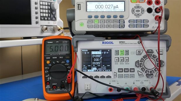

Measuring Leakage Current
When I can remove a capacitor from a circuit, I tend to use leakage current as a measure of its condition. This simple measurement only requires a power supply, multimeter and some patience. Ideally, the power supply should be able to limit the current. If your supply does not, then a resistor works fine. The multimeter’s purpose is to measure current.
In this video, The Learning Circuit 42: Replacing MLCCs with Polymer Capacitors , I show how to make this measurement.
Here are the steps involved:
  1. Limit your supply to less than 100 mA, 10 mA, or 1 mA. Pick the smallest value that your supply’s limiter can provide.
  2. Set the voltage to the capacitor’s rated voltage. (Another option is to set the voltage to the circuit’s applied voltage.)
  3. Connect the supply to the capacitor, with the multimeter in between to measure the current.
  4. Turn on the supply.
  5. Wait 5 minutes.
  6. Look at the current measurement.
If you measure an older capacitor, like those from vintage electronics, then I highly recommend starting with 25% of the rated voltage. After measuring the leakage at that level, increase by 25% until you reach the full rated voltage. If the capacitor’s dielectric is heavily damaged, even at 100 mA, there is enough energy for a catastrophic fail.
ESH Leakage Current Limits

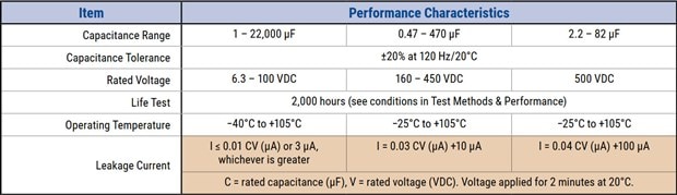

After 5 minutes, the capacitor is mostly charged. The current draw at this point is the dielectric healing itself. But what is a good value? Most capacitor datasheets specify the limit with some portion of their CV. For example, the ESH from KEMET says the max leakage current is 1-4% of the capacitance multiplied by the voltage. If you do not have a datasheet for a particular capacitor, 5 or 10% of the CV is a conservative guideline.
One thing to watch is what happens to that current over time. As the 5-minute mark approaches and then passes, the current should continue to go down, though at a much lower rate. A sign that the electrolyte may be near end-of-life is that the current stays relatively high. If that occurs, then the next thing you need to check is the ESR.

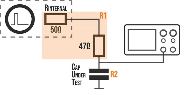

Measuring ESR with a scope (hard way)

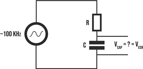

While leakage current uses simple tools, measuring equivalent series resistance (ESR) is a bit trickier. As I mentioned before, you’ll need a small AC signal. You might immediately think of a sine wave when it comes to AC, but really anything that has a changing component, aka dv/dt, works. For example, you can use a pulse from a function generator.
If you have an oscilloscope and function generator, the only other piece you need is a 47 ohm resistor. Ideally, you should use a 50 ohm precision resistor, but I’m not sure how many people have one of those laying around. For this measurement, you build an AC voltage divider where you measure the voltage drop across the capacitor. The voltage divider's R1 is 100 ohms and R2 is the capacitor under test. R1 is 100 ohms because the function generator has an output impedance of 50 ohms and I added a 47 ohm resistor. Using a bit of math, you can determine the ESR. I learned of this method from Geoff Graham.

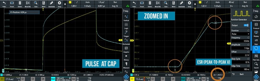

Measure ESR with Scope and Function Generator
For the AC signal, set the pulse generator to output a 0 to 10 V pulse with an on time of about 1 us. The off-time should be relatively long. You want a short pulse with a slow repetition rate. The idea is you want to quickly apply a voltage, see the instantaneous voltage drop, then let the capacitor discharge.
In my setup, depending on the capacitor, I could not always get my signals to swing from 0 V. So I used cursors to measure the peak-to-peak voltage from the starting level to the ESR voltage drop level. On the right screenshot I have zoomed in on the edge event and circled the peak-to-peak cursor points. This method introduces some inaccuracy, but it is good enough for an ESR estimation. (For slightly better accuracy, you may want to turn on waveform averaging.)
R2 = R1 × 1(VINVOUT −1) = 100Ω × 1(10V135mV −1) = 1.35Ω
Oh. Why did I pick 47 ohms? To make the math a little bit easier. The denominator result is 14.19, which when you multiply by 100 ohms comes out to 1.42 ohms. Thing is, because of the 100 ohm and the 10 volts, you just need to see the voltage across R2 and multiply that by 10 to get the ESR. In the end, though, it didn’t matter for me. I used a Math function on my R&S RTM3000 Oscilloscope to multiply the analog channel by a constant value, which did the math for me. That result is the 1.35 Ω value circled on the right screenshot.
The scope method to measure capacitor ESR is a qualitative measurement. It gives you an order of magnitude, but it is not a precise measurement. An LCR (inductor, capacitor, resistor) bridge uses techniques, like a bridge, to measure the ESR, so it is far more accurate. However, to validate if a capacitor is “good” or not, the scope works okay. The real downside is that it can be time-consuming to set up and do.

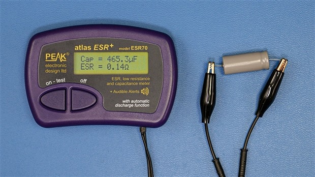

Measuring ESR with an ESR meter (easy way)

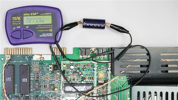

Alternatively, if you use a meter designed to measure ESR, the measurement process is laughably easy. One such meter is the Atlas ESR70 from PEAK Electronics. The element14 community generously sent me one along with a handful of caps to test with. You can see my review of the ESR70 here.
atlas ESR70 from PEAK electronic design
In the case of the ESR70, a capacitor’s ESR measurement displays first, followed by the capacitance. In my brief experiments, I found the measurement to be repeatable. I also found that the results agreed with the scope result. But the thing is, it took no effort to set up. I attached the cap, press on, and then get a number. Also, I did a quick in-circuit vs. out-of-circuit comparison. The ESR was slightly different but close enough to know the capacitor had not reached its end-of-life yet.
Overall for about $100, this meter is very handy. The scope method from above works fine in a pinch or if you need to make the measurement on occasion. In my case, I am always evaluating vintage electronics before powering them on. With the ESR70, I can quickly check all of the larger capacitors for more than just visual damage.

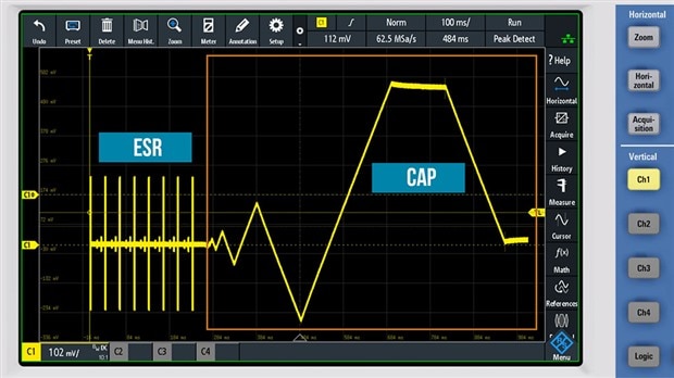

How does the ESR70 measure ESR then?

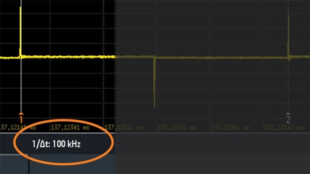

So now that I’ve shown you the manual method and a specialized tool, I wondered, what is the ESR70ESR70 doing to measure ESR. So, I hooked it up to my scope. In the screenshot below, I have the scope connected to the meter while measuring an axial aluminum electrolytic capacitor. I setup the scope to capture a single sweep across a couple of seconds so we see could the meter’s behavior.
ESR70's capacitor measurements
When it runs a test, there are two different modes. The first uses several 100 kHz spaced pulses to evaluate the ESR. Since I used such a long sweep, the sample rate reduced significantly. When I zoomed in on the ESR section, I just saw little spikes. I’m not sure if these are actually pulses or some other wave shape. Regardless, its the frequency that I was interested in seeing. Next, it charges up the capacitor to measure the ramp time to determine the capacitance.
One thing I haven’t done yet is comparing this waveform with capacitors of different ESR values, to see how the spikes change. I suspect the measurement is very similar to the scope and function generator method mentioned above.

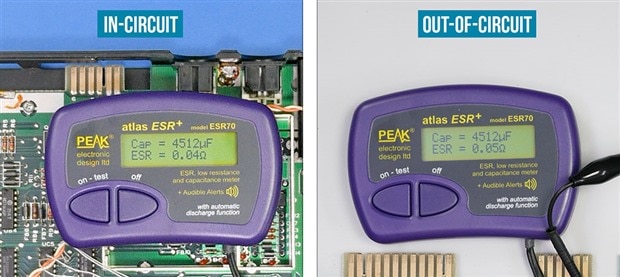

If you can remove the capacitor from the circuit, you should measure both to evaluate the capacitor fully. But if you cannot remove the capacitor, then you are limited to only attempting to measure ESR. Leakage cannot be measured in-circuit because it involves applying voltage to the capacitor. That voltage is going to end up powering-up the rest of the circuit.
The method used by an in-circuit tester like the ESR70 has a good chance at making the ESR measurement in-circuit. Other elements may affect its reading, but it should still at least give you a good sense for whether or not you found your problem.
