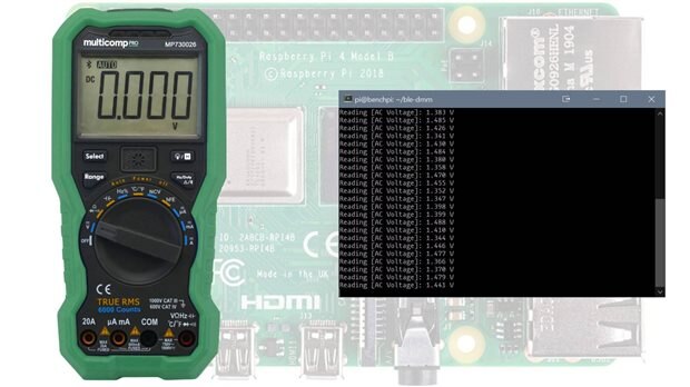

At a glance, the Multicomp Pro MP730026 seems like a typical DMM. And it is! It measures voltage, current, frequency, temperature (with included K-Type thermocouple), and even features a white LED to act as a work light. The non-typical feature that caught my attention is its Bluetooth Low Energy (BLE) support.
Overall I like the meter. It is an excellent general-purpose DMM. After using it for a couple of months, I have discovered only three things I dislike about it. The first is that it has no min/max function. The second is that it beeps loudly before turning off. My personal preference would be for it to shut itself off quietly. Neither of these is a dealbreaker, but you should be aware of them. The last one is a more significant issue. The compelling BLE capability I mentioned one paragraph ago is barely functional out-of-the-box. However, I found a solution!
The software provided by Multicomp Pro is disappointing. It only works with Windows and a very specific BLE dongle. My search for a cross-platform solution leads me to a Python-based solution. Thanks to a module called Bleak, it is possible to communicate with the MP730026 DMM on practically any BLE-compatible computer. I have had success on a Microsoft Surface Book, two Macs, a Raspberry Pi, and even an Arduino BLE Sense.

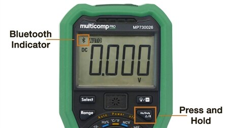

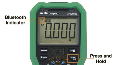

First, turn on the DMM and turn the selector to any mode. Enable Bluetooth by pressing and holding the Hz, Duty, Delta, Bluetooth button until the meter beeps. On the LCD's upper left-hand corner, the Bluetooth symbol starts blinking. When a device connects to the meter, the symbol stays on steady.
