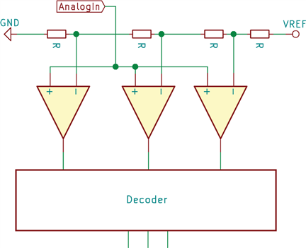

You can think of this method like a liquid thermometer. As the temperature goes up, the liquid inside rises to indicate the measured temperature. A flash converter does the same thing with a series of comparators connected to a voltage divider network. The voltage divider steps down a reference voltage by 2N. Each comparator represents one bit of resolution and compares the incoming signal to the divided values. One side of the chain is the maximum reference voltage, and the other is the minimum. The higher the voltage of the signal, the more comparators output a digital 1. A decoder is necessary to turn the highest "on-value" into a binary code.image
The flash converter's primary benefit is that changing the bit resolution does not impact conversion time. Since the comparators simultaneously see the reference voltages and the signal under test, their sampling time, or aperture, is small. It is difficult to achieve more than 8-bit resolution because of how well each comparator stage needs to match the other stages. Additionally, because each stage needs a precision resistor, a flash converter tends to be relatively large when implemented in an IC.
So, flash converters are well suited for high bandwidth applications where power consumption is not a concern. They excel at gigasample-per-second applications. These converters are excellent for waveform capture. Common applications are wide-band RF and test equipment.

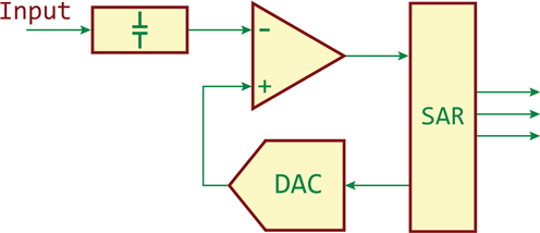

The successive approximation register (SAR) method is the most popular architecture. It provides a balance between sampling rate, accuracy, and power consumption. Most (or all?) microcontrollers with an ADC are using a SAR style converter. Their application, or usage, is slightly more complicated than a flash converter. In addition to the input analog voltage and output binary code, there are two digital control signals. An input signal tells the converter to start conversion, and an output signal from the converter indicates when the conversion finishes.
The way they work internally looks more complicated than a flash converter but they are related. A SAR contains, ironically, a digital-to-analog converter (DAC.) A circuit called the successive approximation register (SAR) generates digital codes that the DAC converts to an analog voltage. A comparator compares that voltage to the input signal.  The approximation register uses this comparator output and the history of bits used by the DAC to approximate the input voltage. This process takes several steps while the SAR "walks" through the tree. Because the conversion takes time, sometimes there is a sample-and-hold capacitor that takes a snapshot of the signal before conversation starts.
This method is why the SAR converter is slower than a flash converter. With only 1 comparator stage the SAR sequences the through multiple values to simulate the multiple stages of the flash converter. The size, and therefore cost, of an 8-bit SAR is much smaller than a flash. Additionally, adding more bits is somewhat linear with a SAR. This flexibility is why you see 12-, 14-, and 16-bit SAR ADCs.
SARs typically sample in the hundreds of megasamples-per-second range. Being the most popular architecture, they also tend to be the least expensive for a given sample rate and bit-width.

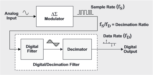

Higher bit-resolution is the primary advantage offered by delta-sigma. (Or you might see them called sigma-delta.) If a converter has 18- to 24-bit resolution, it is likely a delta-sigma design. The higher resolution does come at a design cost. When compared to SARs, delta-sigma converters are slightly more challenging to use. Of the three architectures discussed in the post, the delta-sigma is probably the least understood. It has a very different architecture from the other two types. At its core is a 1-bit ADC. (That is not a typo.) The rest of the ADC is digital. Here is a high-level block diagram of the delta-sigma converter.
Delta-sigma ADC block diagram, TI AN slyt423a.image
The 1-bit ADC is part of the modulator block. That block's purpose is to take the input analog signal and convert it into a train of digital pulses. For this converter to work, this sampling rate needs to be significantly faster than the frequency content of the incoming signal, which is known as oversampling.
Once converted into this pulse coded modulation (PCM) train, a digital filter is applied. Typically this filter is a form of averaging known as a sinc filter. (Although other filter types exist for different applications.) Next, the data goes through a decimation stage, which reduces the digital content to the minimum necessary to represent the original signal. One benefit of this approach is that any high-frequency noise introduced by the modulator stage gets thrown away.
In terms of size, a delta-sigma has very few analog (resistor) components. So they do not take up much silicon space. That size does not translate directly to cost since they are not as common as SARs. However, SAR and sigma-delta are rarely in competition with each other.
Delta-sigma converters have very high resolution, up to 24-bits, but do not offer much bandwidth. The low noise and high bit count of a delta-sigma converter make it ideal for applications like a Wheatstone bridge-based measurement or thermocouples. The signals in both examples have low bandwidth, and the precision matters more than the sample rate.

    In the flash section, what you call a 'decoder' I'd call an encoder (a priority encoder). I'd disagree slightly about the 'it is difficult to achieve more than 8-bit resolution'. When I started, even a six bit flash converter was amazing [and expensive], but later 10-bit and 12-bit were routinely being used for digital processing of analogue TV signals, 10-bit in consumer chips and 12-bit in studio equipment.
