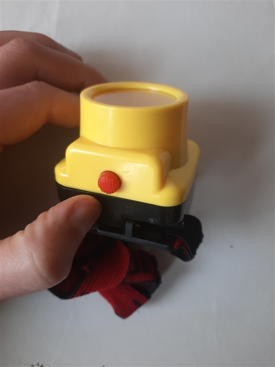

I made a little project that's more funny than scary, "The third eye!" . Unfortunately, I can't say that it makes me wiser () or that it helps me see better, but maybe it hypnotizes someone to give more candy (
I started with a head lamp housing which, as you will see, I found another use for. I thought about incorporating an 8x8 LED matrix and illustrating some animations, that being said, an animated eye seems like a good and effective idea, given the available components. At the same time, I was put in a difficult position on the one hand by space, on the other hand I also made a small mistake, accidentally while working on this project I realized that I didn't make a very good purchase with a module (a previous purchase of mine, you'll see later), and this could affect the completion of the project.

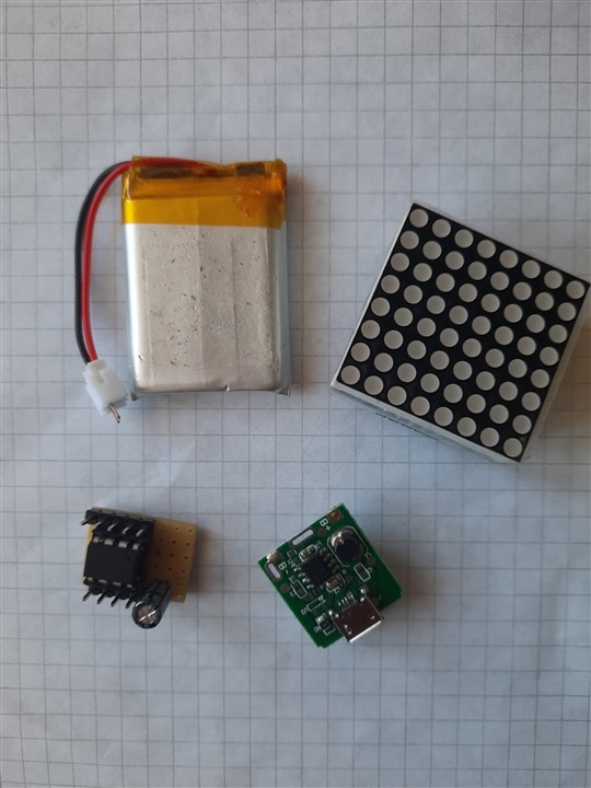

And now the list of components used:
• 1x head lamp housing;
• 1x 8x8 LED matrix;
• 1x microcontroller (of course), Attiny85;
• 1x 3.7V battery;
• 1x charging board;
• 1x On/Off button.

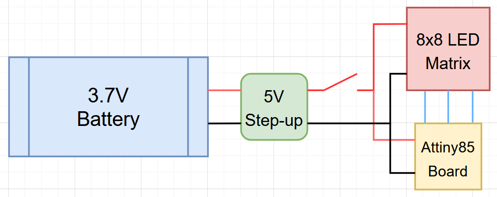

And a very concise diagram:

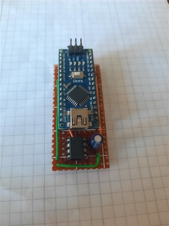

First, let me describe the microcontroller and programming part a little.

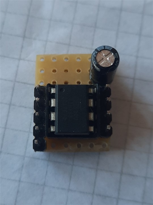

As I said above, I needed a microcontroller or a minimal board, so I chose Attiny85. I had built a small minimal board, with access to GPIOs and 2 capacitors on the power supply, and that's about it, which suited this project. For programming Attiny85 I used Arduino IDE, but since Attiny85 is not natively part of Arduino IDE, you need to follow a few steps.

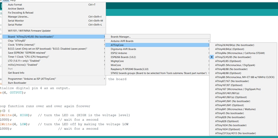

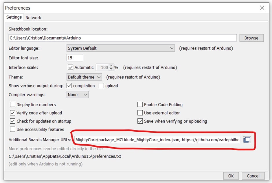

Installing Attiny boards in Arduino IDE
http://drazzy.com/package_drazzy.com_index.json
The address above must be copied to Preferences in order to install the Attiny85 component in Arduino IDE (they must be separated by a comma "," from the others if there are any)

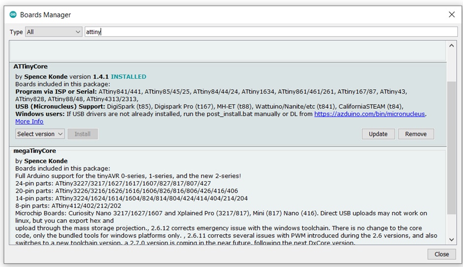

Then in Boards Manager I search for and install AttinyCore:
Or I manually download the archive from github: https://mcudude.github.io/MiniCore/package_MCUdude_MiniCore_index.json
Thanks to the author of this clip:https://www.youtube.com/watch?v=Z_MhVSlMZI8
Now we should be able to select Attiny85 as a board.
I used this method on Arduino IDE v1.8.19, I also tried on v2 but it didn't work, I don't know what the problem is.
Programming Attiny85 using Arduino IDE
Furthermore I also used an Arduino Nano board on which I had already uploaded the "Arduino ISP" sketch. Connections between Attiny85 and Arduino Nano:
 Arduino Nano Pins  |
 Attiny85 Pins  |
 5V  |
 Pin 8 → 5V  |
 GND  |
 Pin 4 → GND  |
 D10 → SS  |
 Pin 1 → Reset  |
 D11 → MOSI  |
 Pin 5 → MOSI  |
 D12 → MISO  |
 Pin 6 → MISO  |
 D13 → SCK  |
 Pin 7 → SCK  |

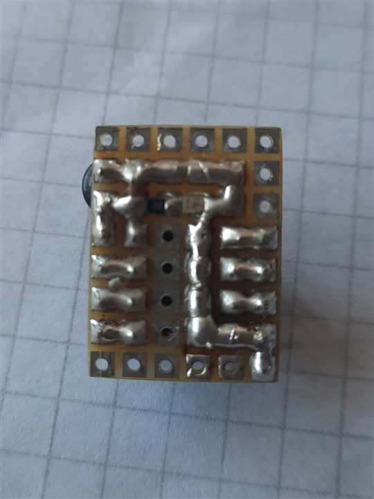

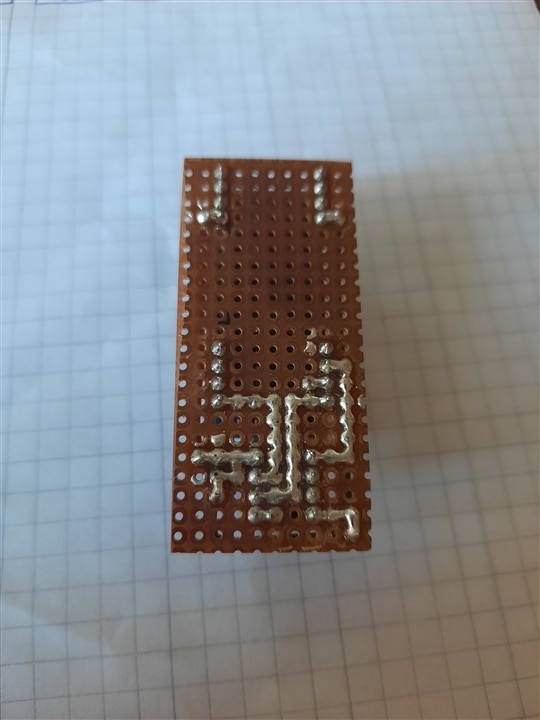

Initially I tested it on a breadboard, then I soldered it on a test board to make it easier for me to use.
| {gallery}Test board |
 Test board 1  |
 Test board 2  |

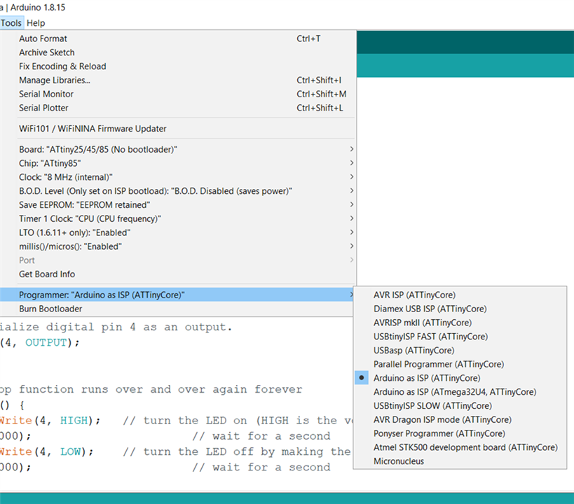

Next, we open the program we want to load into the Attiny85:
• select board (Attiny82 no bootloader);
• then programmer (Arduino as ISP - AttinyCore);
• click on Burn Bootloader (it should take about 2s, I noticed that I have to do this every time I want to upload a program);
• and finally click Upload Sketch, the "Blink" example worked perfectly.

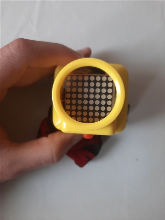

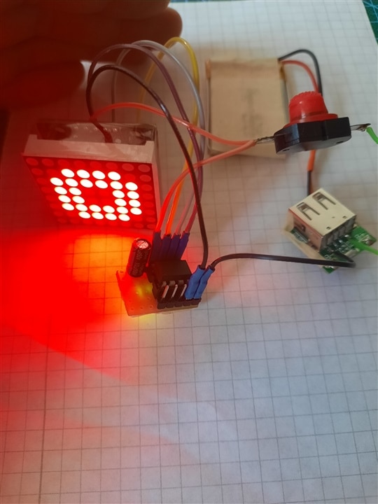

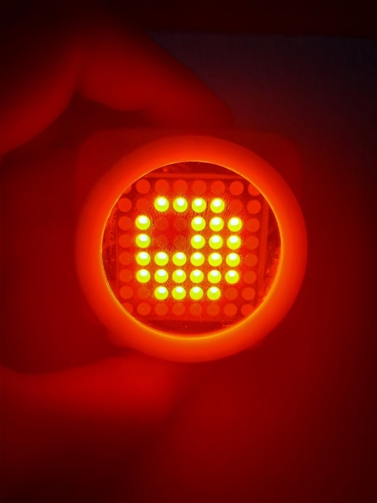

I created some animations (frames) on the "eye" model that fit on the 8x8 matrix and the program actually cycles through these animations: straight; up-down-left-right; top left-down left; top right-down right; and blinking effect. Link to generator: https://xantorohara.github.io/led-matrix-editor/
Initially I tested on an Arduino Nano board and then I thought about Attiny85. I should mention that I also used an AI to make the transition from Arduino Nano to Attiny85 and to save time.

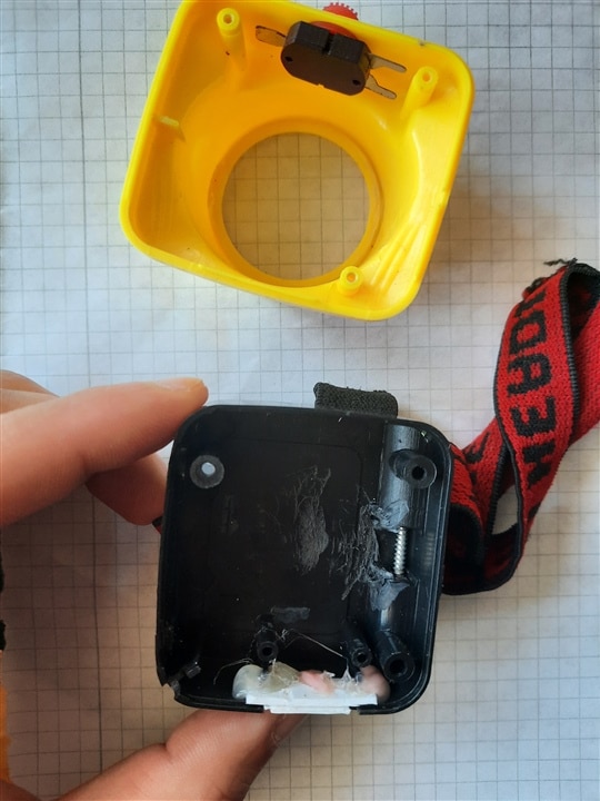

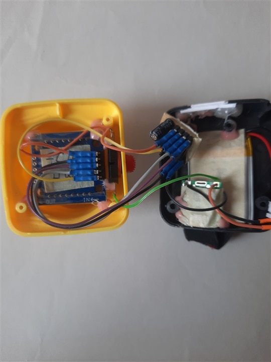

The head lamp housing fit almost perfectly, being square like the LED matrix, but it still had to be modified a little on the inside (cutting a few elements) to make more space for the components, which are already cramped, but I used thin and flexible wires and that helped me.
Since the LED matrix and Attiny85 work optimally at 5V, and the battery is 3.7V, I introduced a module that also contains a step-up converter into the circuit. So I connected the battery to the step-up module to obtain 5V with which I power the circuit. I also mention the use of an On/Off button mounted between the output of the step-up and the matrix+Attiny. Sometimes the step-up module does not work very well, that is, it stops. Unfortunately, I don't have another small step-up converter at the moment (but I will add it to the shopping list), so the current one remains in use, but in the future I will have to find a better one.
Another small modification, I unsoldered the header pins on the matrix and put others on the back, right angle type. Other notes, well, soldering short wires hurts.
As you will see in the pictures, I also used the indispensable hot glue to fix the components more conveniently. Again, a little poorly assembled, but I think it will hold up..
| {gallery}Project pictures |
 Attiny85 minimal board 1  |
 Attiny85 minimal board 2  |
 Components  |
 Preliminary test  |
 Head lamp enclosure  |
 Assembly 1  |
 Assembly 2  |
 Assembly 3  |
 Assembly 4  |
