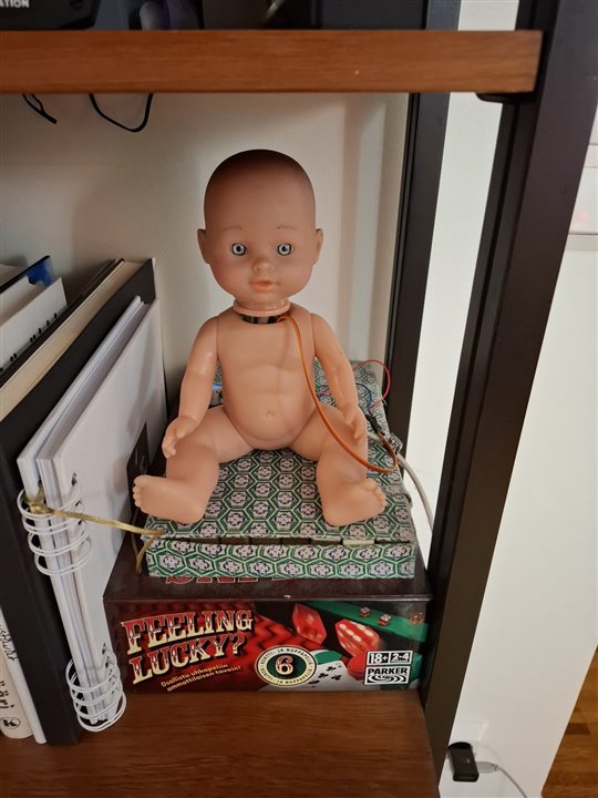

A doll that moves when nobody is home
Doll
This is a doll that turns its head only when nobody is in the room. Actually it is an M5Stack AtomS3R and a SG90 micro servo, listening to wifi. The router is the only sensor. When someone comes near, even outside a closed door, it stops dead in whatever pose it has reached, and waits.
I'm still in love with exploring what tiny cheap esp32 based controllers can do. The 3 M5 Atom devices lie on my desk, so it was an easy bet. But a microcontroller alone does not really differ from a PC, and for Halloween we need something kinetic. I did the over-engineered version of that already (home automation reads a PIR and makes a Zigbee Fingerbot push the button on a camera. A lot of infrastructure to push one button). So this time "underengineered".
Unknown is scary. It's more scary to realize an object has moved than to actually see it move. So I turned the concept upside down: it only moves when nobody is there to see it. No need for audio either. The sound of a servo in an empty room is the most scary thing, and it stops when you enter.
Then I remembered the dozens of projects where people "see through walls" with wifi CSI. We do not need to see through walls. We just need to know when nobody is near. Wifi is already there, so no extra sensor. And one thing simplifies the whole problem: false positives do not matter. Who cares if the servo stops when nobody is there. It just must never move when a person is near.
And the same problem as checking the fridge light: how do you know it moves if you can't be in the room? My IP surveillance camera films it. No CGI, no editing, no effects.

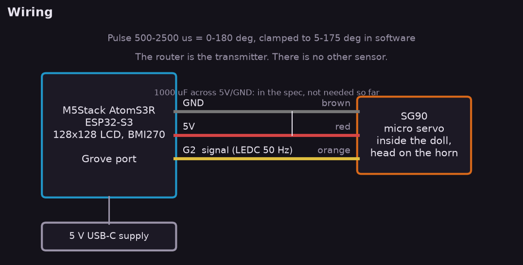

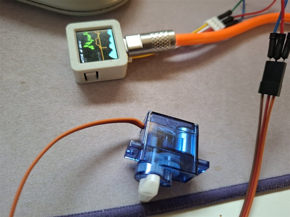

SG90 micro servo Turns the head. Signal on Grove G2, 5V and GND from the Grove port.
Grove cable Cut and soldered to the servo lead.

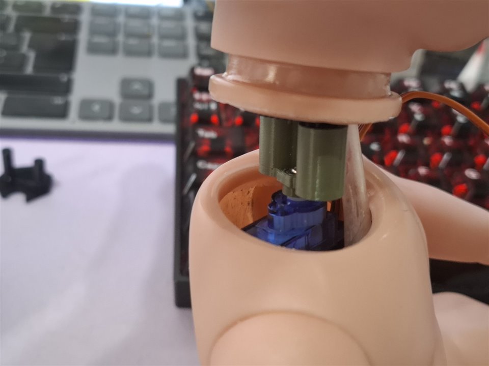

Doll Head off, servo inside the body, head back on a 3D printed adapter on the horn.

Servo wiring
wiring
Wiring is three wires. I had to swap two of them before it moved (the colours on my Grove cable did not match M5's table, so check with a meter). The spec had a 1000 uF capacitor across the servo supply, against brownouts when servo current and wifi TX peak together. In the first 75 minute run with 167 moves there was not a single reset without it, but that run had nothing on the horn.
The neck: I printed 2 part coupler for the neck. A soft TPU part to be stuffed into the head and PETG part to be connected to the servo. Even after adding some oil to the neck it was too stiff, so I did not dare to put it fully in place in risk of burning the servo. The "severed" cyborg look is almost better.
neck assembly

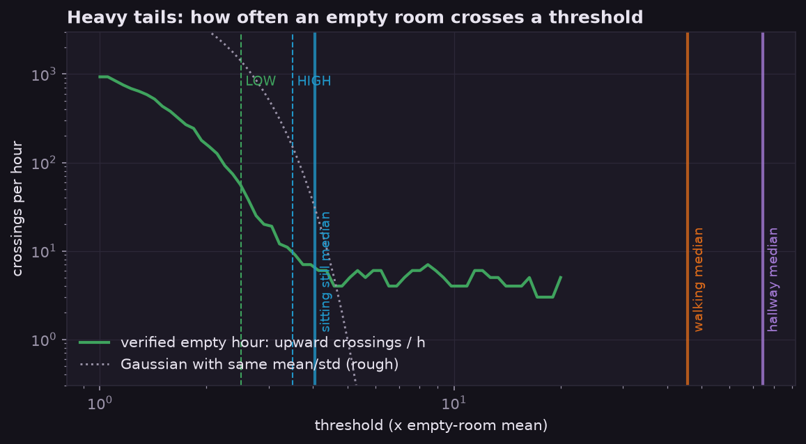

False alarms: the empty room has heavy tails
I left the house for an hour with logging on (verified empty). The median metric stayed flat, no drift. But the tails:
heavy tails
Threshold (x mean) 1.5 2 2.5 3 3.5 5
Crossings per hour, empty 434 157 54 21 10 4
In units of its own mean the empty metric has std 1.02, the shape of an exponential, not a bell. A Gaussian with the same mean and std would almost never pass 5x. The real room does it 4 times an hour, and nothing above 3x lasted over 1.5 s. So mean + 6 sigma from a 60 s calibration was far too tight (the calibration std was 0.0029, it does not describe an hour), and the floors went in: LOW 2.5x, HIGH 3.5x. People walking are 20-100x, so there is plenty of room between.
And a false alarm here costs almost nothing. It only means the doll waits a bit longer. 54 crossings an hour at LOW looks bad, but each one is short and only restarts a 10 s quiet timer.
