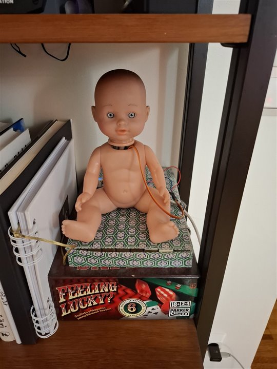

A cursed doll turns its head only when nobody is there. No PIR, no camera. An M5Stack AtomS3R pings the router 100 times a second and reads WiFi CSI. Anyone moving nearby, even behind a closed door, and it freezes.
A doll that moves when nobody is home
Doll
This is a doll that turns its head only when nobody is in the room. Actually it is an M5Stack AtomS3R and a SG90 micro servo, listening to wifi. The router is the only sensor. When someone comes near, even outside a closed door, it stops dead in whatever pose it has reached, and waits.

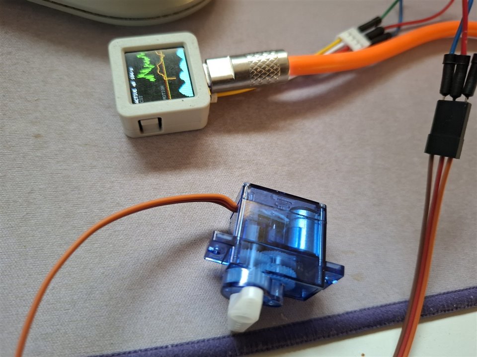

M5Stack AtomS3R (ESP32-S3, 8 MB flash, 8 MB PSRAM, 128x128 LCD, BMI270 IMU) Receives wifi, computes CSI, decides, drives the servo. The same one that ran my Micro Arcade.
SG90 micro servo Turns the head. Signal on Grove G2, 5V and GND from the Grove port.
Grove cable Connected to the servo with 3 jumper cables.
Doll Head off, servo inside the body, head back on a 3D printed adapter on the horn.
5 V USB-C supply Powers everything.
Wifi router (Google Nest mesh, channel 11) The transmitter. Already there.
Servo wiring
wiring
Wiring is three wires. I had to swap two of them before it moved (the colours on my Grove cable did not match M5's table, so check with a meter). The spec had a 1000 uF capacitor across the servo supply, against brownouts when servo current and wifi TX peak together. In the first 75 minute run with 167 moves there was not a single reset without it, but that run had nothing on the horn.

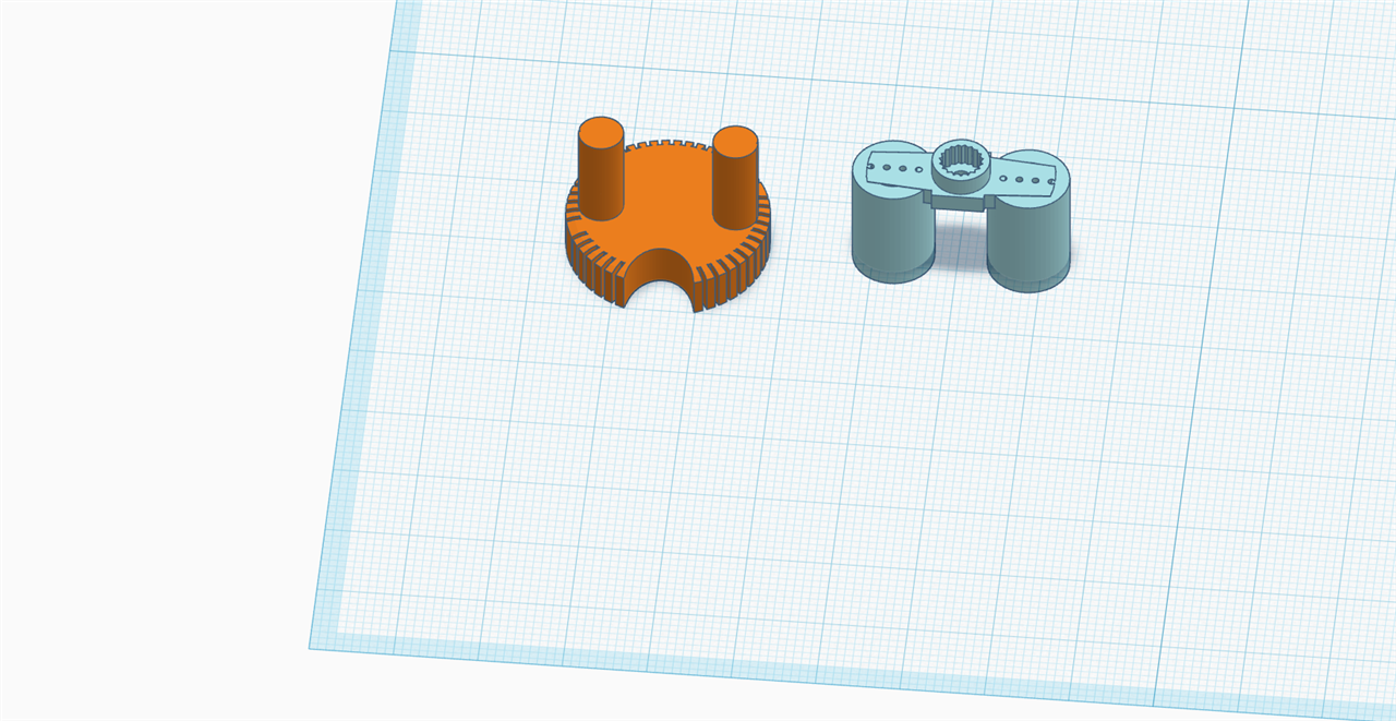

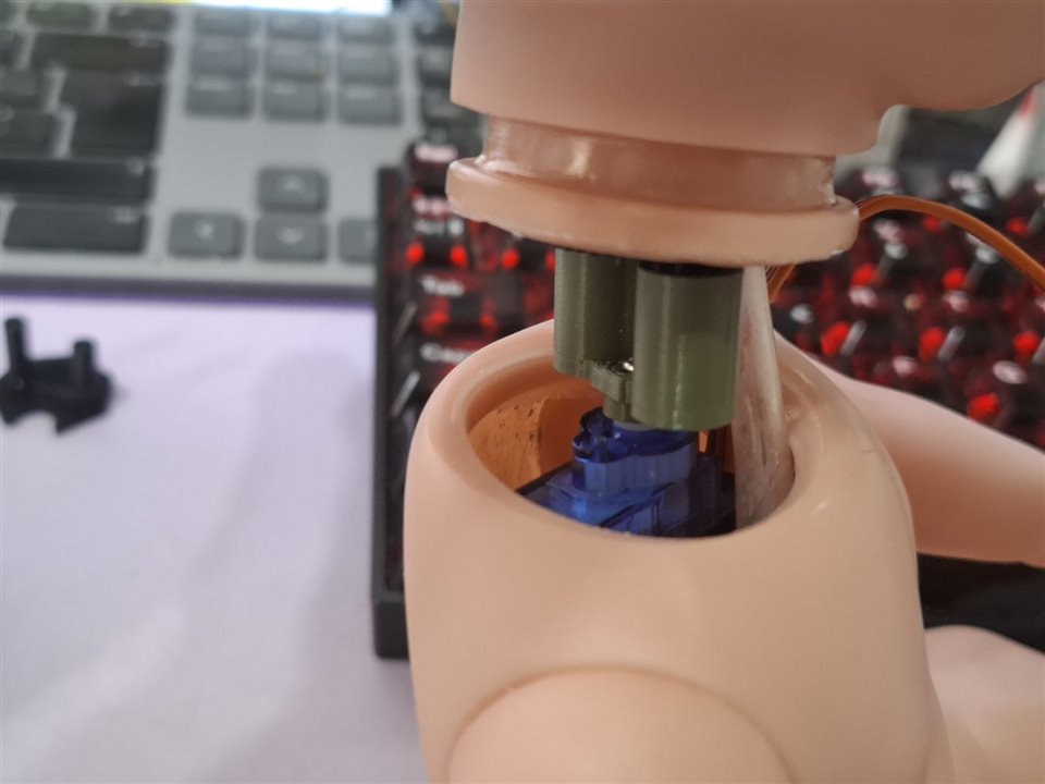

The neck: I printed 2 part coupler for the neck. A soft TPU part to be stuffed into the head and PETG part to be connected to the servo. Even after adding some oil to the neck it was too stiff, so I did not dare to put it fully in place in risk of burning the servo. The "severed" cyborg look is almost better.
neck assembly
3d design for neck

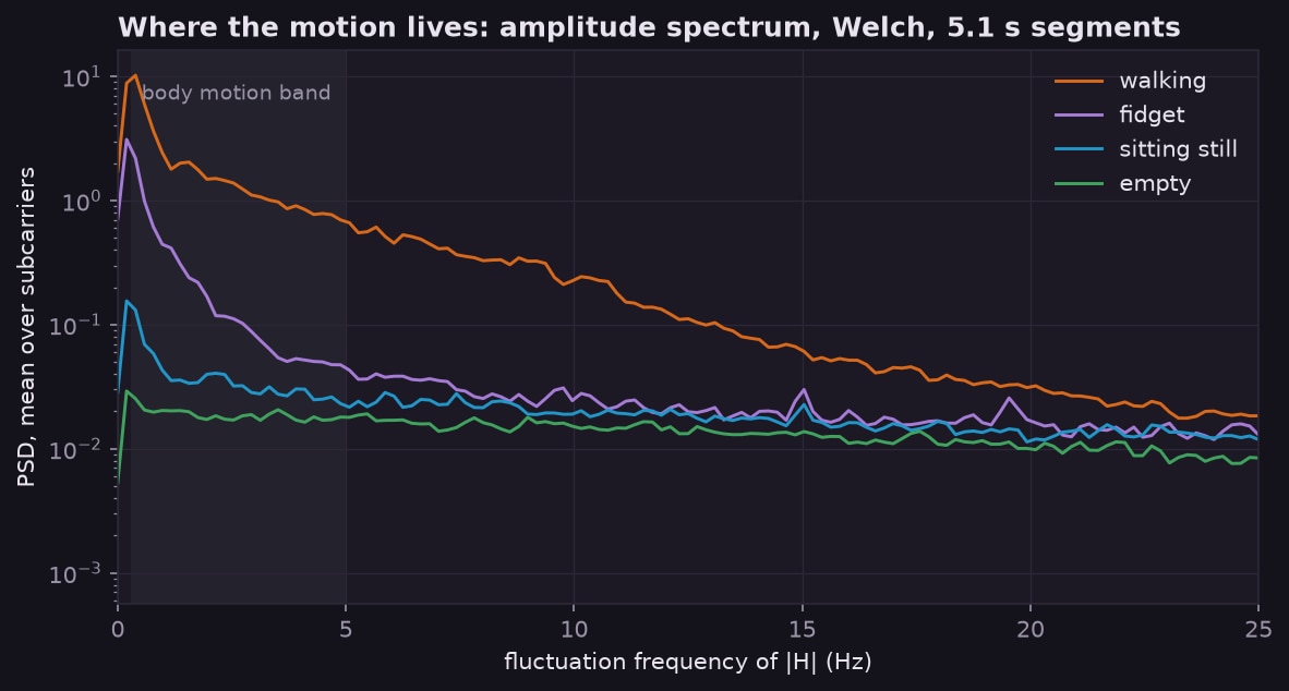

When a person moves, the path lengths through them change. A reflected path that gets lambda / 2 = 6.1 cm longer has rotated its phase a full turn, so the notches slide around. The rate is the Doppler shift of that path:
f_D = (1 / lambda) * d(path length)/dt
reflection, person walking 1 m/s toward/away:  path changes ~2 m/s
f_D ~ 2 / 0.1219 = 16 Hz   (upper bound, real motion is slower and mixed)
So 100 frames per second is plenty (Nyquist 50 Hz). The measured amplitude spectrum agrees. Almost all of the motion energy is below 5 Hz:
Motion lives here
Segment power 0.3-5 Hz vs empty
walking 8.07 96x
fidget (seated, small moves) 1.09 13x
sitting still 0.17 2.0x
empty 0.084 1x

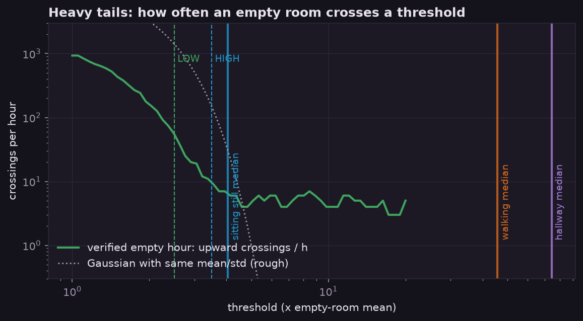

False alarms: the empty room has heavy tails
I left the house for an hour with logging on (verified empty). The median metric stayed flat, no drift. But the tails:
heavy tails
Threshold (x mean) 1.5 2 2.5 3 3.5 5
Crossings per hour, empty 434 157 54 21 10 4
In units of its own mean the empty metric has std 1.02, the shape of an exponential, not a bell. A Gaussian with the same mean and std would almost never pass 5x. The real room does it 4 times an hour, and nothing above 3x lasted over 1.5 s. So mean + 6 sigma from a 60 s calibration was far too tight (the calibration std was 0.0029, it does not describe an hour), and the floors went in: LOW 2.5x, HIGH 3.5x. People walking are 20-100x, so there is plenty of room between.
And a false alarm here costs almost nothing. It only means the doll waits a bit longer. 54 crossings an hour at LOW looks bad, but each one is short and only restarts a 10 s quiet timer.
