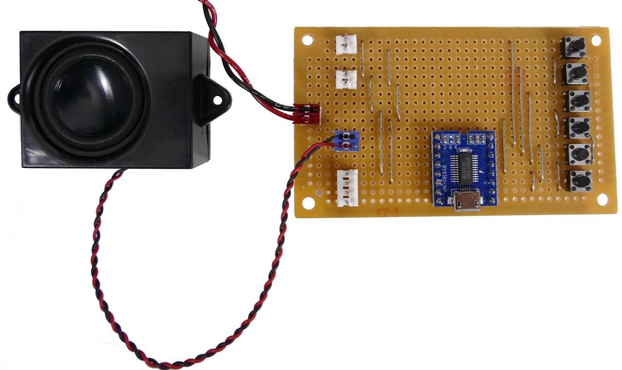

The audio is supplied by a BY8301-16P module which allows any sounds to be triggered by digital inputs or a serial interface - push buttons in my case.
The manual is in Chinese and not completely translated so I am including some instructions on how to load the module up with audio files.

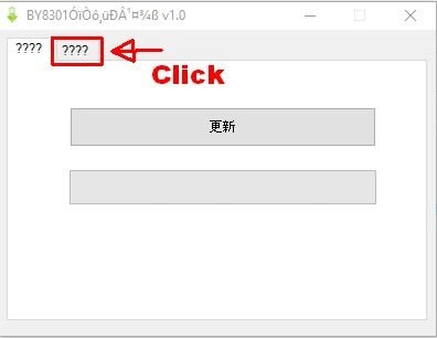

The module has a USB port that shows up as 2 disk drives when plugged into a computer, however one drive is so full, there is no room to copy anything to it. The other drive is not formatted properly to be accessed by a file manager. Fortunately the drive that is full has a program on it that will transfer files.
The file name is in Chinese, but it is the only file with a .exe extension. Start by running that program.
This program window will appear:
Click on this ???? tab to bring up a file requester

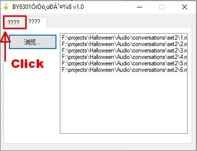

The program window now looks like this, with a blank files area:

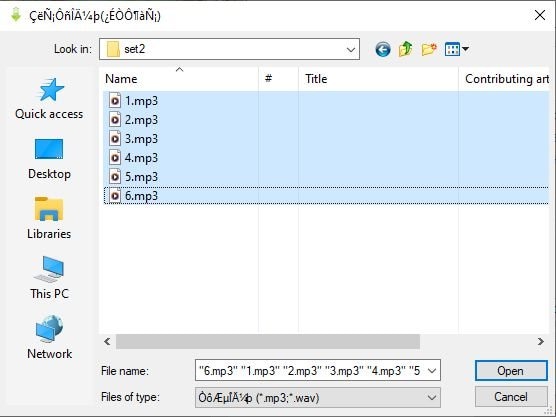

Click this button to bring up a file requester.
Select the audio files you wish to copy and click Open. The files should be numbered as above.
This will paste the file names into the blank file area of the program like this:

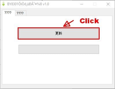

Click the first tab. This goes back to this window.
Click the copy button as shown above.

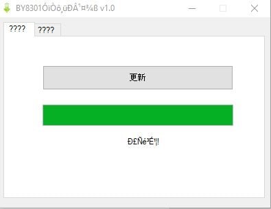

Wait for the green progress bar to fill in and the copy is done.
You can close the program now. Disconnect the USB port and connect VCC to the module to start playing sounds.
