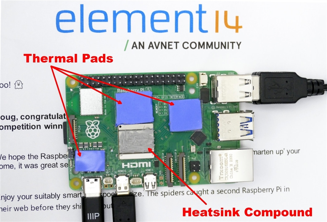

The first thing I mounted was an active cooler. These come with 3 thermal pads, but none of these pads sit on the CPU. They sit between 3 other hot chips and the cooler plate as shown here:
The thermal pads bring the height of the hot chips up to the level of the CPU so that all 4 touch the cooler. Note, I also added some silver heatsink compound to the top of the CPU to make sure it makes good thermal contact with the cooler plate.

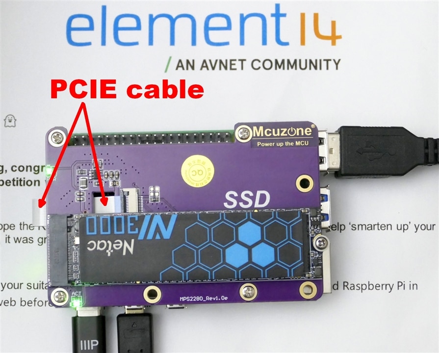

Then I added the NVME hat and SSD:

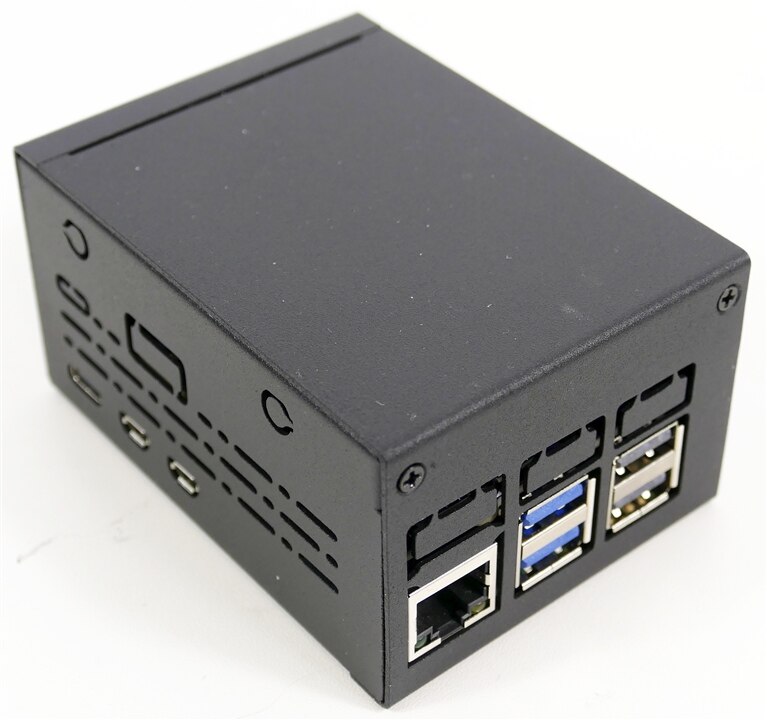

Then I installed the stack into a case:

The Raspberry Pi operating system was installed on the SSD using the standard Raspberry Pi installer. To do this the SSD was plugged into a Bluendless adapter that interfaces an SSD to USB. One thing to note is that new SSDs need to be  initialized using the Disk Manager before the external drive will be recognized.

The metal case I am using has lots of ventilation and even space for another stacked Hat. If you have any suggestions what should go in this space let me know below.
