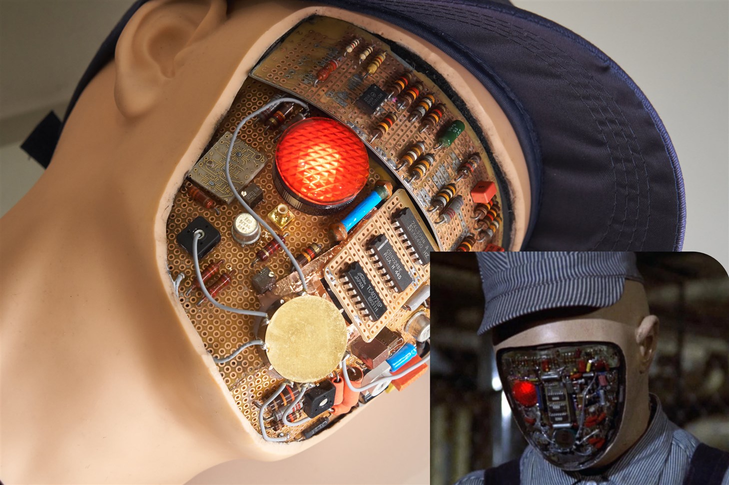

The dummy human head was discovered on Amazon. Ieva went into Hannibal Lecter mode with it, and sliced off the face so that the circuitry could be installed. The inside of the head happened to contain expanding foam.
In order to somewhat replicate the look of Clark, we installed vintage components onto recycled (from a previous project) prototyping board. The board needed to be in a curve, so I first milled off 1 mm of thickness from the protoboard to gain a bit of flexibility. A far easier method would be to use flexible protoboard but we didn’t have it.
The protoboard that would cover the forehead was glued to sheet aluminium for strength so that it could be easily removed to access the internal electronics modules.
The aluminium sheet was first bent into a curve. I don’t know if it is a very orthodox method, but the sheet was just pressed against a 1-inch diameter metal tube using a wood block with a rubber face (it was a sanding block) to apply pressure and slid back and forth until it had curved enough. It wasn’t perfect, but it gave reasonable results.
The protoboard was of FR-2 material, which has the advantage of no fiberglass dust when milling but has the disadvantage that it is very easy to accidentally crack. There were some cracks, but that’s no bad thing because the head should look a little damaged like as if it was a destroyed robot.
We needed to produce a look as if the robot head had been torn off at the neck, so we had to guess what such a scene could look like : ) Perhaps there would be torn electrical cables that were used to connect the brain to the rest of the body. To create the look, wires were covered with fancy braid and terminated at the neck end with cable glands. I happened to have some chunky light pipe, so we added that too, as well as a gooseneck, all screwed onto a piece of scrap ABS plastic. Fiber optics were already in use in 1976, so we felt comfortable adding the light pipes.

This project was a great opportunity to use up ancient electronic components! I didn’t have many old-looking carbon resistors, but I found lots on eBay.
Since the protoboard is glued to aluminium, it was not going to be easy to solder through-hole parts to it, especially heavily oxidized ones. Instead, the components were simply superglued.
For the lighting, as mentioned, we used three high-brightness red LEDs, connected via MOSFETs attached to the BLE microcontroller. Everything runs from 3V. We used two D-sized alkaline batteries that should last for many Halloweens. The heavy cells also give the robot head a more realistic weighting : )

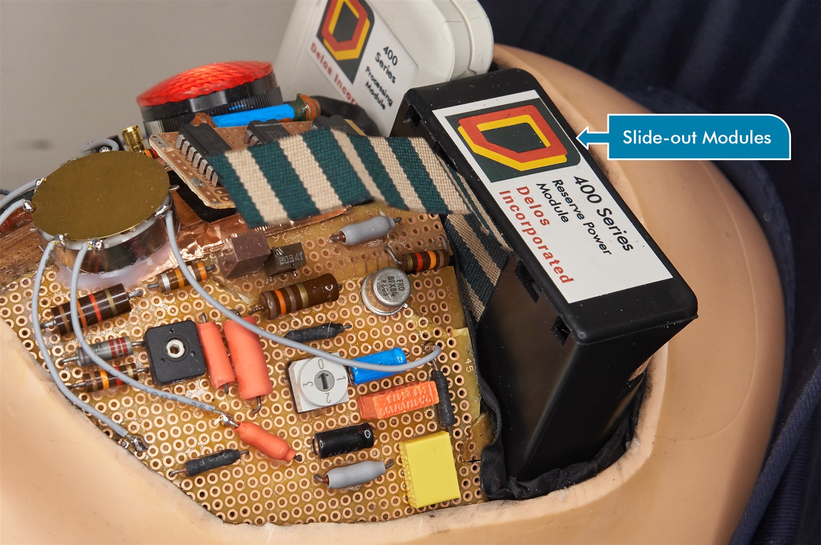

The two modules (2 x D cells, and the controller) are a slide-fit inside the forehead:
Cutting and breaking apart the expanding foam inside the head generates a lot of static electricity! The microcontroller board should be kept away from the expanding foam during this work, and eventually placed inside an enclosure to protect it.
The module enclosures have a Delos Incorporated logo; Delos was the robot manufacturer and holiday resort operator :)
The microcontroller module and the 2 x D battery holder are easy to slide out whenever they need work/replacement.

The LEDs can be controlled from a mobile phone. The BLE module advertises using the name Futureworld, and the free LightBlue app can be used to connect to it. Each of the LEDs can be set to one of four settings: Off, On, Blink (at a predefined rate), or Flicker (random on and off times). Two LEDs are connected to light pipes, and one LED illuminates the eye.

Here’s the completed project; the inside of the face was covered in copper foil for a space-age look.

The sliding modules behind the forehead were a lucky idea that worked out practically. Originally we were just going to try shoving everything up through the neck but (no surprise) that was exactly like a bottleneck!
