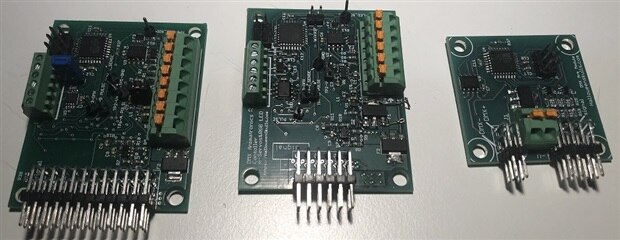

For the past few years I have been building Animatronics controller boards for a client that builds really cool skulls (https://www.halloweenskulls.com/ ).  This client had posted a job, to replace an existing controller board with a lower cost product.  This has been a really fun project that continues to grow.
The three boards (from left to right) are as follows:image
First Generation - 12 servo channels, 3 dimming LED channels (with common strobing channel), jumpers for DMX terminator and individual board power source. Features include programmable current limit (Maximum of 8 Amps) and trip time for servo power and auto shutdown of servo power based on inactivity.
Second Generation (under development) - 6 servo channels, 3 dimming LED channels (with common strobing channel), program control of DMX terminator. Features include programmable current limit (Maximum of 8 Amps) and trip time for servo power and auto shutdown of servo power based on inactivity.  This design includes a new reverse voltage protection scheme with a super low voltage drop (high power MOSFET switch).
Second Generation, Arm controller (under development) - 4 servo channels, program control of DMX terminator. Features include programmable current limit (Maximum of 8 Amps) and trip time for servo power and auto shutdown of servo power based on inactivity.  This design includes a new reverse voltage protection scheme with a super low voltage drop (high power MOSFET switch).
All three of the controllers can have the firmware reprogrammed via the DMX bus using a bootloader program.

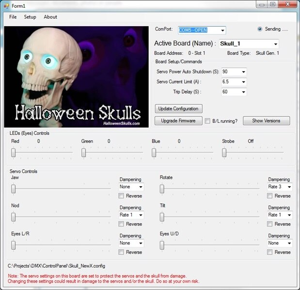

In addition to the electronics and firmware design, I have created control panel software to exercise all of the servo/LED channels, configure firmware features and to update the firmware..
