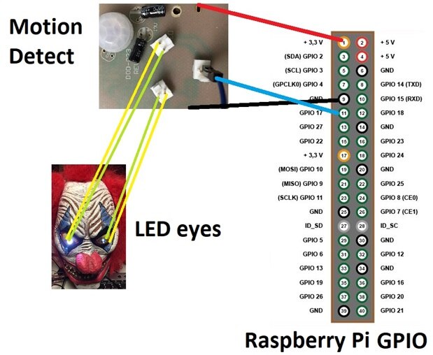

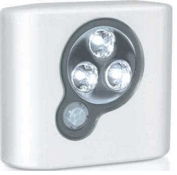

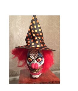

I found some inexpensive battery-operated motion sensing LED lights at the local hardware store.

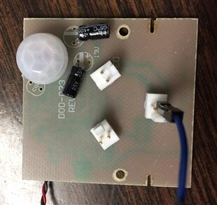

I removed the circuit board from the housing, unsoldered the battery clips and replaced the LEDs with Molex headers.

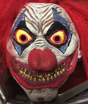

I used a rather scary creepy clown mask to hide all the parts inside.

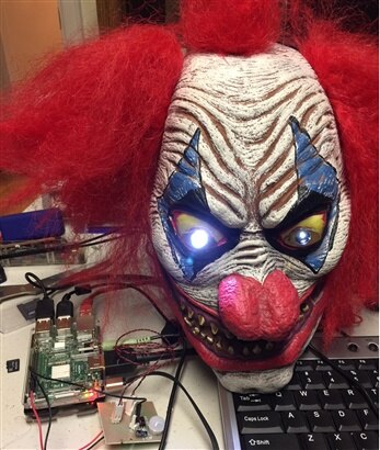

I glued two LEDs into the eye holes and ran the wires back to the motion detector.

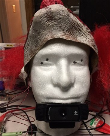

I used a Styrofoam dummy head as a base and cut out material to fit in a webcam.
The finished head looks like this:
I found some scary Halloween sounds on the net to use for this project:
http://soundbible.com/1129-Maniacal-Witches-Laugh.html
The motion detector is wired to a raspberry pi GPIO17 pin, and when the software detects a change, it captures a photo from the hidden webcam, then plays the "maniacal witches laugh" through a small amplifier. It will also send me an email with the photo attached if I choose. The software is based on one of the many raspberry pi doorbell projects found on the web. This is a good example:
http://harizanov.com/2013/07/raspberry-pi-emalsms-doorbell-notifier-picture-of-the-person-ringing-it/
All I have to do now is mount it on a chair and stuff some clothing with newspaper and wait for the Trick-or-Treaters...........
Wiring:
