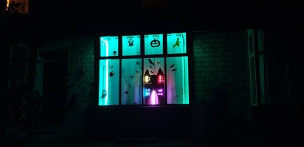

With no trick or treating this year I created a fun interactive Halloween display for our front window. I used the vinyl cutter to create Halloween stickers to cover the window. I cut out a cardboard box to make a spooky haunted house. Then I added some lights!
I added 150 strip of WS2812Bs to a Raspberry Pi 3 that also had a camera and an IR transmitter connected. I then added a huge strip of LED lights from Amazon - 10 metres! These lights were controlled using an IR remote so I hacked the remote using the Raspberry Pi.
The windows works as follows:
There are two light strips - the smaller Haunted House light strip directly connected to the Raspberry Pi. It's wrapped around the house in 3 columns. And the store bought 10 metre strip that is controlled using an IR remote - it's wrapped around the entire window.
- The Haunted House constantly plays an animation - it looks like the windows are changing colour
- The store lights glow green
When someone walks past the window on the footpath outside, with a light on:
- the Raspberry Pi camera spots the change in pixels
- It starts to flash the lights - the Haunted House lights directly and using an IR transmitter the store bought lights. They flash red then green.
