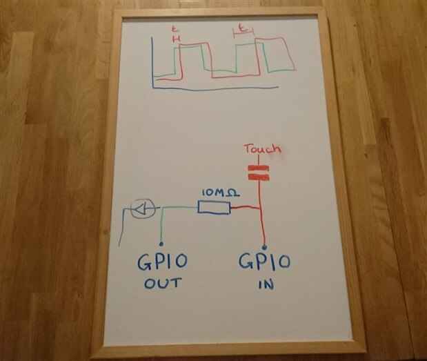

The Basics
The circuit is really simple, an output joined to an input using a high-value resistor. The sense line is then attached on the input side of the resistor.
I added an LED to the output just so I had some visual debugging to know when it was working or not.
All the circuit does is send a signal from the output pin to the input pin. The overall capacitance of the circuit defines how long the input will take to respond to the output, and that's where the code comes in...

All the code does is output the response times on the screen, longer times are when the capacitance is high, shorter times are when the capacitance is low. It is pretty easy from there to set the response time and set some actions!
