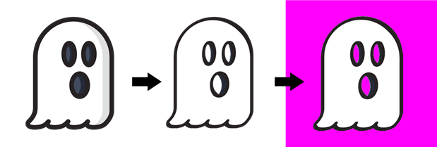

I started by hunting for suitable images on the internet, free for download.  The images used are simple, brightly colored and  quickly recognizable.  A good source for similar material are the websites that have icons like this one.  The images were modified to have similar outlines, simplified where needed, and colored red, green, blue, pink, and yellow in Photoshop.  Pink is my 4 year old granddaughters favorite color.  Had to use pink.  Below is an example of a ghost undergoing the changes described.
Editing the ghost image
In all, eight different Halloween images were created in five colors.  They were numbered 1 through 40 and saved as 600x600 images in jpeg format.

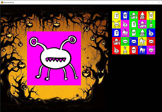

  1. Displays a welcome screen with directions while playing the background music
  2. When the user presses the space bar:
    • Randomly draw a monster piece and display a large image
    • Play the sound associated with the monster
    • Tile the image upper left to enable winning cards to be checked
    • Set timer to prevent another draw until 5 seconds pass
  3. Loop back to 2.
The user starts a new game by pressing the "n" key and can quit the game by shutting down the window or pressing the "q" key.

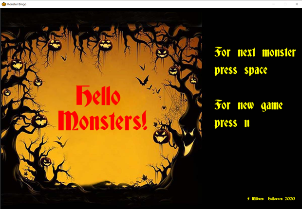

The welcome screen looks like this:
The splash screen with instructions
A game in play looks like this:
Game being played
