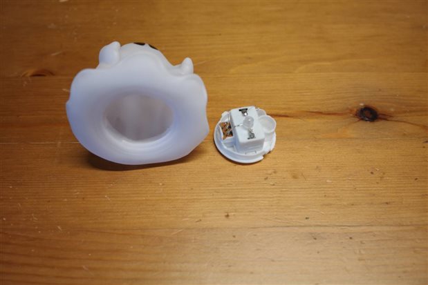

Most of the light up decorations (that I've come across) are a outside casing (in my case a ghost), and a small plastic block in the bottom.
This electronics module is 3 coin cell batteries connected to a colour cycling LED along with a switch to break or make the circuit.

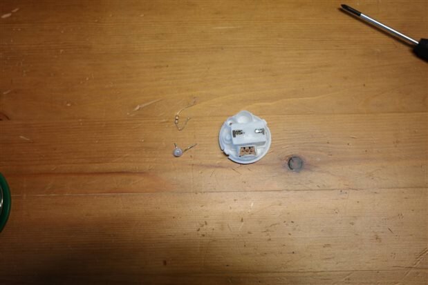

First step is to desolder the original colour cycling LED

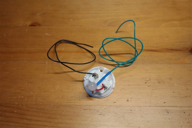

The next step is to solder the +5V pin of the Neopixel to the switch output and the GND pin to the - battery terminal.
For the control of the neopixel I add a wire to the Data in pin, and connect an extra wire to the GND pin.
This is because the ground of the neopixel needs to be shared with the microcontroller for the comms to be understood, however the neopixel can be powered from the coincells which avoids a 3rd wire.
(The AG13 batteries will produce 4.5V (1.5V*3), but this is fine for these neopixels, they will just be dimmer).

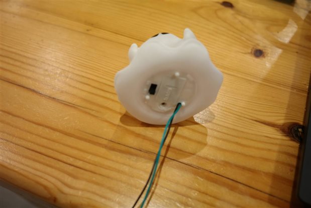

I then feed the wires through a hole if available, or make a small hold in the case.

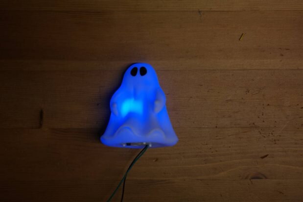

However these are just demos/examples to show the possibilities, so experiment and have fun creating your own programs and light displays image

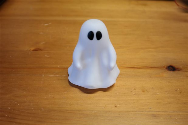

(A different Ghost, same mod)
