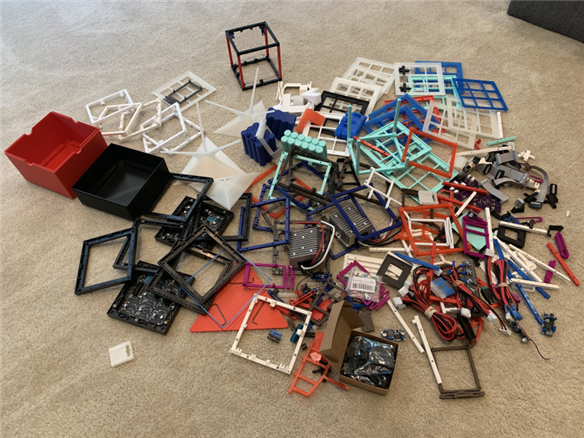

I quickly found myself out of my depth on the CAD side of things. The tech specification of the LED panels, the electrical requirements, and the boards to drive everything were readily available. However, building a frame to house the panels and electronics while ensuring it was sturdy was going to become a mammoth task. I didn't want to end up in a "prototype hell" scenario... hundreds of hours of 3D prints for failed ideas. I figured some people must have been through this adventure already, and I was right.

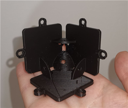

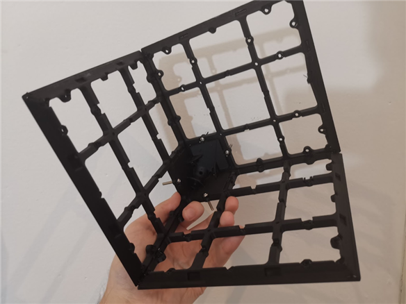

I eventually settled on an absolutely incredible design by HappyTeddybear who had all the STL files available for the P2.5 64x64 panels. Seriously, this guy was the saviour of this project. Check out the genius of his design.

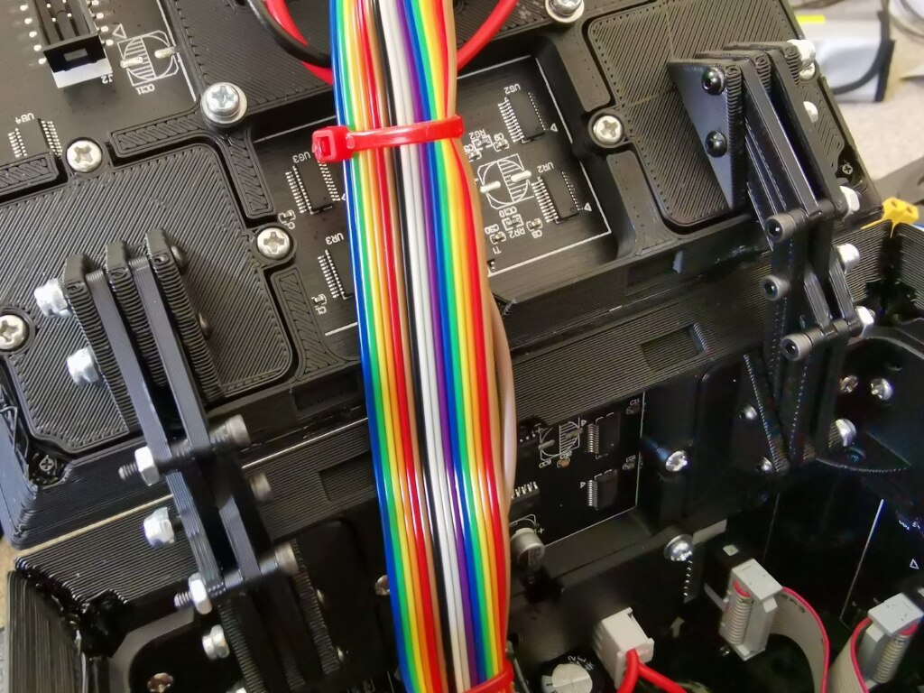

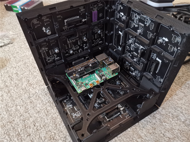

The frame fits together beautifully. The hinge design for the lid is a piece of practical art. The lid and adjoining frame have special indents for neodymium magnets to keep it held together, while still allowing access to the internals. There are mounting frames with specific screw holes to hold the raspberry pi and the voltage regulators.

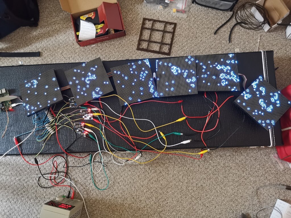

Testing the panels
While waiting for the frames to print, I sourced the LED panels from the UK based company Pimoroni, who have been excellent at getting components to me quickly. After some hacky wiring, I got the chain of panels hooked up together and tested them out with my bench power supply. I was delighted to see they worked smoothly and at high frame rates on the Pi 4 after some software tweaks. See Adafruit's setup guide for the Bonnet - https://learn.adafruit.com/adafruit-rgb-matrix-bonnet-for-raspberry-pi/
Here is some example code showing Conway's Game Of Life spread over all 6 panels.

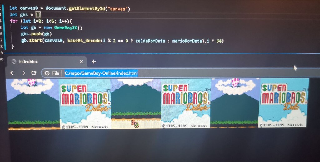

As a display piece, the cube is excellent. But to take things further, I wanted to make it interactive in some way. I found some demos for simple games (pong, snake) but my love for old games consoles immediately made me think about running emulators. With my day-job expertise mostly focused around web tech, I naturally started hunting for a good javascript Game Boy emulator. Then I got to work getting something running on one of the panels.
The frames needed to be retrieved from chromium and read by a node.js server (both running on the pi) so they could be converted to raw data to send over GPIO. Luckily I found NCC, which can do exactly that, among other things. Eventually I tried 6 different games at once. Here it is in windows, but the environment is similar in raspbian, minus the GPIO sending part. The rpi-rgb-led-matrix node bindings take care of the rest.
This didn't work too well because of the Pi's relatively limited CPU, but is was still a fun experiment. One game preformed well, though. Next, I wanted to make something that utilised all of the sides at once in a single game. Well, four of them at least.
