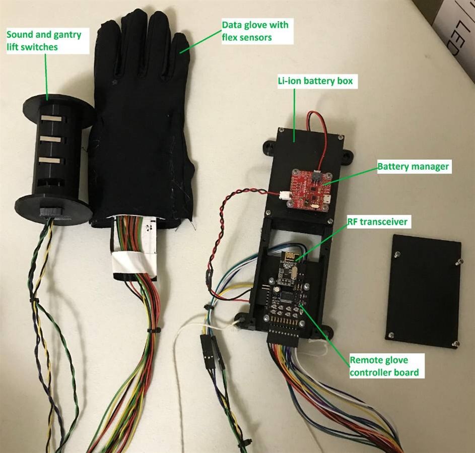

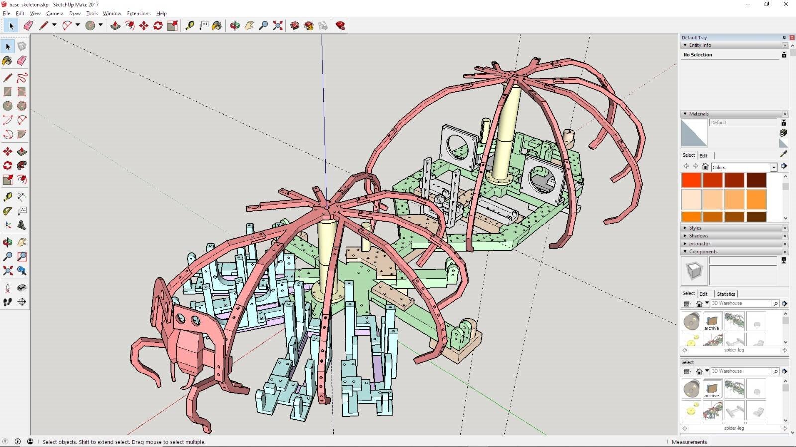

I started the project with design of the legs.  I modeled the leg parts in Google SketchUp and printed them with a 3D printer.  A 12V stepper motor is used to drive each of the three joints in each leg.  I prototyped a data-glove by taping resistive flex sensors onto a glove, with two flex sensors in each finger (one per knuckle) and a flex sensor at the wrist to control the spider hip joints.  I designed a custom leg control board around a Microchip 16LF15344 MCU to measure the analog voltages across the flex sensors and translate them into stepper motor positions and subsequently into the phase signals to the stepper motors.  The control board also accepts signals from limit switches that activate at each end of the range of motion of the joint.  The circuit design for the custom boards was created with KiCAD and the PCBs were manufactured by OshPark.
The body of the spider was modeled with Google Sketchup and printed with a 3D printer.

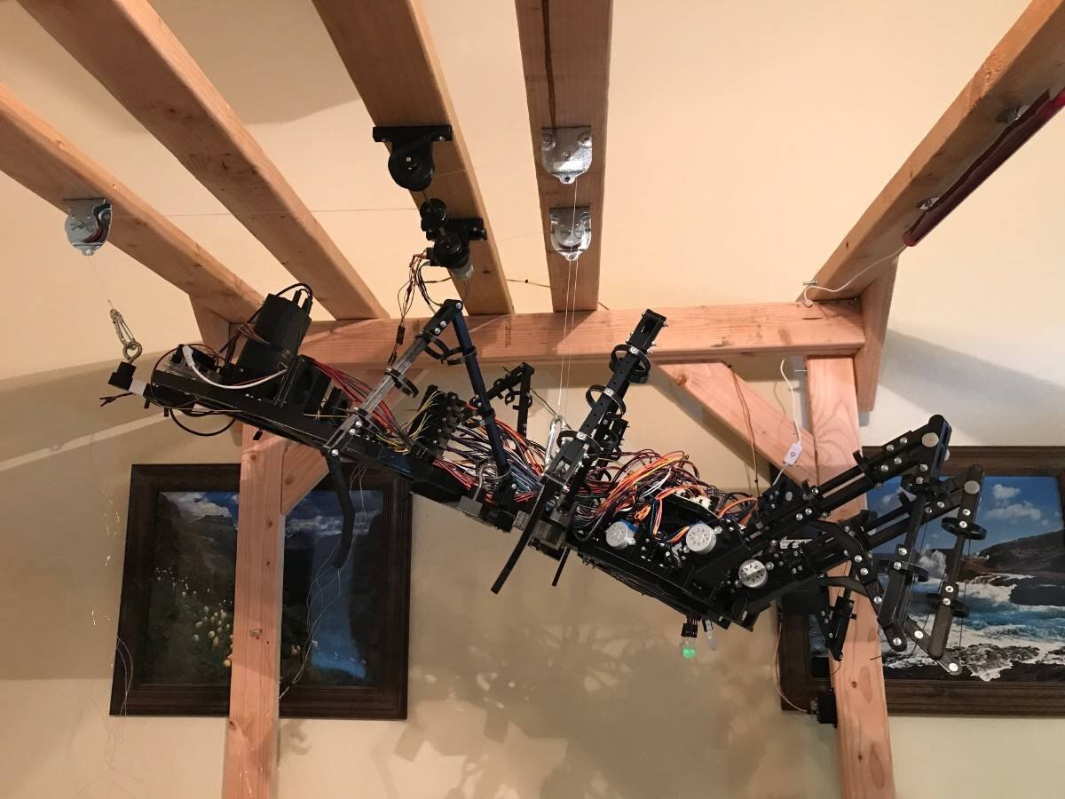

Here is the assembled spider without its exoskeleton.
Once I had the leg prototypes working and the body built, I added remote control using nRF24L01+ RF transceiver modules.  On the data glove end, the RF module plugs into a custom PCB built around a Microchip 16LF15355 MCU which takes the flex sensor measurements and control switch signals and transmits the readings via a SPI interface to the RF module for transmission.

Remote Data Glove Code
The remote data glove code configures each of nine inputs to the PIC as analog inputs to the ADC module.  The inputs are connected as a voltage divider circuit with one leg being the flex sensor and the other leg as a trimmer pot tuned so that the maximum voltage across the flex sensor will be 2 Volts at maximum bend, which is the highest voltage that the PIC can measure.  Three other inputs to the PIC are configured as digital inputs connected to each of the limit switches in the left hand switch grip.  The data glove code is also responsible for configuring and operating the nRF24L01+ RF transceiver module via a SPI interface.  The switch signals are debounced in software using the PIC timer0 and timer2 modules.  At 100 millisecond intervals, the main loop of the PIC code samples the analog ADC inputs and digital switch inputs and sends the measurements to the RF transceiver via SPI to be transmitted to the receiving spider main controller.

The spider is attached via fishing line to a gantry made from 2x4 studs with a Pololu DC gearmotor driving an axle with pulleys.  Signals from the spider to the gantry motor controller are transmitted via taser wire, which is thin enough to look like spider web filament.
