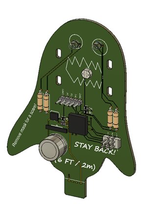

This time around, I opted for creating a "USB PCB". That is; I created the PCB in a way that mimics a USB male connector so it can plug directly into a USB port without extra components required. The concept is that this will go into a power bank; which doubles as a regulated power supply and also a sturdy base to display the ghost. This keeps the BOM cost down and also assembly time. I don't need to add any voltage regulation circuit or any connectors. I just have fingers on the edge of the board to pick up the power. I created a custom library component for USBPCB and ran with that. I couldn't easily find a component library for Eagle and just made my own based on a few different posts I found and using a design from Freetronics called "LeoStick" which has the same thing. The creator of Freetronics, Jon Oxer has a discord and does a live stream every week so I was able to get a few tips on doing it. The PCB was generated to be 2.0 mm thick instead of the 'standard' 1.6 mm. I used ENIG (electrolysis nickel-immersion gold) coating to prevent corrosion and give some longevity to the connectors (through the use of Nickel) instead of the 'free' HASL (hot air solder leveling). ENIG is often used for sliding contacts and connectors, so should work out well as a USB port. For some reason, Fusion360 doesn't properly display the USBPCB in the 3D render, but I made sure it would be there in the final.

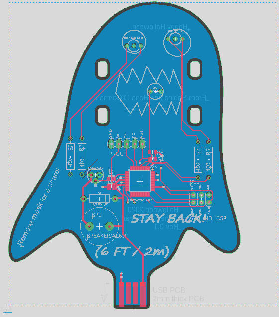

Board Design elements
I did a few more things that I haven't before. I noted in a previous post how I generated a fancier board shape for the first time doing a Smart Speaker project. I carried that on here with a more complicated ghost outline PCB, and included some holes routed through the face-area so I could snap in a 3D Printed mask. The USB port required a special shape (~12mm wide, 9mm tall; rounded edges for ease of insertion). I also played some more with silkscreen. I created a scary 'mouth' shape and some googley-eyes. I attempted to do custom silkscreen (akin to adding a company logo in silkscreen) and had some issues running the ULP script (or rather even /finding/ how to run it from within Fusion 360 and not Eagle [stand-alone]. I ended up just doing some text with the words "STAY BACK! 6 FT / 2 M" as the process was cumbersome and really just generates a bunch of rectangles that represent the artwork in a bitmap file.
Finally, I will play with a new PCB soldermask color - White! This makes the ghost... well.. white! And the silkscreen will become black for all the text.

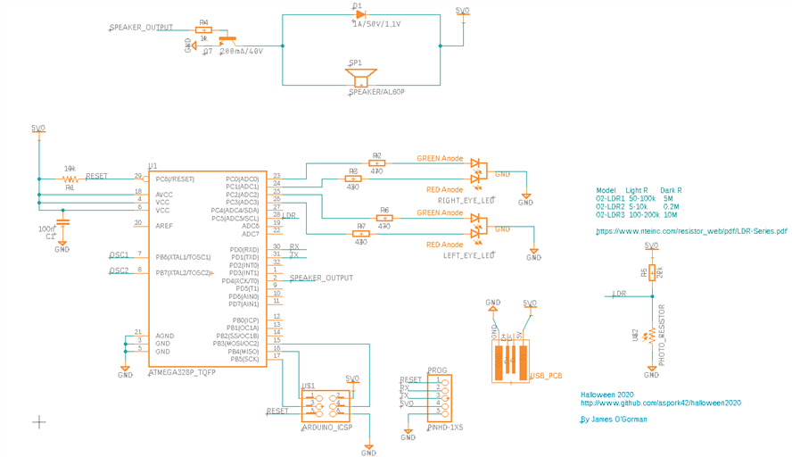

Arduino on a breadboard
To help keep BOM cost down, and since it isn't really required, I opted to run the ATMEGA 328p using its internal 8 MHz oscillator instead of an external crystal. This needs a custom bootloader called something to the effect of "Arduino on a breadboard." Then I can eliminate the crystal, two caps, and two resistors. Buying raw chips would already require uploading a bootloader to make them "Arduino-compatible" so having to do this step is required either way.
More custom components
I'm building up my custom component library in Fusion. I had to add a custom Red/Green LED since I got these special to use for the eyes. Green means happy (aka mask-ON). They turn red when the mask is removed and BLINK in ANGER! I added a piezo buzzer to play some 'doom and gloom' notes as best as an Atmega 328P Arduino can muster. I've added programming headers for ICSP (bootloader) and regular sketch uploading. I did a recent project for my 10 year anniversary that was somewhat similar and totally forgot to add these. This project uses the 328P-AU which is the QFP version of the chip instead of the DIP-28. So it makes doing bodge-wires that much more difficult; and they would be clearly visible since this project is a hand-held one for kids (no enclosure). I additionally had to create my own component for an LDR (light-dependent resistor aka photo-resistor) since there wasn't one available in the canned libraries that matched mine. I generated my own 3D model and linked it. Once final element was the routed holes for the 3D printed mask. I created these by editing the sketch in Fusion 360 for the board and adding them as an outline.image
I'm always nervous to add custom components since if they don't line up or the pinout is wrong, it is hard to correct a PCB. I try to safeguard this by printing out on paper or on my 3D printer the board itself, then install the components to check fitment. I think that the USBPCB is the biggest risk of this round of custom components...
Notes about the board / PCB Options
One thing I ran into on this was that using ENIG, 2.0mm thickness, and white soldermask; all add time and cost to production. Since they are all required to make this work, I had to spec them in. Each one added about $20 to the bill. I also wasn't sure exactly how many to make; but targeting 30. On the website for JLCPCB, the quantity breaks are at 30 and 50; with nothing in-between. I was worried about ordering 30 and needing 31; but figured out that my combination of board size, thickness, and finishing options, the 50 QTY was actually /cheaper/ than the 30. It seemed to cross over from 'prototype' quantity into 'small batch' according to them. So I went ahead and got 50... this is easily the largest board order I've done so far - over $100 image. (Note: I work in the automation industry and regularly handle single components worth over $4,000 and machines and systems in the $60,000-$200,000 range; so $100 is peanuts, but it is different here since I'm personally footing the bill...)image

  1. Don't put any text over vias! The silkscreen doesn't print there.
  2. Double/triple check pinouts! I got caught out with testing the DIP28 on a breadboard, but ordering a QFP package. The output that I used for the speaker uses a different physical pin number. The schematic was correct, but my Arduino sketch was using the wrong pin #.

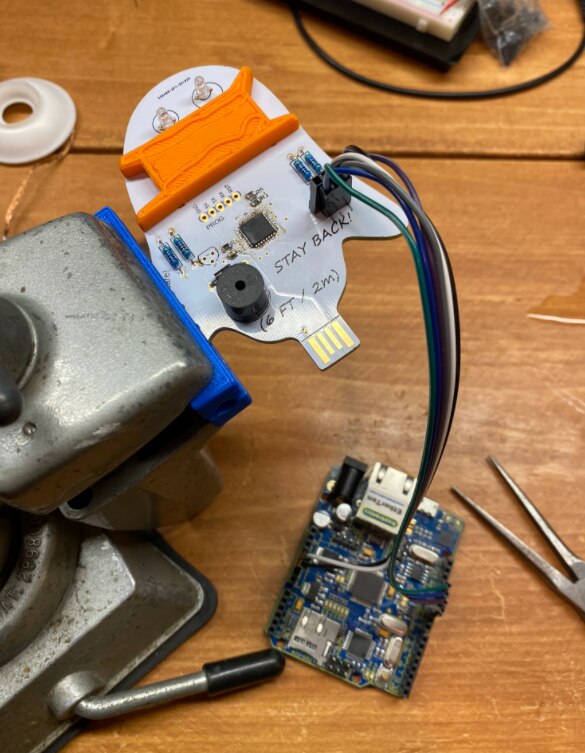

This image shows programming the bootloader using ICSP pins. There is a second 5-pin header that I used to upload the sketches. I just used unpopulated holes to create the headers, and use jumper wires. This means less soldering on each board and fewer components.

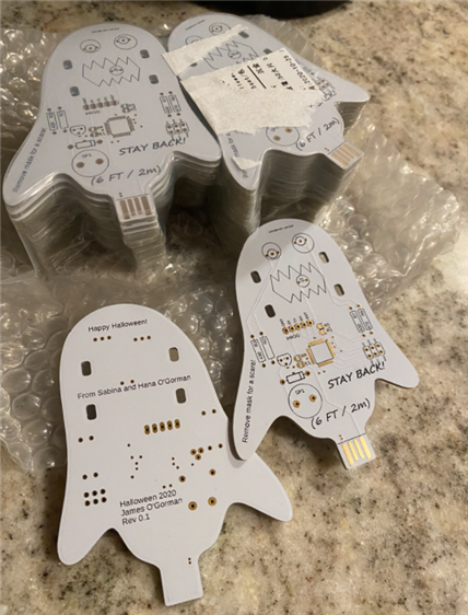

Doing the build
I ordered 50 boards, but only 40 microcontrollers; so I'll be building up 40 units. I need 32 for my daughter's class, so I'll have 8 extra to give away (or otherwise have spares if some don't work and can't be repaired). The boards were delayed in shipment, and manufacturing took a few extra days. That meant I only had time to complete building about 5 to have on Halloween. That's fine because daycare is closed for another week and I'll have time to get the rest done by then.image

    And - I got the last five up and running! Glad I got the first batch finished. The went and were delivered to my kid’s 4K class on Wed for their first day back (And itheir Halloween party!) since being shut down as a classroom for Covid; only for the district to shut down ALL in person classes through the end of November.
    The issue was that I could upload the boot loader on these five boards, but couldn’t program the via serial with a sketch. Tonight I went through and re-checked bootloading, checked for shorts, bad solder joints and solder balls and couldn’t find any obvious issues. After looking up the error code, I realized that I can program the chip over the ICSP header and don’t actually need the serial port header. I went that route and they all worked right away!
    Testing them, I noticed that the five boards actually power up immediately without a 1.5 second delay. All the other boards have a delay. So the boot loader I’m using must not be setting all the required fuses. These five chips are skipping the startup delay and don’t ack the programmer to accept a new program. The ICSP header works differently and this isn’t an issue. So I now have 100% working fleet of scary ghosts! Perhaps I’ll investigate that later, but they’re working now image

    OK- I have 35 completed! Powered up and running! Two are already delivered; and here are 33 more. This leaves five to go, which are assembled but wouldn't take the program. I only required 31 finished units, so I can troubleshoot the rest later. Phew! This was a marathon!
