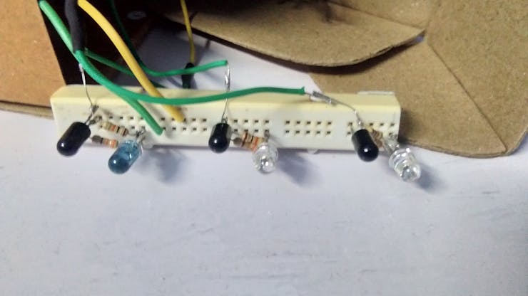

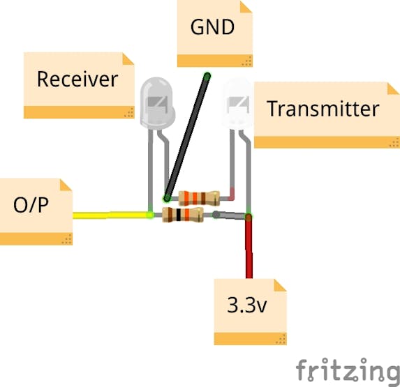

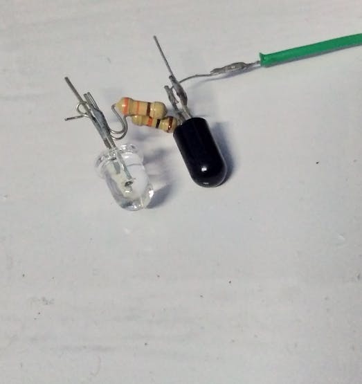

Now, lets start with making the IR sensor for our project. I have made a simple IR sensor which can produce analog output. So, the output of the sensor will be given as input to our Arduino MKR wifi 1010's Analog pin's. The circuit diagram is given below.
Be Careful! while soldering the components. If you don't have experience in soldering components, ask someone who has experience in it to do the job to avoid problems with solder!
And after soldering the components, our simple IR sensor looks like this !
Great ! We have made our simple IR sensor, and don't forget to make 3 sensors since we'll be using three sensors in this project.I've cut the unwanted terminals except the Vcc, GND and Signal pin. After making 3 sensors, just place it in a piece of bread board like this:

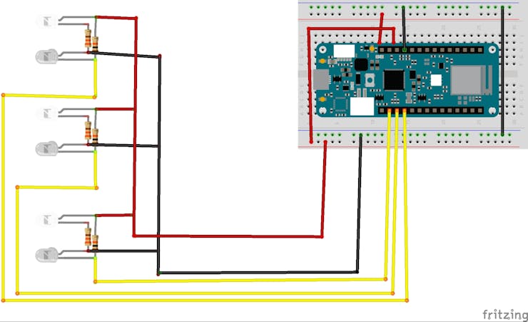

Let's build our Protector's indoor unit ! Start it by connecting the IR sensors to theMKR wifi 1010. The circuit diagram for connecting the IR sensors to MKR wifi 1010 is given below.

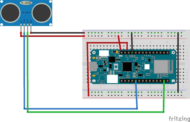

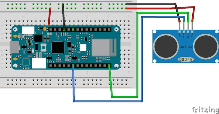

Once the connections are made properly, attach the Ultrasonic sensor to the MKR wifi 1010. The connection is as follows:

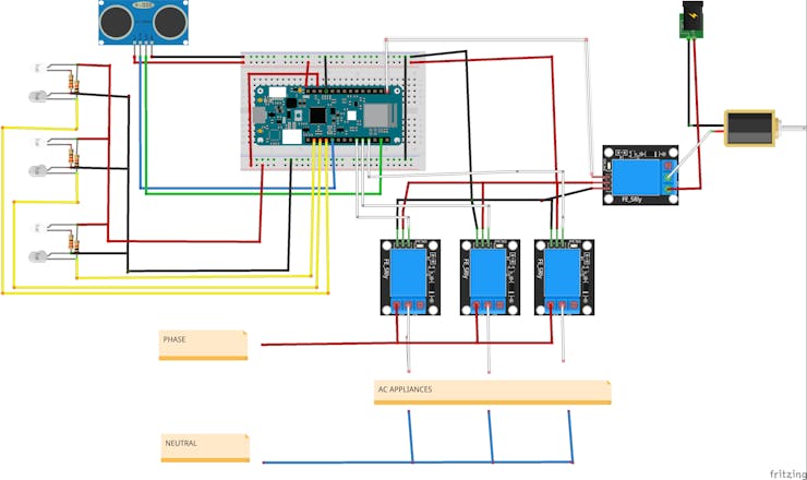

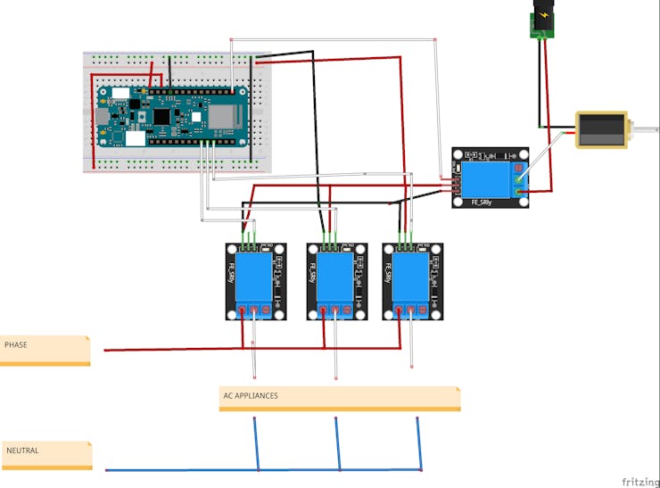

Okay! Now let's connect the relay modules to the MKR wifi 1010. The connections are given below:
Great! We've completed building the circuit for our inner unit. Finally the inner unit circuit looks like this:

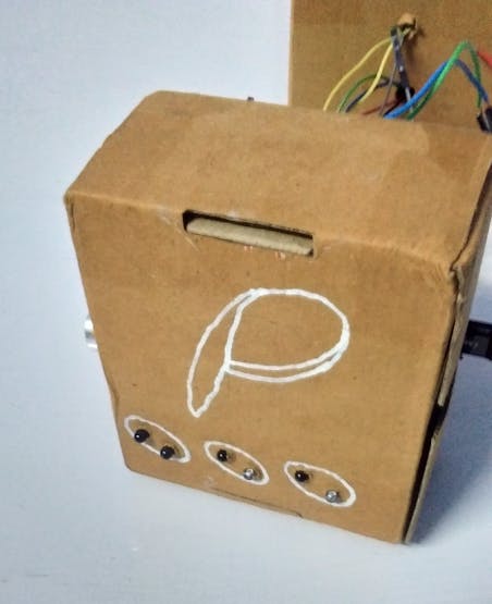

Cool! We've completed the inner unit circuit. Now, We need a casing inorder to make our setup loop good by hiding the messy wiring inside the case. I've made a simple casing using a cardboard box.
The above picture is the inner unit which I've made.You can also 3D print the casing according to your need.

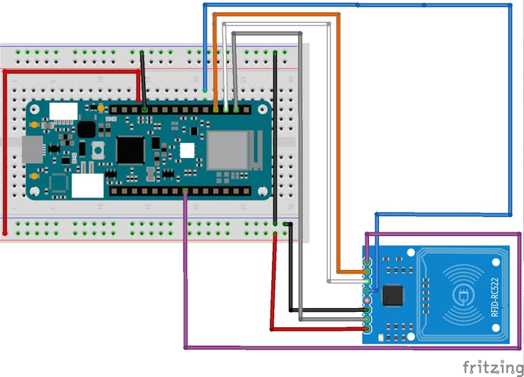

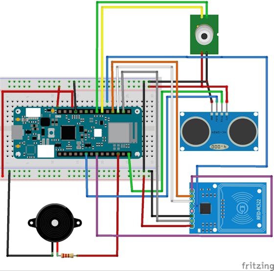

Now, Let's build our Outer unit! Remember the outer unit consists only of an RFID reader, Ultrasonic sensor, and MLX90614 temperature sensor. Connect the RFID reader from the outer unit to inner unit the circuit diagram is as follows:

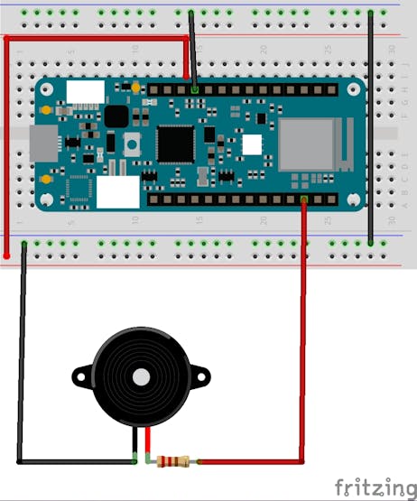

Okay! now let's connect the ultrasonic sensor and buzzer to the MKR wifi 1010. The connections are given below:

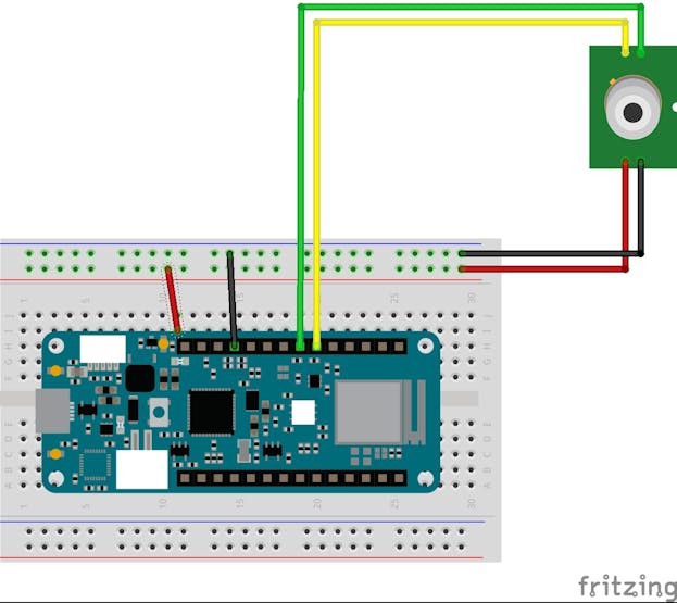

Great ! now let's connect the MLX90614 Temperature sensor to the system.
The entire outer unit circuit diagram is given below:

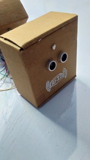

Now, We also need a casing for the outer unit. I used a cardboard box for the outer unit also. Just have a look at it.

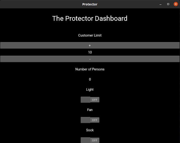

Remember the virtual environment should be in activated state and the Arduino MKR wifi 1010 should be powered up before proceeding the above command, else the app will not start ! Now You can see the dashboard of the protector ! The dashboard looks like this:

- The Protector checks the person entering into a shop or other place when a person comes near the outer unit and if the temperature found to be lesser than the reference temperature and the number of persons inside is lesser than the limit, the device opens the door and allows the person.
 - The owner of the shop or officials of a place can enter into the shop or place with the help of RFID tag.
 - The inner unit is responsible for controling the appliances with the help of IR sensor.
 - The owner of the shop can access the device using The Protector app in his/her smartphone.
 - Also the ultrasonic sensor in the inner unit allows the person to unlock the door by just waving their hand near the sensor of inner unit.
