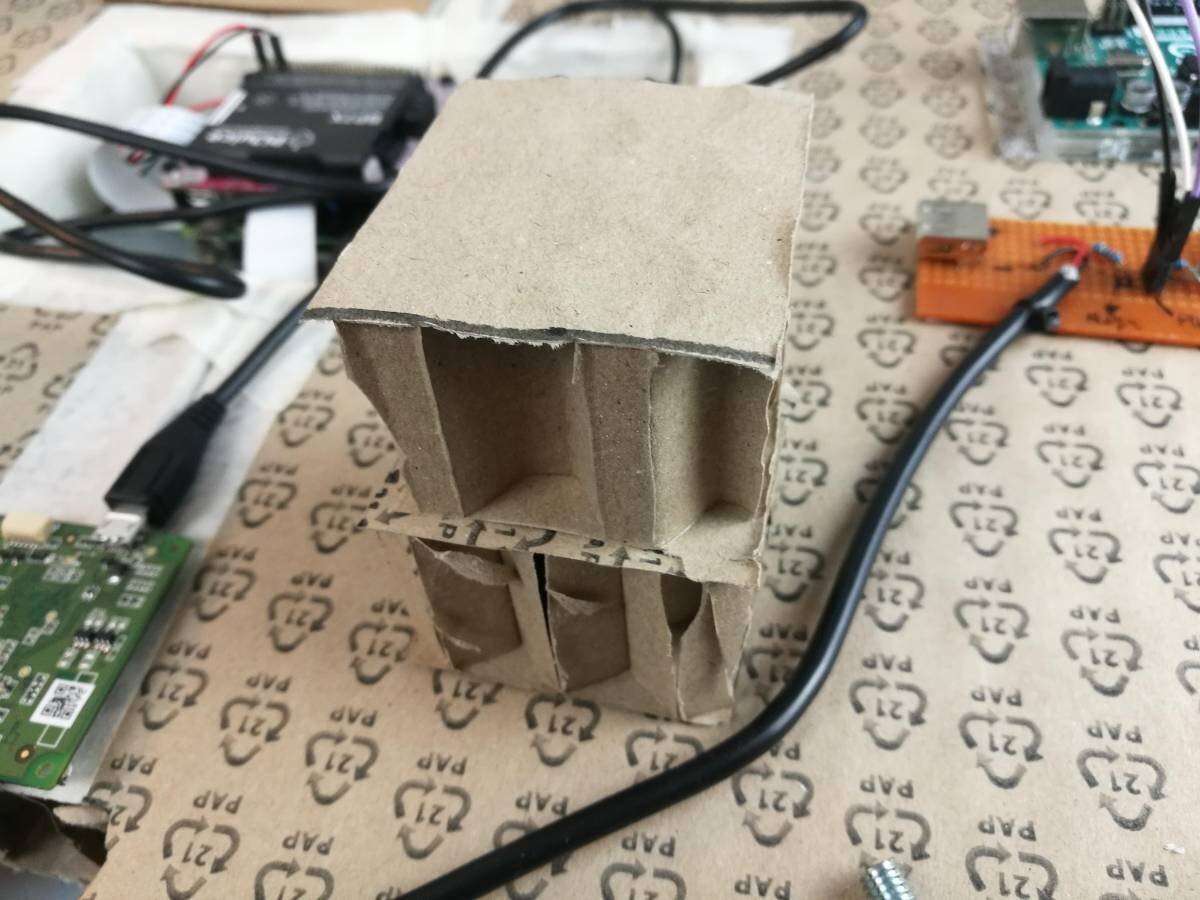

Before coding I have completed the setting of the mirror to put it in the right position adding some more robustness to the structure.
Finishing the Structure

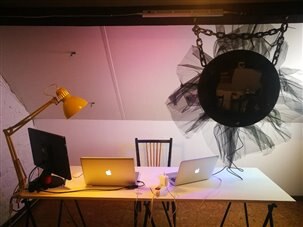

The mirror will be placed in vertical position, maybe en plain-air or against a wall. I have added four bolts on the back of the frame to keep the internal body stable in place; then I glued four cardboard blocks to protect the wires and connections keeping the back of the mirror about 10 cm away from the wall to easy the air circulation and avoid the Pl3 B+ become too hot.
Last, another couple of holes at the same distance from the top middle of the frame to fix the chain (an original, metal-like scary chain) to hang the mirror.
