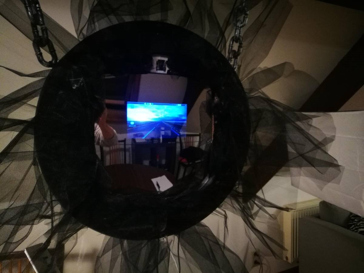

The last refining to the mirror frame that in my opinion contribute giving a touch of mystery to the mirror has been gluing around the (black) frame an "expansion" of black tulle fabric.
