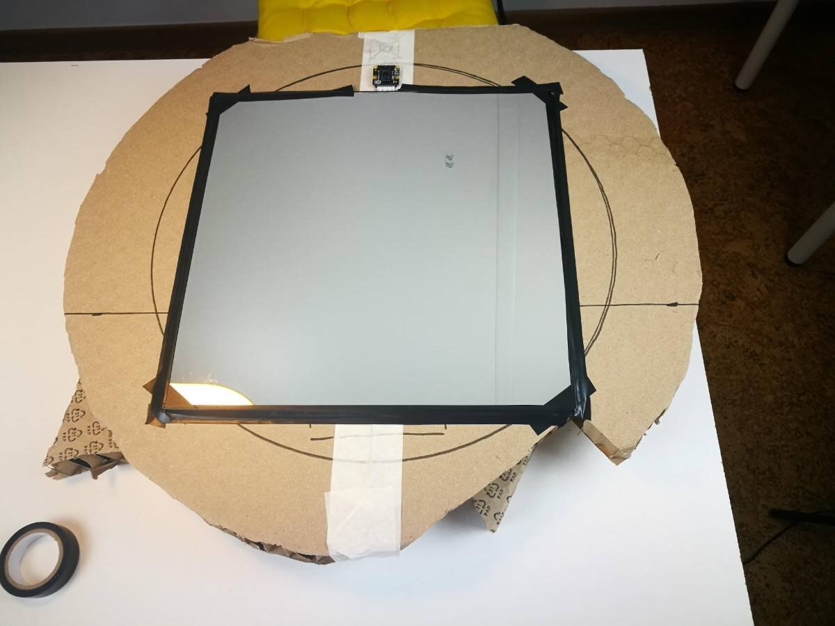

The One-way Mirror
A one-way mirror, also called two-way mirror (or two-way glass, half-silvered mirror, and semi-transparent mirror), is a reciprocal mirror that is partially reflective and partially transparent. The perception of one-way transmission is achieved when one side of the mirror is brightly lit and the other side is dark. This allows viewing from the darkened side, but not vice versa. (https://en.wikipedia.org/wiki/One-way_mirror )
Magic Mirrors use semi-transparent mirror plates, that make possible to see something lying to the back of the reflecting side together with the reflection of the front scene. The "magic" effect is achieved by showing lighten texts, graphics, light effects on a screen, videos etc. The best effect is achieved when the entire backside and screen are black, thus avoiding the visualization of the borders.
The idea is to put a screen on the back side of the one-way mirror showing a black background. A microcontroller, an embedded computer, a desktop or a laptop connected to the screen can show any kind of information, including interactive features with the user through gestures or sensors.

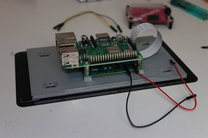

The Electronic Components
The electronic parts used to build the Scary Mirror aims giving something "special" to the making.
- Raspberry PI3 B+
- PI Camera V. 2
- PI Juice power supply board for the raspberry PI
- Touch LCD 7" screen for the Raspberry PI
- Arduino MKR1000
- A couple of PIR motion detection sensors
- Omron vision system
Wiring, cables and some other stuff we will see in detail during the building phase. The images below show the components ready to become scary.

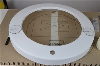

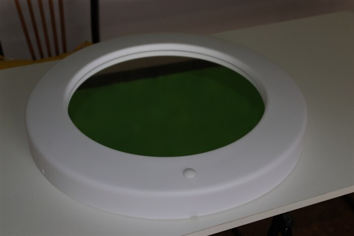

The Frame
The mirror frame has been obtained hacking an IKEA Mirror from which I removed the lighting content to host the new structure obtained by a thick block of cardboard.

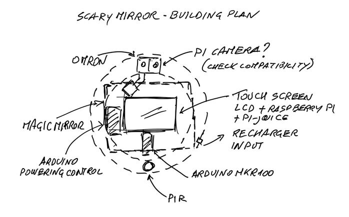

The Project Design
The above image shows the scheme of the project design and the distribution of the parts inside the mirror body. This first version of the design has been updated a while but the scheme parts remained almost the same.
In the next episode, we will see in detail the assembly of the electronics inside the frame and starting wiring the component, with an extra bonus: an update I have done to the design while starting to build the project.
